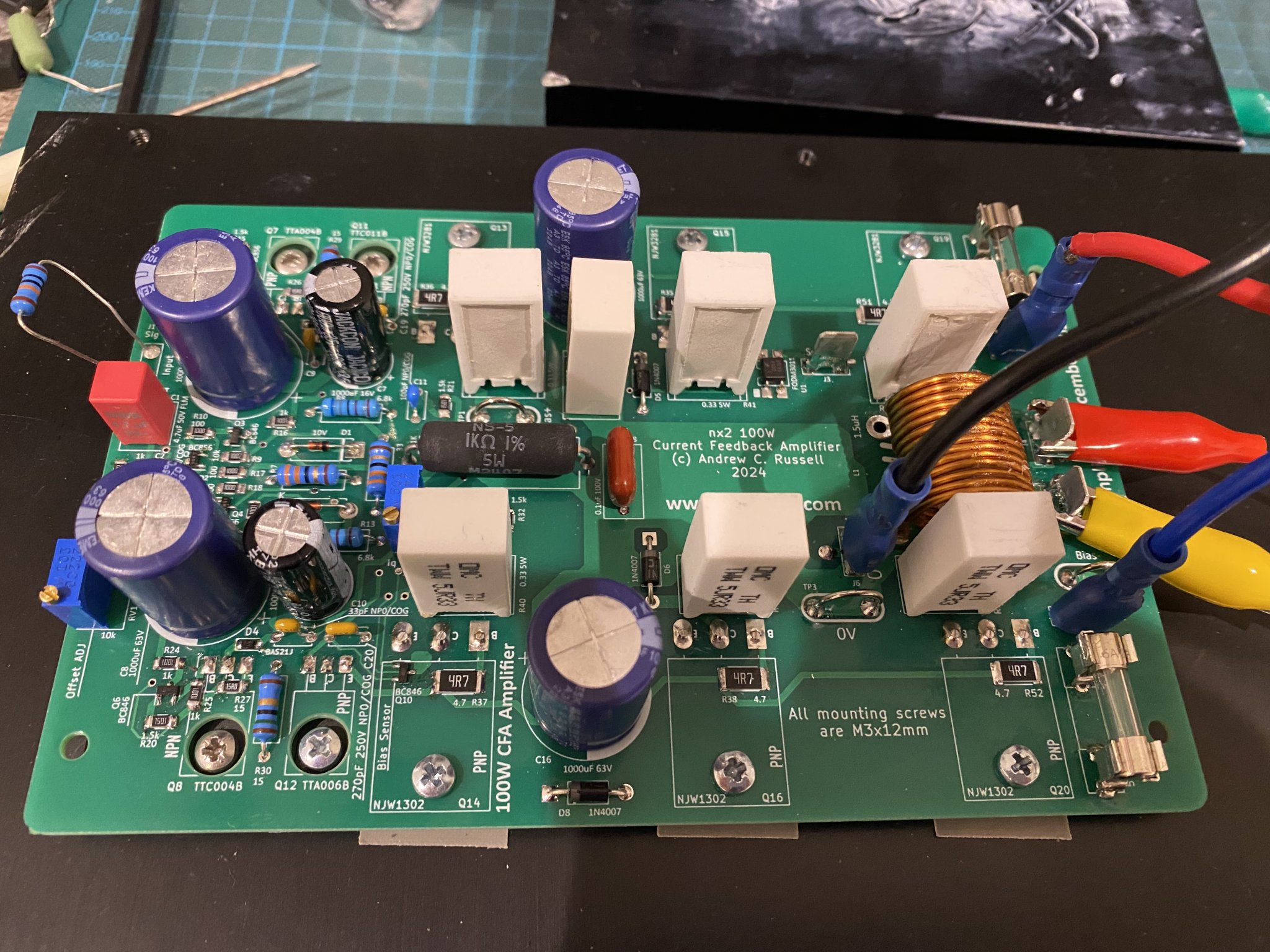

I'm putting this up as a place holder for the new nx2-Amplifier (hereinafter just called the 'nx2') which has been in gestation for some 15 months now. I've had quite a few nudges from various people via email asking about progress. I can understand that some folks have fallen into believing the nx2 is 'vapourware' (if you've worked in semiconductors or software product development, you'll now what that means!).
I started work on this in September 2023, assembled the initial proto and decided it needed more refinement - details which I will cover when the documentation is released. However, things came to a grinding halt when TraxMaker (part of the CircuitMaker CAD suite) stopped working in early 2024. I made the decision to switch to KiCAD (a good move!) and had to redesign the board from scratch. After another 2 proto/dev cycles, the amplifier module PCBs are finally where I want them to be, and quick bench testing shows peak mains hum harmonic components at below -125 dBr reference 60W RMS into 8 Ohms (the power limit of my test lash-up) and <35ppm distortion.
I am currently finalising the PSU +inrush PCB and that will go off for manufacture sometime next week. In parallel with this, the mechanical layout is also being finalised.

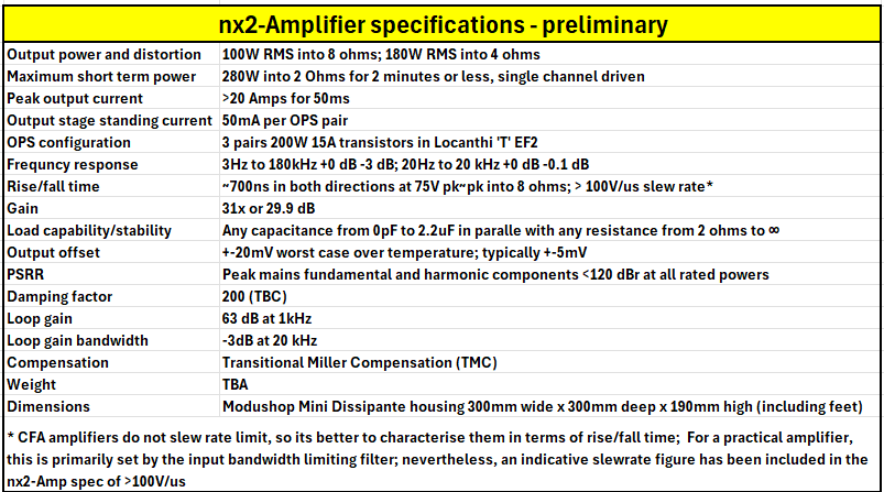

Here are the specs (note these may change once the completed, housed amplifier is re-measured)

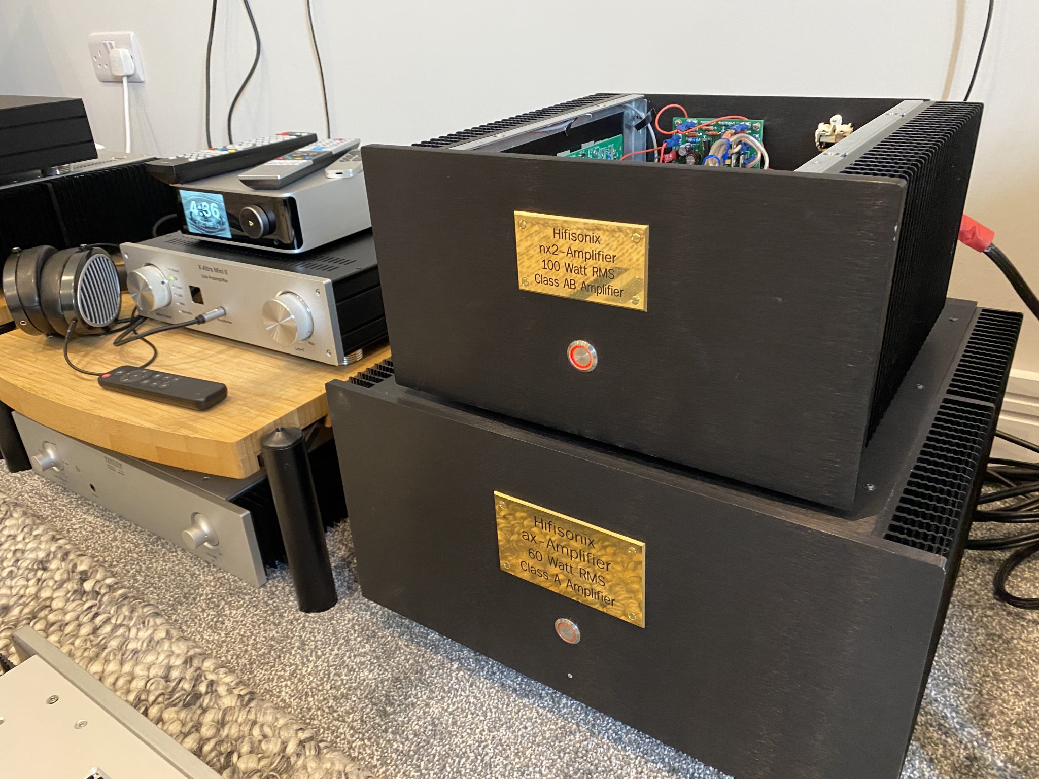

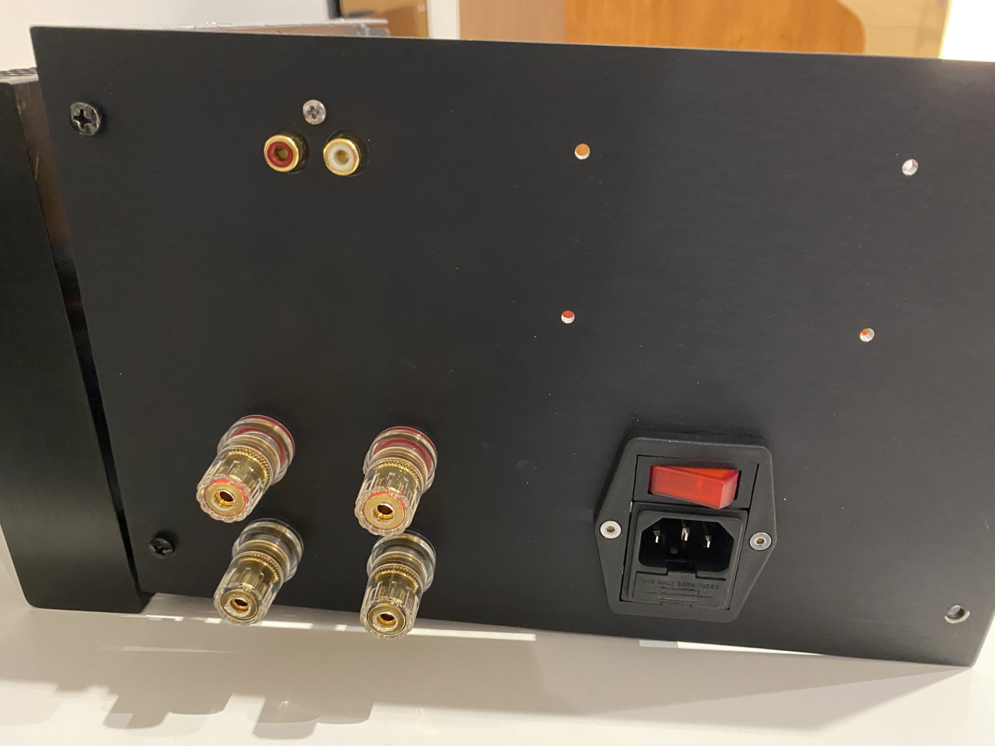

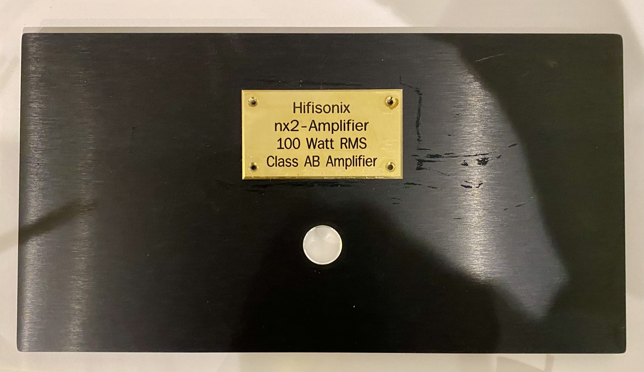

I've attached some photos below - taken in my workshop today in amongst the packing boxes. (note the front plate is still being assembled so looks a bit manky - it still has to be cleaned, screws fitted and then polished)

63dB Loop gain at 1K is pretty conservative for TMC. I usually get similar figures with single pole compensation.
It might be some compromise made for the 2.2uf capacity load.
Have you ever encountered such capacitive load in real live? Usually, I don’t verify beyond 0.1uf.

I’m sure this will be a nice update to a strong design. I’ll be interested in whether you’ve kept the simple current limiter approach or gone for a SOA VI detector to feed the SSR module.
The nx2 is a CFA - the loop gains are generally lower than blameless type VFAs.
A worst case load I usually cater for is an electrostatic which usually lie between 1uF and 3uF worst case load. I agree most conventional speakers are nowhere near this.
