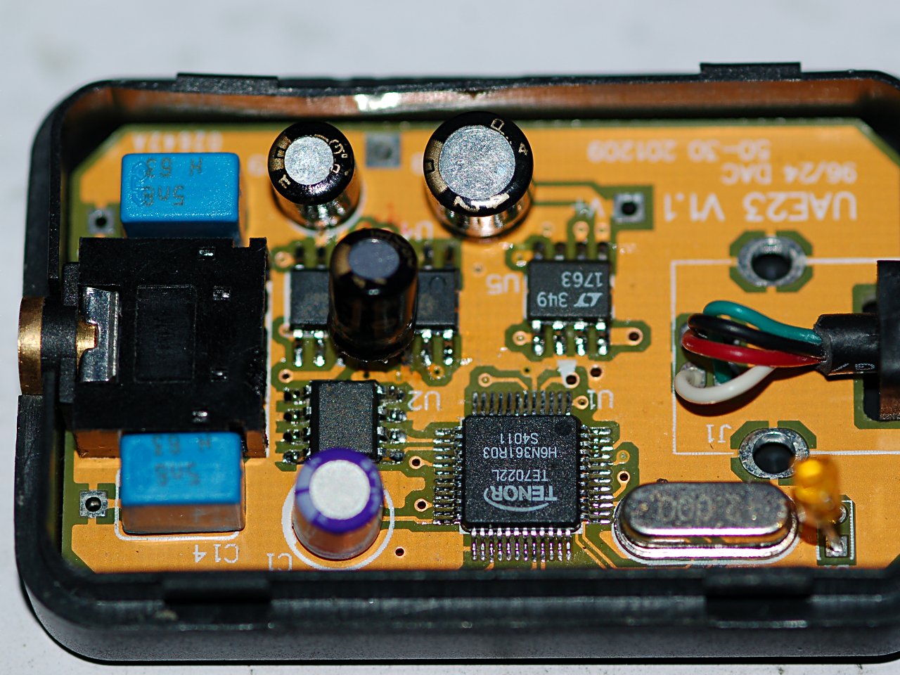

If you can solder SMD then try 100K-130K ? 0603 ? SMD R on the vacant pins on the the PCB that go to ES9023 pin#6 to GND. I used 100K, love it!!
Thanks for the tip - I have the following mods on a UAE23 v1.1, and it certainly seems to tame the harshness that some people observe:
1. 120k to ground on R3.
2. C8 changed from 10uF/10V Oscon to 220uF/4V Black Gate PK (this is the LT1763 3.6V regulator output bypass).
3. C9 changed from 10uF/10V Oscon to 4.7uF/50V Black Gate PK (this is the bypass on Pin 6 of ES9023).
4. Added 4.7uF/50V Black Gate PK directly soldered on Pin 11 (NEG) to pin 14 (DGND) of ES9023. It's too difficult to solder it on adjacent pins 11 & 12 (AGND), so I used pin 14 instead - it's grounded at the same ground plane as pin 12, just a few mm away. Pay attention to polarity - the negative terminal of the capacitor goes to Pin 11.
5. Bypassed C10 and C11 (both 1uF) on the underside with 0805 47nF/50V X7R. Not really necessary if both C10 and C11 are X7R, but just insurance in case they're Y5V or similar. There may be some benefit in using SMD PPS caps like Panasonic ECHU to bypass these, but they tend to be larger, typically 1206 or more in useful values like 47 nF and 100 nF, so I stayed with X7R.
6. Changed C13 and C14 from 6.8nF Wima FKP2 to 5.6nF/63V ERO KP1837. Not really necessary IMHO - but some on the Subbu DAC and other threads have recommended lowering it to 4.7nF or even lower. 5.6nF is a reasonable compromise which sounds fine.
Overall, the mods get rid of most of the harshness/brittleness without losing micro-detail. There's also more air and cohesiveness, and it's now good enough to be my primary reference DAC.
The modded UAE23 was auditioned yesterday in a fairly serious audiophile setup, driving a Dared VP-845 integated SET tube amp, driving a pair of Cadence Arista floorstanders with electrostatic tweeters. I used Rhythmbox on a notebook to play .flac and .m4a hi-res as well as CD-quality 16/44.1 tracks through the UAE23. The other DACs in the fray were an ODAC (also ES9023-based), a tube-buffered TDA1541A DAC, and a Feixiang FX-98s PCM2704 DAC.
On the CD-quality tracks, the tube-buffered TDA1541A held its own. However, on any of the 24/96 tracks, both the ES9023-based DACs (the UAE23 and the ODAC) easily trumped the others on dynamics, headroom, detail, separation, sound-stage - practically any audible yardstick.
Overall, the modded UAE23 was darker and smoother than the stock ODAC, but the ODAC had a bit more micro-detail and air. I preferred the modded UAE23 on overall presentation as well as (possibly) lower fatigue, as compared to the stock ODAC, but individual tastes may vary.
