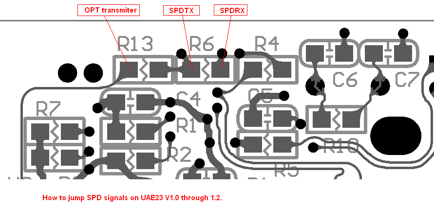

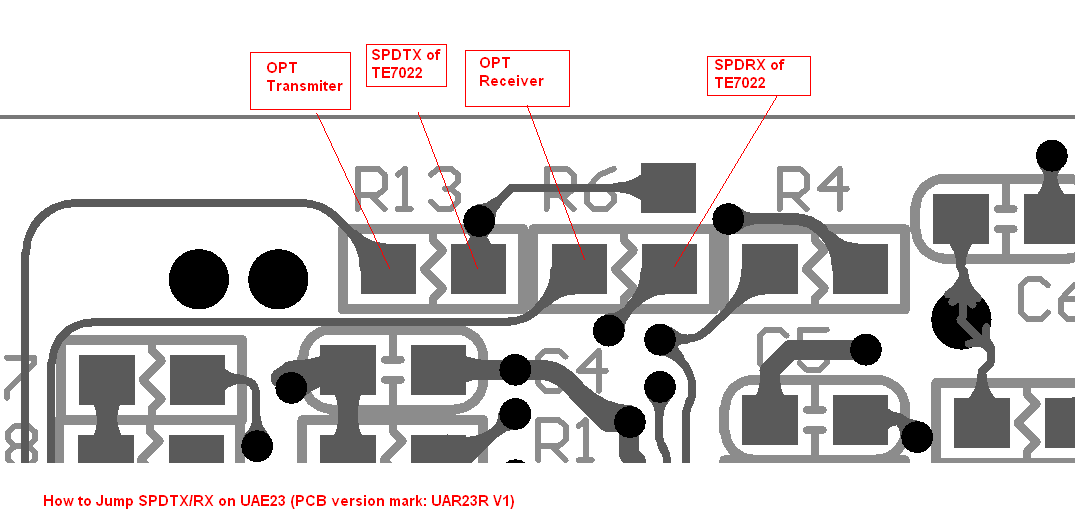

Where can I get this special version ? SPDIF to USB is exactly what I´m
looking for. The hifimediy.com website states "Optical input to USB" but
where would the optical input be ? Can´t see it on the photos provided.
HiFimeDIY Sabre USB DAC. 96khz/24bit - ES9023+TE7022 + USB to optical converter
-Usb to optical converter. Outputs optical signal if you connect a 3.5mm optical cable in place of a 3.5mm audio cable. Can be useful for connecting your computer to another DAC without usb input.
-Optical input to USB. - This can be used to record a digital optical signal on your computer through USB. Note that the optical input signal can not be routed to audio (analog) out on this DAC.
The allusion to optical input may have been a slight mistake; the TE7022 can take the input but I think the standard UAE23 OUTputs optical, not like the outdated picture on the site, but right behind the upgraded UAE23 3.5mm "Walkman" port is a red LED emitter -- being only a 2-lead device I doubt the stock vanilla UAE23 could input SPDIF from the optical arrangement it has. They MAY have input circuitry hiding in there they can mod for special customers. My guess.
enjoybiking, you are correct:
I asked HiFimeDIY directly and got this answer:
"we discovered that we had to chose one, either optical in or optical out. We decided to stay with only optical out, as that can be useful to most customers. I have updated /removed the reference to optical in, but as we have this listed on several sites, there might some places where this information is still present. I apologize for any misinformation about this."
So it seems there is no optical in -> USB.

To be fair I think that a optical in would be much more useful. There are a lot of cheap dvd/bluray player with awful dac converter and optical output
Toslink to USB
The USB receiver IC WILL accept a SPDIF stream and send it to the PC, but you would have to modify things. I have never done this.
http://www.gfec.com.tw/c/document_l...198-3aae-4cb6-801d-3489fd0804cd&groupId=19499
is the TE7022L datasheet location.

Hi, about SPDIF direction, I talked to Steinar before and we think that optical output may be more useful (to output non-audio signal like AC3). But our pcb design also include pads for optical input sensor. So if you need a OPT to PC version, we also can specially make some (use input sensor instead of red LED). Please just contact Steinar on hifimediy.com for order.
There ARE quite a few people who need a way to get old MD and DAT audio back into the PC [I am just commenting not arm-twisting, hah, I do plenty of that too]. I suspect one could couple copper SPDIF to that pin [pad] with a transformer, or, Lampizator-style: 75ohm resistor to center of coax to a DIY SPDIF-IN RCA? Possibly easier with UAE23+ if it too has artwork to TE7022L pin 33. I have a UAE23 in a metal box, easy for ME -- but no need. Now with a bit of creative soldering you CAN have the optical OUT working same time as feeding two RCA audio jacks left/right audio, with the DAC just about stock.
