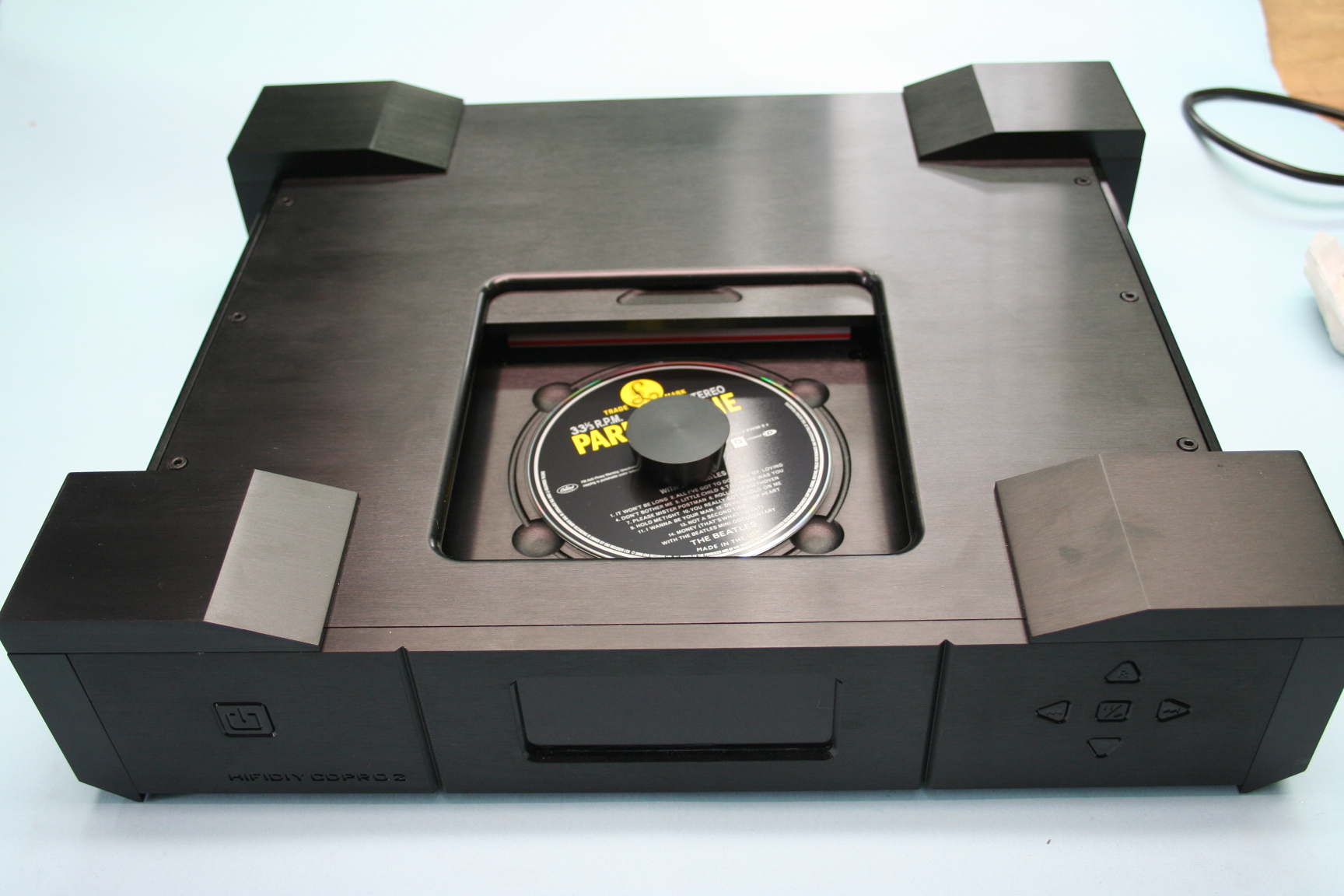

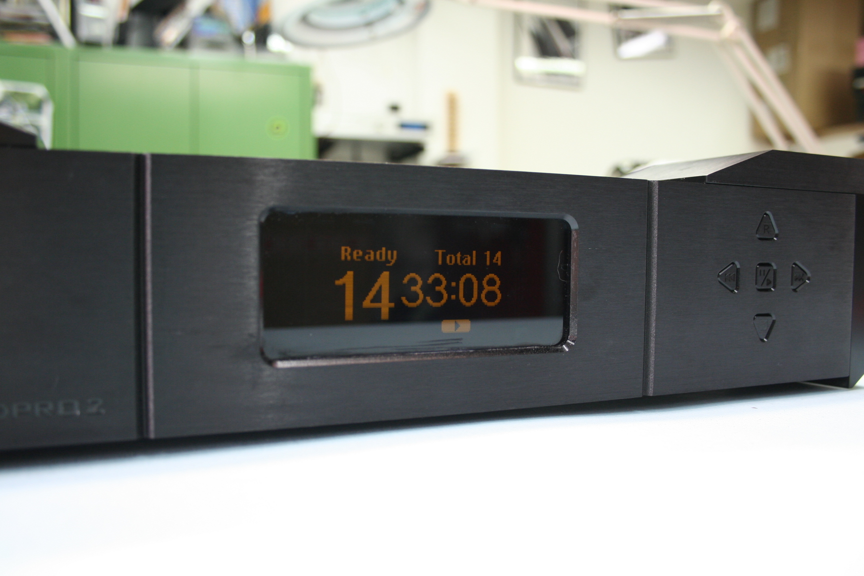

I have assembled the the big CD pro from HIFIDIY. Fairly straightaway to put together, only the sliding door needed some massaging, because the rail where the nylon bar slides along was not deep enough. Had to make myself smaller barr out of Teflon, and now it is ok.
I am stuck with the modding of the CD 2 pro, where only one picture with some chinese text is all there is to explain it. Her is the picture. can someone explain what ist says?
I presume that the three yellow rings mean that these elements have to be removed, but I want to be sure before taking an irreversible step.
Here is the picture I am talking about.
Anyone understanding chinese to translate?

Hello, this is Candy from HIFIDIY, thanks for that, yes, it means:
remove the three yellow rings, then remove the black part of the crystal, then remove the middle parts of the crystal.

I did build the HIFIDIY Big CDpro2 transport and it is working flawlessly. I like the looks and the big dial which you can see across the room.
The supplied parts are first class and only require some mechanical fitting for the sliding cover and the mechanism magnetic base to get it to float absolutely free of any rubbing.
It was not difficult to put together and except for some errors on my side and some chinese translation problems, it all came out perfect and it is working to my 100% satisfaction.
What did not come out of the box perfect was the CDpro2 LF mechanism.
When installed in the player I noticed a lot of noise from the reading head due to wobble of the cd when it was playing, with the head tracking mechanism working itself crazy to follow the CD surface.
After checking with a comparator dial I saw that the platter was not running true.
I had to pry the platter off the motor axle and build a small fixture to fit it to a lathe.
It took some removing of plastic off the platter to make it run at right angle to the shaft hole and made it run as flat as I could, with only 0.01mm of wobble at the edge of the platter.
Fitted the platter to the motor axle (press fit, so a temporary stop had to be fabricated as not to overshoot and push the platter too far onto the shaft), rechecked with the comparator dial and from then on it is running very quiet and flat.
So if you are installing this Philips mechanism I would check that first.
I am outputting the I2S signal from the BigCDpro2 to my DDDAC with 60 paralell TDA1543 and a remote controllable attenuator using a LDR's . Feeding directly from the DAC to the 300B SET monos. So very little in the way between the analog output of the DAC and the power amplifier. No need for preamp.
Sounds very good.
