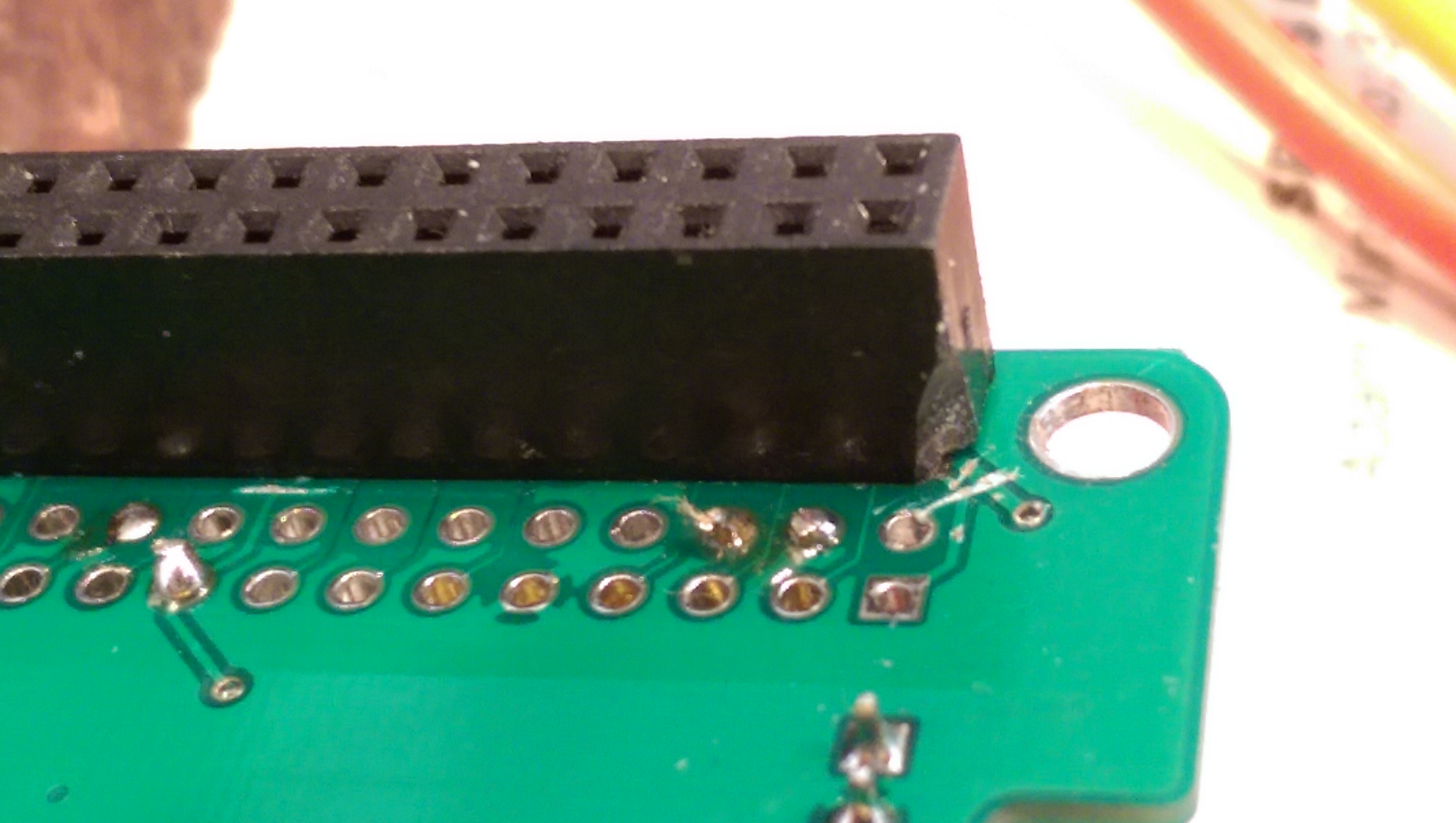

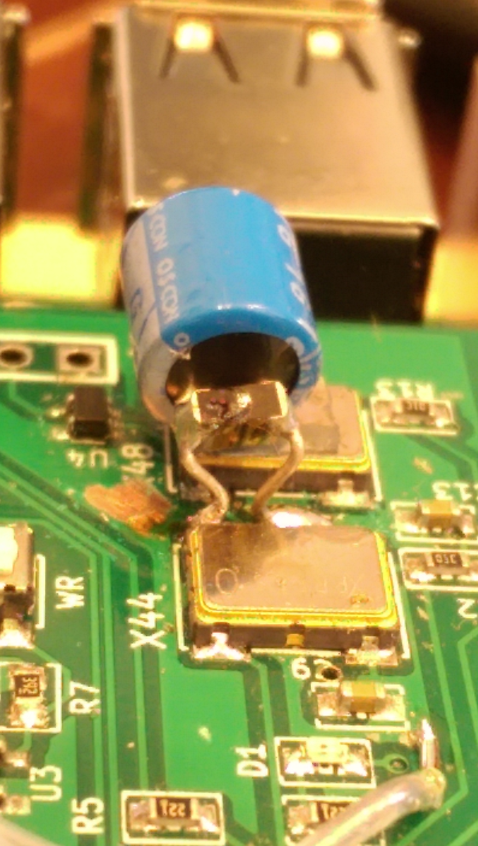

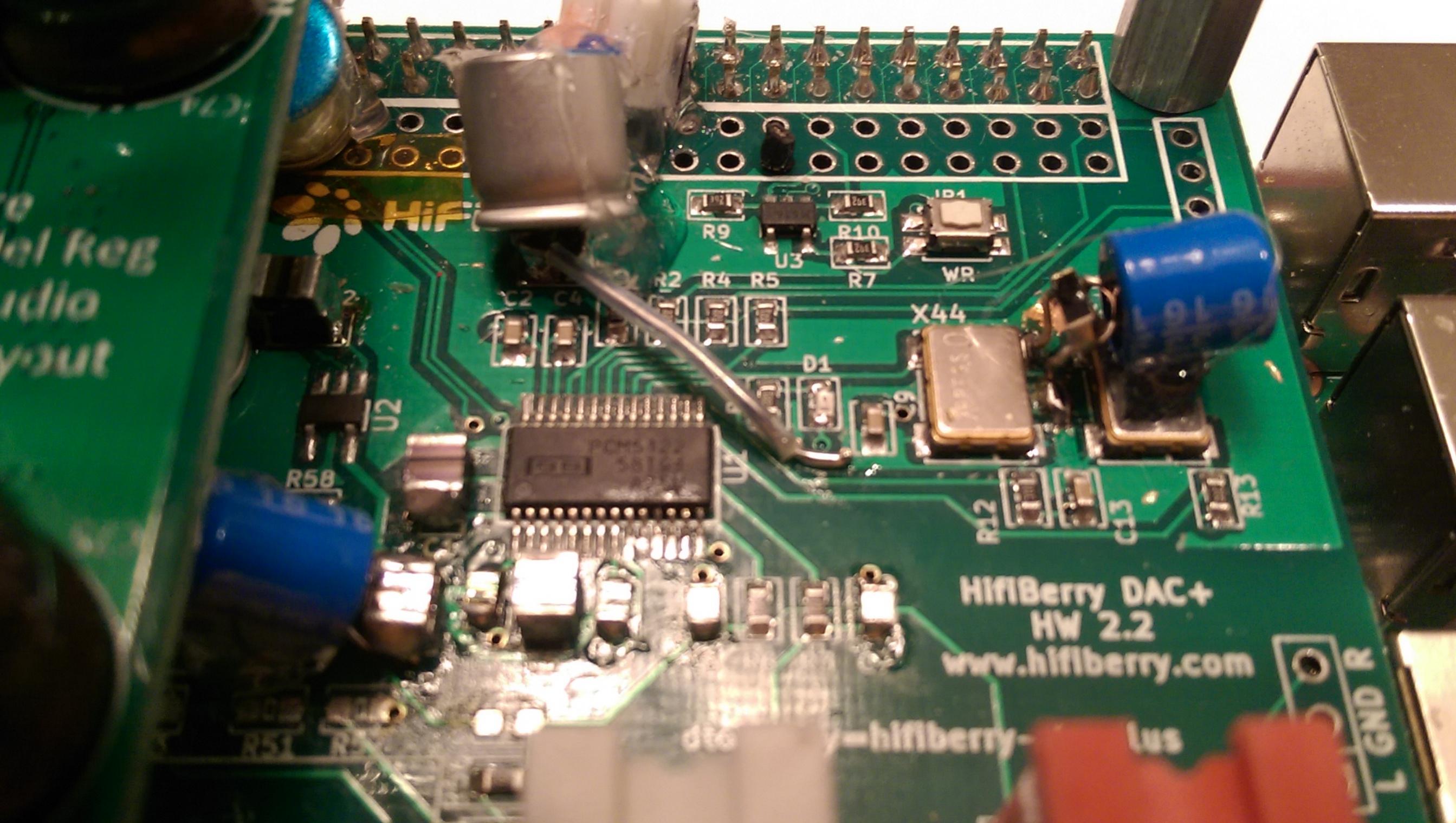

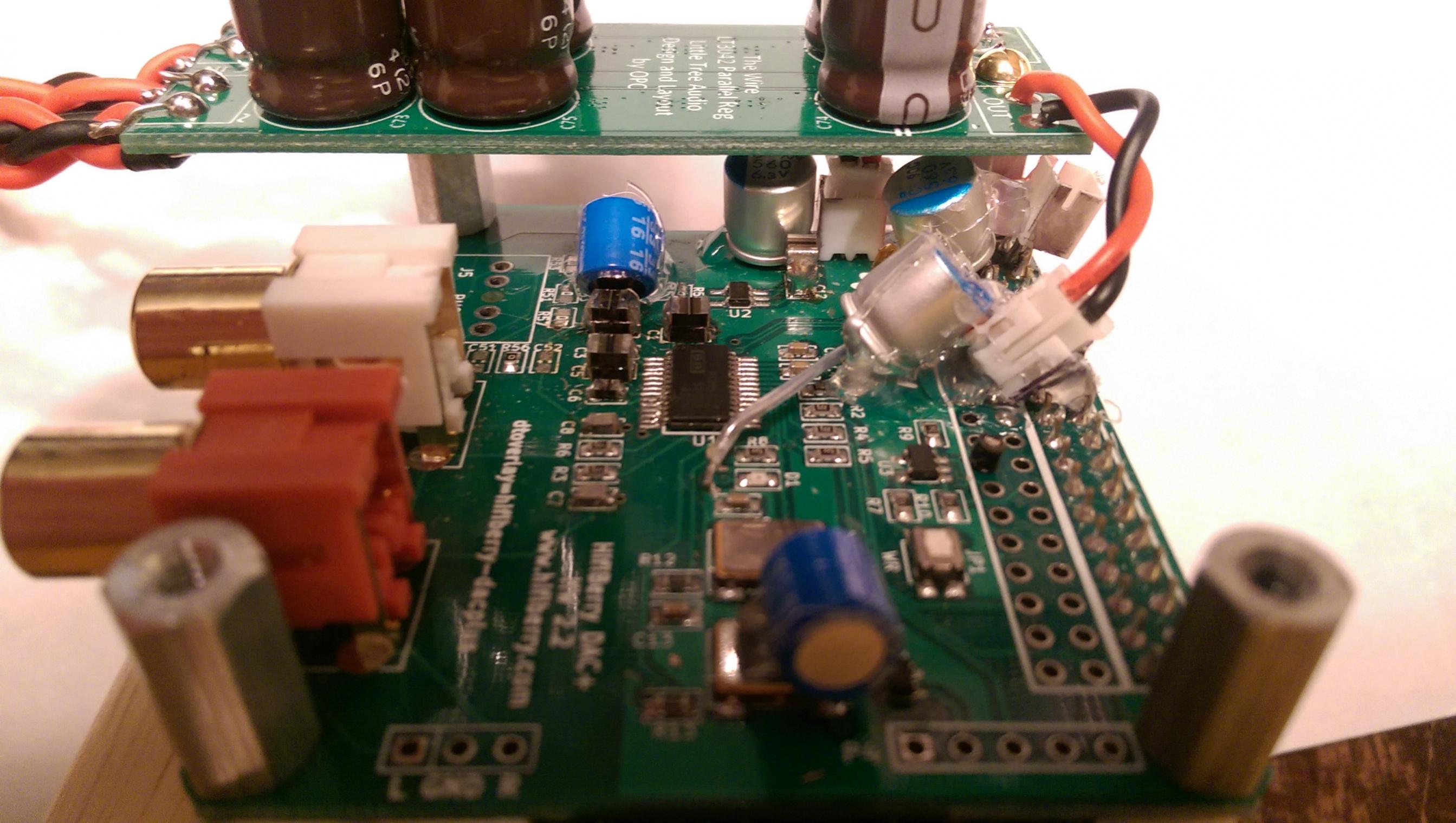

Some updates and answers...
First, @Soundcheck, on why I did not feed 3.3v direct from the reg to the AVDD, I am concerned about the additional wire and trace length that will add. My experience has been that digital power is really path length critical and that would add over an inch to the path. I still may try it in the future, but my gut-feel is that keeping the on-board regulator there is probably a good idea.
Second, I let it burn-in more today and then tried an idea that occurred to me last night.... I mentioned earlier in the thread that I have separate clean and dirty AC paths in my setups. I went back and forth yesterday on plugging the Pi's PS into either side... both had some strengths, but I finally settled on it into the dirty side. But as I was shutting down the system last night I saw that I had another choice, on the clean side, but before the PS Audio P10 regenerator. AND after today's additional burn-in, I tried it there and it's the best location. That tells me I need to do better noise filtering on the dirty-side power supplies and their AC cords. But with it setup this way, it has gotten another good jump in quality. Nope, it doesn't challenge either of my Soekris DAM DAC setups or the highly modified/abused Sony HAP Z1-ES. But it is definitely giving the EVS-modified DVD player a run in many aspects, sounding very tuneful and bouncy with good separation between instruments/voices, but lacking a good bit of the inner detail and 'ambience' of the more sophisticated spread (remember, it started out as $45 add-on board!)
Here's some pix... and I put a couple more in OPC's Wire board thread in the Vendor's Bazaar section.
Next steps... first, give it a bunch of burn-in time. My experience with MLCC caps (most of the ceramics on the board) is that a couple of weeks of continuous running is a minimum. And do more noise-filtering on my LMS server and network setup on the dirty side. Then some SW and configuration tweaks and maybe some additional filtering caps, maybe some of the .33F caps Joe Rasmussen recommended in his recent Sigma-Delta DAC mod thread (after I confirm they won't break the regulators!). And if I still think it holds promise over time, I'll try feeding the clocks with another separate 3.3v and MAYBE direct 3.3v for the AVDD.
I'm not expecting to make a world-beater out of this inexpensive little DAC. But I am curious on where I can take it, given its humble, but actually pretty sophisticated beginnings!
Soundcheck, I'll be very curious on how it goes if you try the battery on the AVDD setup. See the 'Soekris DAM DAC' thread on the 'Tir Na HiFi' forum for some useful info on using LiFePo4 cells with gear such as this.
More after a few days of burn-in.

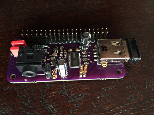

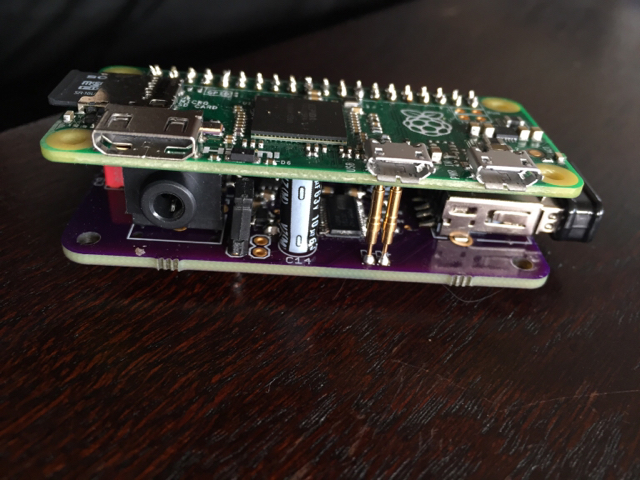

Rolled my own dac for the Zero. It uses two 3.3V regulators, has the option of powering the usb from the Zero, and the pcm5142 from an auxiliary input. Pogo pins work great for data transfer.
I used a modded mini2496 dac(ak4396) until now and the zero dac is just as good if not better!

On my adding bypasses, honestly I've only added 4 caps to the DAC card... a 560uf at the input of each separate supply (nothing special AFAIK on the value, just the largest capacity / smallest size I had in my boxes) AND the 33uf between the clocks. I added the other 33uf because I was replacing a 10uf MLCC with 3 stacked 1uf PPS caps and wanted to get up or above the original capacitor's value. Everything else were replacements, mostly replacing MLCC with PPS SMD film caps.
