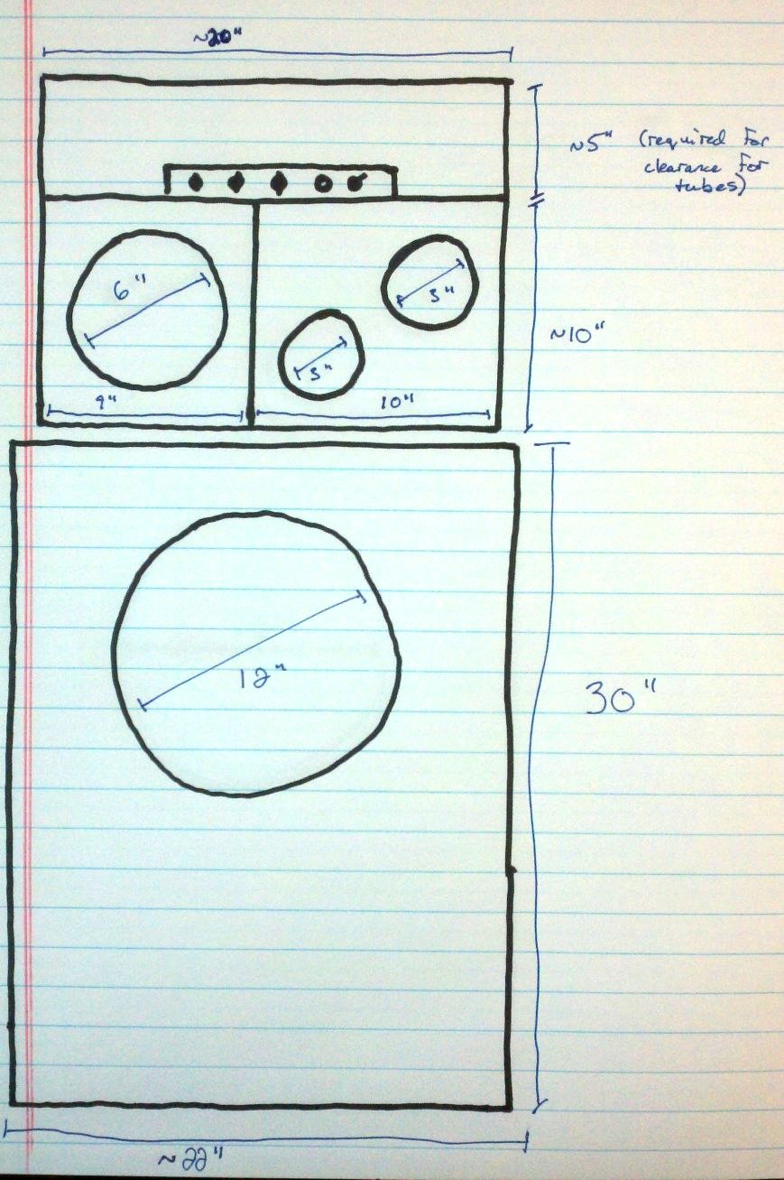

Yes it is much bigger than it needs to be to fit the speakers. This is not just to be an amp stack, it's going to be a piece of furniture and there are certain functional and aesthetic choices I'm making in addition to making a good guitar tone. The height of the cabinet will put the combo at a convenient height to reach the knobs. Also, when I'm sitting, it'll put the combo speakers at about ear level. The width will make it a couple inches wider than the combo. Depending on the size of the speakers I get, I may be able to shrink this dimension by a couple inches. I'm attaching a picture of my sort-of-to-scale drawing to give an idea of what I'm aiming for at this point.
I do understand that a baffle or frame member that is too long/large, may resonate sympathetically with the driver causing unappealing "boominess" at certain frequencies. If I run into this, I will add some bracing to damp that resonance.
If I really need to, I can always cut it apart and rebuild everything smaller. That's no big deal. I like tinkering.

That box size is massive for a 2x10 or 1x12, I you won't find any
drivers for guitar that would remotely need such a large box.
The picture should address this. The combo is actually going to contain two separate speaker enclosures. One for the original 6" speaker and one for the low sensitivity/low volume speaker/speakers. Each speaker compartment will have it's own back so I can experiment with different back panels for each side individually. I will be making it switchable between these two speaker configurations.Your combo also seems pointlessly massive, why ?
I think it's actually not optimized for 16 ohms. I'm not an expert on circuit design, but I saw this: Cool Information About The Vox AC4TV Series and the explanation therein made sense to me. I've also seen some anecdotes that support the idea.Your amplifier won't output 8 watts into 8 ohms, if its optimised for 16 ohms it will put out less into a 8 ohm speakers, say 3W.

Sorry, I shouldn't have said that. Yes there is no reason why your proposal
won't work as such, its just massively bigger than it needs to be. A series
inductor with a resistor in parallel will cut treble levels without completely
killing them, but your likely problem will be the lack of the "presence" band
boost built into most drivers for guitar.

a 16ohm resistor in parallel with the inductor would limit treble cut to ~ 6dB,
but doesn't the amp have a treble knob anyway ? presumably it works ?
I don't like the look of that goldwood at all, but that is me.
Aurasound NS3-194-16A 3" Paper Cone 16 ohm: Madisound Speaker Store
fits your criteria and you only need one.
One other issue is the amplifiers output impedance interacting with the driver Q.
Its possible this is the reason Vox went for 16ohm drivers rather than 8 ohms.
rgds, sreten.

Some further thought suggests the following :
Split the top of your cabinet into 3 enclosures (around 9" deep for the whole
thing, not 15" which is ridiculous) and install the 16 ohm 6.5", the 8 ohm 5"
I keep banging on about, and the 16 ohm 3" I recently posted.
If you can't beat them, join them, so add more options 😉.
Build it it and then tell me the 5" sounds like crap 😉. IMO the 3" only needs
say 5" cabinet width and the split the rest of the width with the 6.5" and
the 5", as it does need plenty of volume for what it is, a very different
driver to the the other two, an extra option for $4, maybe less with the
combined shipping with the 3". Really though what about the big driver ?
The latter perhaps you take your amplifier along to a store and audition
lots of extension cabinets, note which you like and then emulate them.
rgds, sreten.
rgds, sreten.
I can definitely be persuaded as far as the depth of the combo cabinet. That means I only have glue up 4 boards instead of 6. That's 2/3 the number of edges to be jointed. I think I'll probably stick with wider stock, somewhere around 15", for the extension cabinet.
As far as speakers for the combo, it's not that I think the 5" speaker would sound bad. Let me try to summarize what I read in the link I posted earlier and you can tell me if you think it makes sense. The author of that thread measured the reflected load on the input of the output transformer with both 8 ohm and 16 ohm loads on the secondary. With a 16 ohm load on the secondary there was 10k impedance on the primary. With 8 ohm load on the secondary there was 5k impedance on the primary. He says that this indicates that the amp and OT are optimized for an 8 ohm load, and will put out about double the power through an 8 ohm speaker as through a 16 ohm speaker.
The caveat according to this article is that the power resistor in the attenuator circuit is only 2W, and that it should be replaced with at least a 5W if one wants to use an 8 ohm load and use the attenuator. OR replace the whole attenuator circuit with a VVR.
So I'm just leery of using an 8 ohm speaker on this amp without making some other modifications.
I'd love to hear your take on that.
For the big cab I'm definitely going to do some experimenting. I'm not positive what speaker configuration I'll go for first, but I'm leaning towards 2 weber signature series alnico 10s, one ribbed and one smooth. That should be a decent quality, but not too expensive, point of entry. Then I can play around from there.
You haven't posted a link to that thread. Single ended amplifiers cannot
provide more current for lower impedance loads and power will drop into
8 ohms, unless it really is a 8 watt 8 ohm amplifier giving 4W into 16 ohms,
which it isn't, one would assume Vox know what they are doing.
AFAIK an EL84 would provide more power into 5K than 10K only if the
standing current was optimised for 5K, and the output transformer
is big enough such that current is in the middle of the BL curve.
I really cannot see 8ohms being an issue on the lower power settings.
Probably isn't on full power either, but for maximum volume you should
use two 8 ohm drivers in series.
IMO using two different drivers you don't get the best of both.
You might as well go for the louder 12's with all that space.
rgds, sreten.

I did post the link in my post #21, but here it is again: Cool Information About The Vox AC4TV Series The author of that post believes precisely that the AC4TV is an 8W, 8 ohm amplifier. If you can tell me how to test it I'll get to the bottom of it. 🙂 I've got an 8 ohm speaker lying around that I can use for the experiment.
According to the guy I'm citing, the OT is robust enough to handle around 15 W.
Also, after reading that link a little more deeply and investigating VVR circuits, I'm starting to think I may scrap the small, low-sensitivity speaker idea altogether and try swapping the amp's attenuator for the VVR circuit from Hall Amplification here: http://www.hallamplification.com/main.html?src=%2F#2,2 I may or may not build a new combo cabinet. If I do it'll primarily be for looks, but I might build it big enough to accept a larger speaker. Also, the amp currently has a closed back. The amp chassis actually is the back panel. If I build a new combo cabinet, I'll arrange it so the controls are in front and I'll have the option of an open back in case I want to try out different speakers with different back configurations.
I'm a little nervous about messing with the guts of the amp, but I saw a video of the installation and it doesn't seem all that difficult. It's three wires, B+ in, B+ out and ground. Two things I'm not sure about 1) When I remove the attenuator do I need to connect anything in it's place? (i.e. a jumper? a resistor?) 2) Not sure I'll be able to locate the circuit points I need to use to wire in the VVR. I'm not that worried about #2. Next chance I get I'm going to open up the amp again and see if I can sort out what's what.
As far as speaker choices go, I've solicited opinions in a few different forums, and I've never seen the same answer twice. This seems to be entirely a matter of taste. That's why I'm planning to build the cabinet to be flexible. Large enough to carry 2x12's if I want to try that, and built so front and back baffles are easy to swap.
You're not the only person who's recommended the "testing lots of cabinets and build the one you like" route. That makes sense, but 1) I have been to all the music stores in my area and none of them have what I would call a "wide variety" of cabinets to audition certainly not any of the more exotic configurations like detuned cabs and 2) I have a much better time tinkering than I do shopping. I really am the type that can't leave well enough alone. There's no getting around it. 🙂
The transformer might be, but a single EL84 isn't.
Sure. But it can do 8W.
