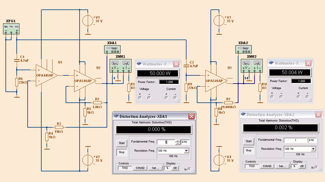

OPA541AP can use +/-35 volt supply. Gain bandwidth 1.8 MHz
It delivers 50 Watt into 8 Ohm at gain=20
THD is low. 0.002%
But upper bandwidth we get is 'only' 90 kHz

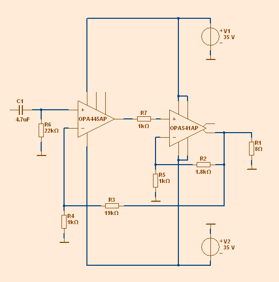

OPA445AP is a DIL8 package opamp that can take +/-45 volt supply
If we use OPA445AP at gain=20 and attach OPA541AP as buffer output
we get a combo with very good performance. Tiny THD distortion at 50 Watt.
Image 1. Shows a compare of THD at 50 Watt RMS into 8 Ohm

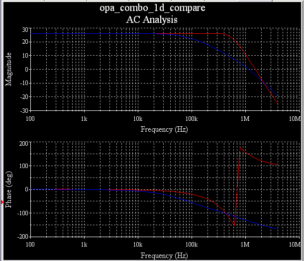

Image 2. Shows compare of AC, Combo vs. single OPA541
The upper bandwidth is ~500kHz vs. ~90kHz
It is possible to do like this with a normal opamp,
but then with dual supplies. One for buffer and one for opamp.
This combo uses only one supply +/- 35 VDC

2nd low V supply lets you use better input op amps, at only a few 10 mA you can use Zener shunt supplies for the +/-12-15 V input op amp supply - and by sub regulating you get better psrr too
more op amp choices, better perfromance only pennies added cost, or savings if lower V op amp is cheaper than opa445 (digikey wants US$11.8 in singles) - I think I'd go for "less simple"

@jcx, agreed better performance for marginally more complexity could be had using a fully differential opamp like ths4131 etc, or crazy low noise unity gain stable chips like te lme49990, but i think the point here was simple power supply, simple cct, great performance

What is the modeled THD+N of the combination at 10khz and 20khz?
The buffer is slower than the op-amp on the outside. Is that the reason for R2 and R5? Will the system oscillate like AN47 page 14 describes?
