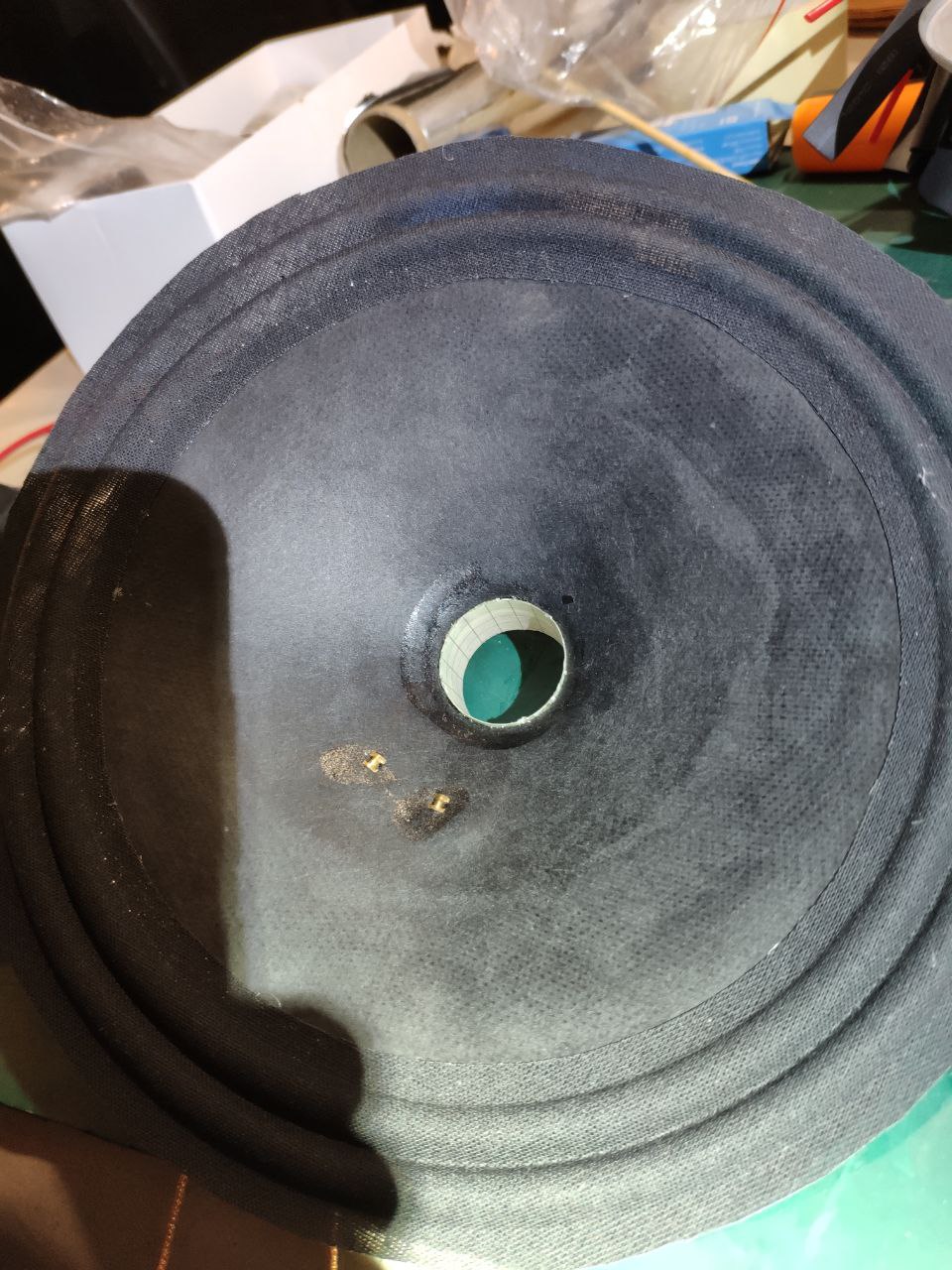

How to soften the fabric speaker surround ???? What liquid to use, to make it soft?

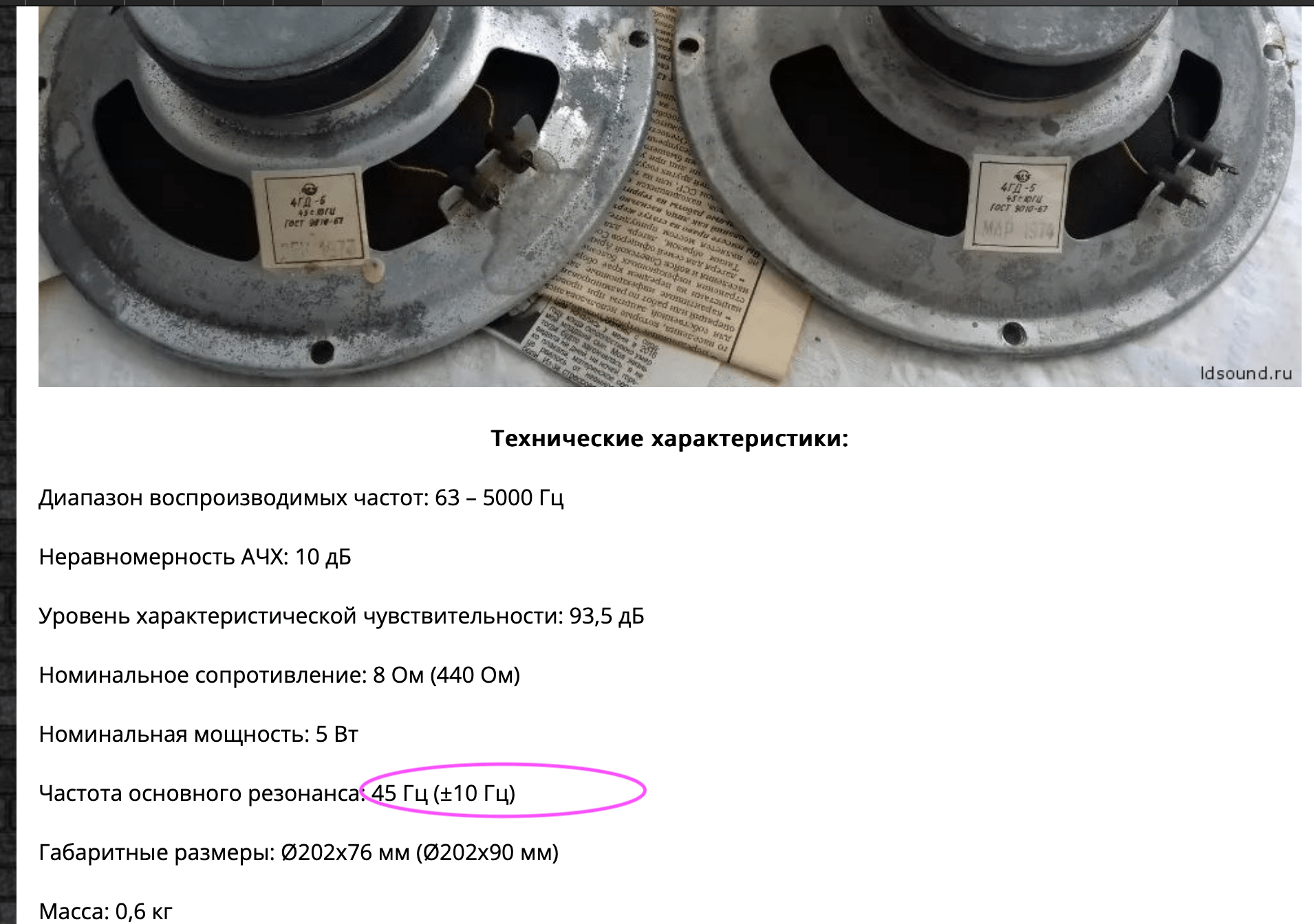

The resonant frequency of the original speaker is 48Hz!!!! I got 68Hz
So, the resonant frequency of the cone has risen after fitting the replacement surround.
Was 48 Hz the resonant frequency when the speaker was new or as measured with the perished surround?
Perhaps you need to loosen the surround by running the speaker for some time with a 50 Hz tone of reasonably high amplitude.
The PVA adhesive/sealant I mentioned earlier is unlikely to improve the elasticity of the surround, only seal it and make it airtight.
