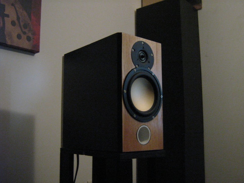

Howdy folks!
I've got a pair of little 2 ways that I've made quite some time ago (recently remade the cabinets with leftover wood from a tqwt project), using Vifa XT25TG30-04 tweets and Hi-Vi M6a midbass units. Up until now, I haven't put much effort into the crossover, it's been a simple 6db at around 2500hz. I figured it would do for a little while until I had a chance to fuss with figuring out a better one.
I'd be curious to know what some opinions might be on a good crossover point and type. Any input and suggestions are appreciated!

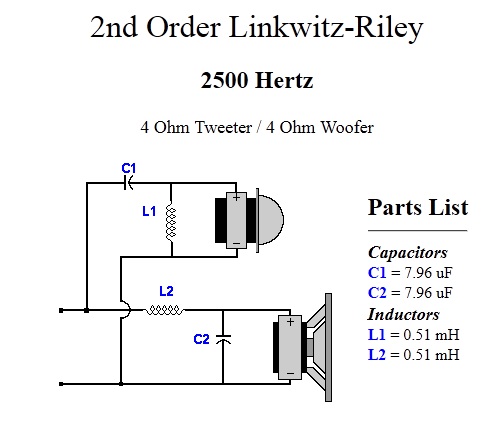

You could try this crossover network.
The 2500hz looks ok for that tweeter. A 6" should still be able to produce upper vocals and instruments well.
There is a basic rule of thumb, Fs of Tweeter x3 = lowest recommended crossover point.
That being said I might be interested in trying a 2k or 2.2k X-over.

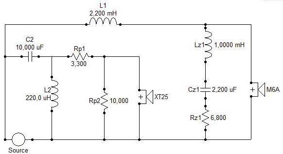

Thanks Einric, that looks a lot like what I was thinking about trying first.
Quick question though, does anyone have FRD or ZMA files for either of these drivers so they can be fussed with in Jeff Bagby's spreadsheet?
attachment.php

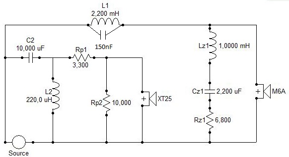

I forgot a component to suppress the 9kHz peak, add a 0.15uF capacitor in parallel of L1 (2.2mH)
Just a word about the crossover, it is a LR2 @ 2.2kHz. For the XT25 nothing special. But the M6A have 2 peaks, one near 3kHz and an other at 9kHz.

Absolutely, I can hear those peaks too and was planning on asking if anyone had corrected them and what they used. This looks like a solid plan, thank you very much!
I'll see how much of this stuff I have in my parts bin already and what I've gotta grab from madisound. I'll let you know how it works out.
Looks decent...
That 10 ohm resistor across the XT25 is a GOOD thing. You will damp the Fs enough where it will no longer be any issue at all. If the XT still buzzes on James Taylor, you'll know it.
WRT the M6a, I think the LCR may take care of the dual-peaks on its own if you reduce the resistor value, and/or decrease the cap size. You'll effectively notch out most everything above the xover point.
Looks like a decent sim.
Later,
Wolf

DrDyna, I use a similar crossover on my Vifa tweeter as well and found that it is a lot smoother and silkier with a 4.7uF series cap instead of a 10uF.
Yes the XT25 will have a better sound, the crossover frequency will be 4kHz but the Hivi cannot goes so high :eek:

Jerome, could you check this shopping list and make sure I read all your values correctly?
Coils: 2.2mh, 1.0mh, 0.22mh.
Caps: 10uf, 2.2uf, 0.15uf.
Resistors: 3.3ohm, 10ohm, 6.8ohm.
Just want to make sure I didn't move any decimals where they shouldn't be! Also, it appears that Solen has the 0.15 caps for $1.83, much cheaper!
Wow. I quickly twisted together some extra components I had laying around in this basic design and I have to say, what an improvement! Much more relaxed, less edge / harshness and great dynamics.
I can't wait to hear what they sound like once I order all the correct parts with the right values.

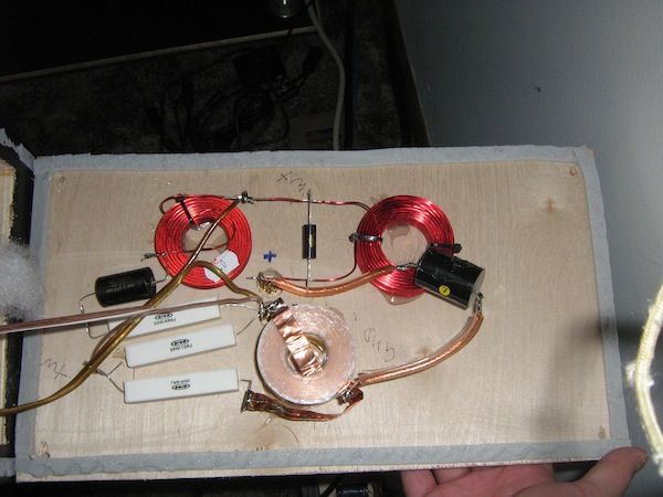

I finished the new crossover with proper values last night. I'm still in the process of listening to a variety of material, but so far, I'm very happy. They are much more relaxed and less fatiguing than they used to be now that the M6A peaks are under control and the tweeter FS is damped.
I just wanted to say thanks one more time for giving me a head start on learning Speaker Workshop and for helping me with a starting design. Next step, learn how to implement BSC!
