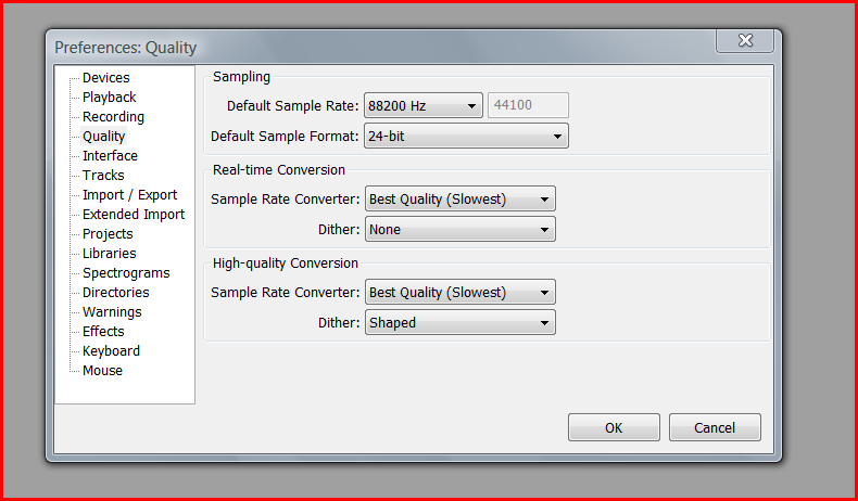

What kind of dither has been applied in Audacity?
Good question. My knowledge is lacking in this. If the file is already dithered and I'm just prunning it and resaving (using the same sample rate as the original master, 88200) then should I not have selected any dither.
What would you recommend ?

I don`t work with this software but I guess 44100 on the right is original file sample rate? Where did you found the original hi-res file? The master file should be recorded in hi-res in the studio, when the song is recorded, and you shoul know it for shure otherwise this kind of test doesn`t make sense .

The files were from the link I posted earlier with the one labelled 24bit/88200 taken at face value that that is what it is. Do you mean you think the originals were really only 44.1 and upsampled to provide the so called 88.2 master ?
