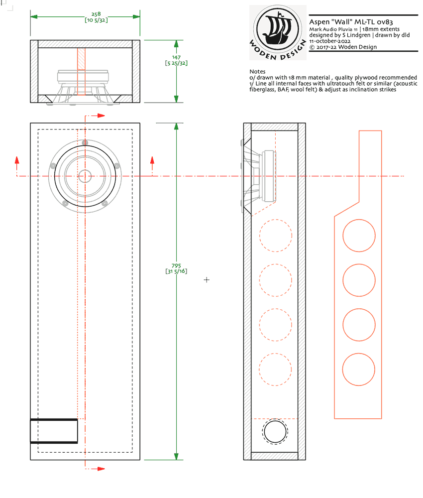

Hi, pair of Mark Audio MS 11s on there way to me, looking for a wide baffle design for them, any ideas?

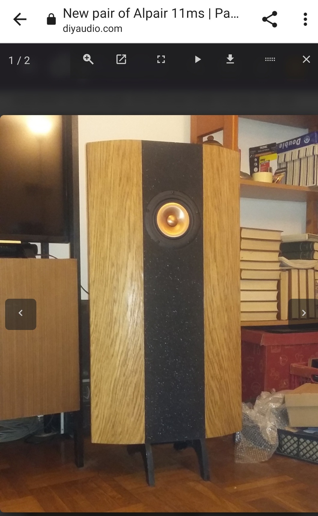

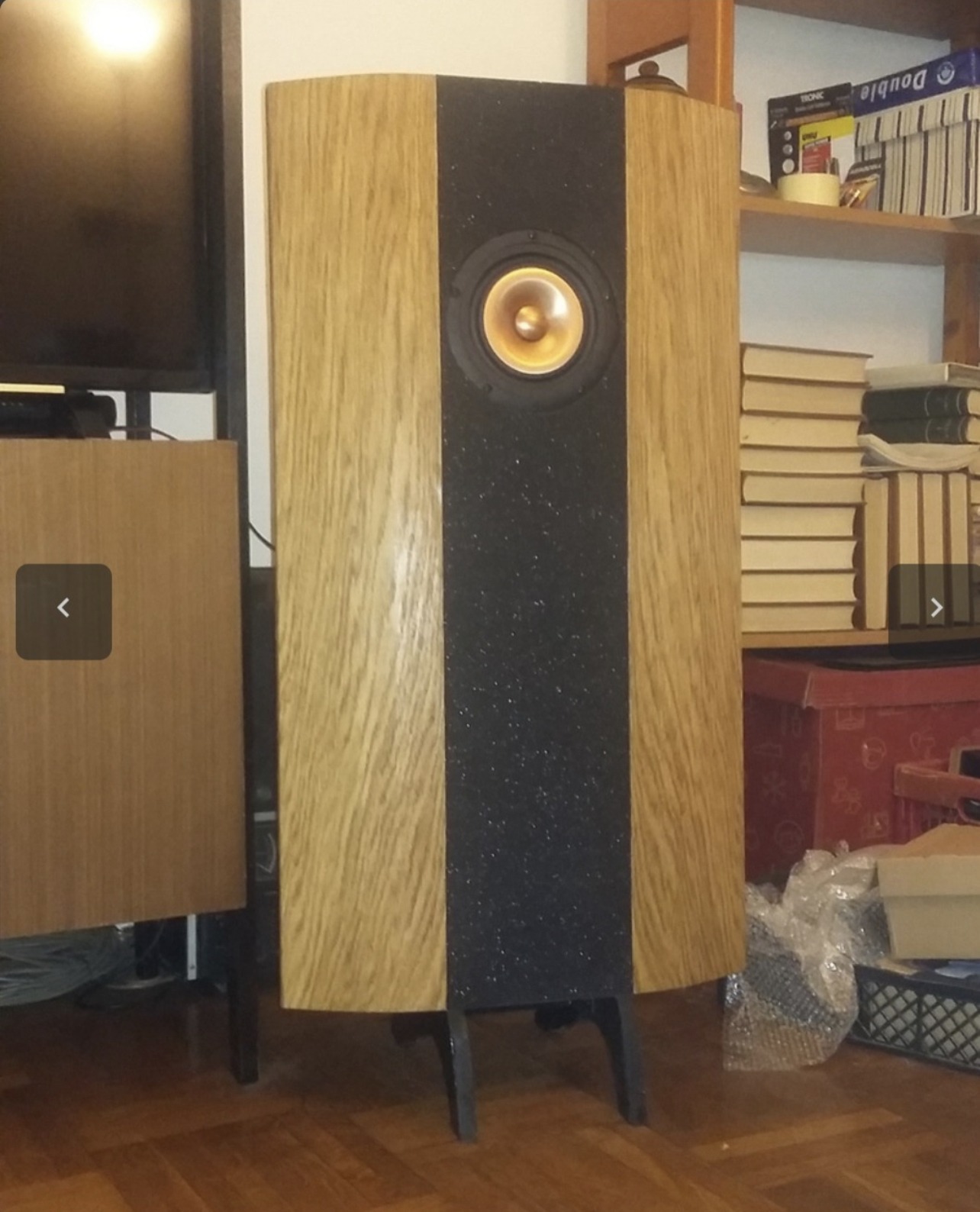

If anything, I think a full range driver naturally narrows the dispersion of the highs.
While it makes for a smaller sweet spot, it befenits by having less hf information bouncing around your room.
Now as far as the front to back imaging thing, i have no idea.
I personally could care less about imaging.
But cabinet edges are a source of re-radiation of sound.
A dome would certainly light up the edges more than a 4" driver.

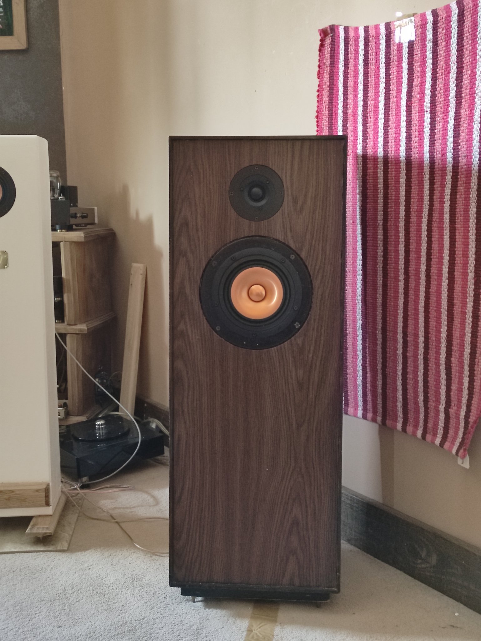

I have no issues with the imaging/soundstage of the wide baffle boxes.
There is some basis to the myth thou. In a rectangular enclosures the early edge diffraction is soon enuff that it “merges” into the direct info (resulting in masking of small bits of information) vrs a wide (rectangular) baffle that edge diffraction happens later and may be more noticeable.
In both the examples show the baffle falls away as if it was a giant roundover, ir not rectangles.
One can also mitigate the edge diffraction by increasing HF losses of any enerfgy traveling along the baffle. Thick felt et al. The more it has to travel thou/along, it will disapate/absorb more energy leaving less to the diffract when it meets the corner.
