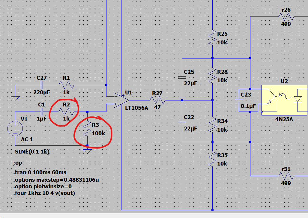

I can't just find the Whammy thread but I have a simulation of it. Assuming you use these values the impedance is essentially 101k (R2 +R3)
