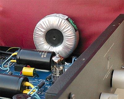

Thanks for everyone's help, I finally chose LKG1H472MESBBK Nichicon | Mouser, because the size is similar, a little smaller so I choose a 50V instead of original 35V. It is a little shorter is just give me some space to deal with the lead, because the original is 4 leads but I could not find any 4 leads cap, I have to modify this 2 leads snap in to fit the place. Thanks again.

Hi all, I recap my c-80 the day before yesterday, I am shocking....
A. I will post some pics later, the result is:
1. I destroyed my preamp
2. I destroyed one speaker channel of my m-80 power amp
3. I destroyed right middle speaker of my Klipsch k3.2
B. the story in short version
everything looks good but when I connect them to my power amp then I hear a 'kkkkk' loud sound then the world is quiet, my power amp get into protection mode, after unplug the power and change the fuse, my power amp A B channel come back, but the C channel that connected the speakers when accident happen is gone forever.

2. after two hours, I figured out what is damaged, then I order a JBL 8'' subwoofer, and it comes today, I swap it then it works, I actually gained more bass now ...
3. in the third hour I begin to look for a new c-80, then I found one, I bought it today after driving about 200 mils (with an unbelievably reasonable price) , the new one looks much better than my old one, the sound is the same, but the caps in it also almost burst, I'd say the caps in the new one is worse than the old one originally has.
D.questions
For now, I just have one question, if someday, the caps in the new one finally are burst up or some kind of failed or damaged by themselves, what will happen? It will destroy my power amp or something else?
