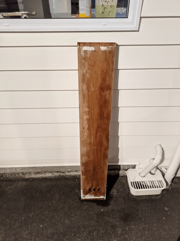

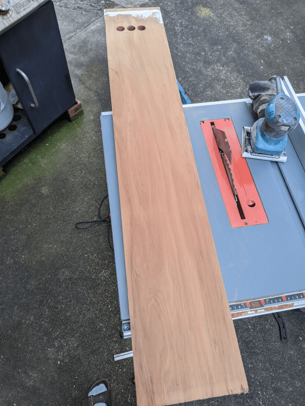

I had some Rimu I had saved from doing some renovations that I thought would look nice as the fronts for them

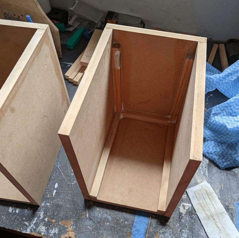

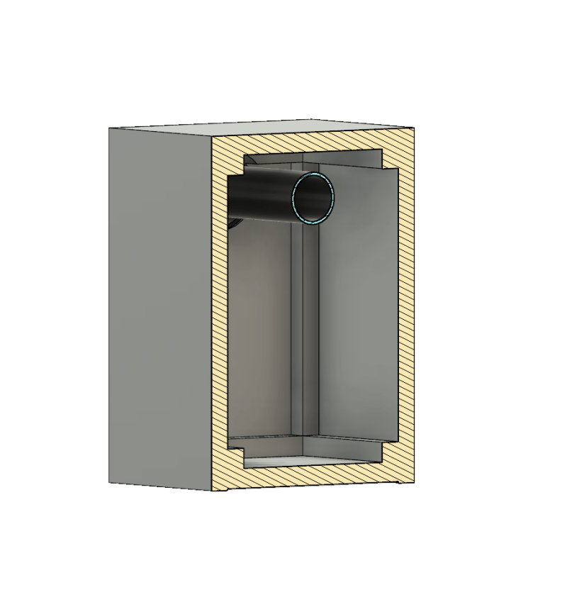

And I adjusted the original box dimensions a bit so I could add some square stock for more gluing surface while keeping the original internal volume
(probably wasn't required, but it gave me piece of mind).

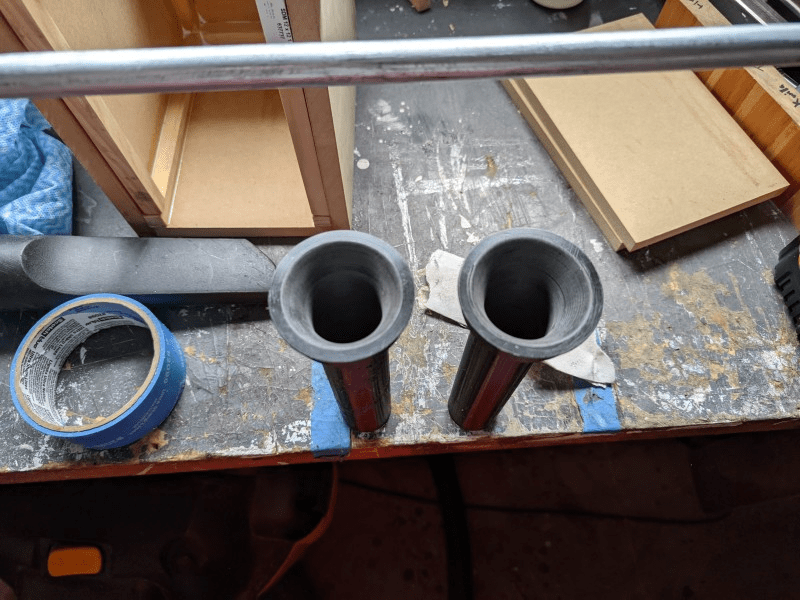

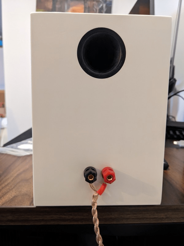

I 3d printed the ports (again because I'm cheap - but I have the tools, so I couldn't see why not)

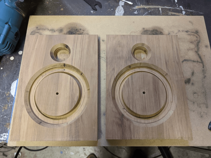

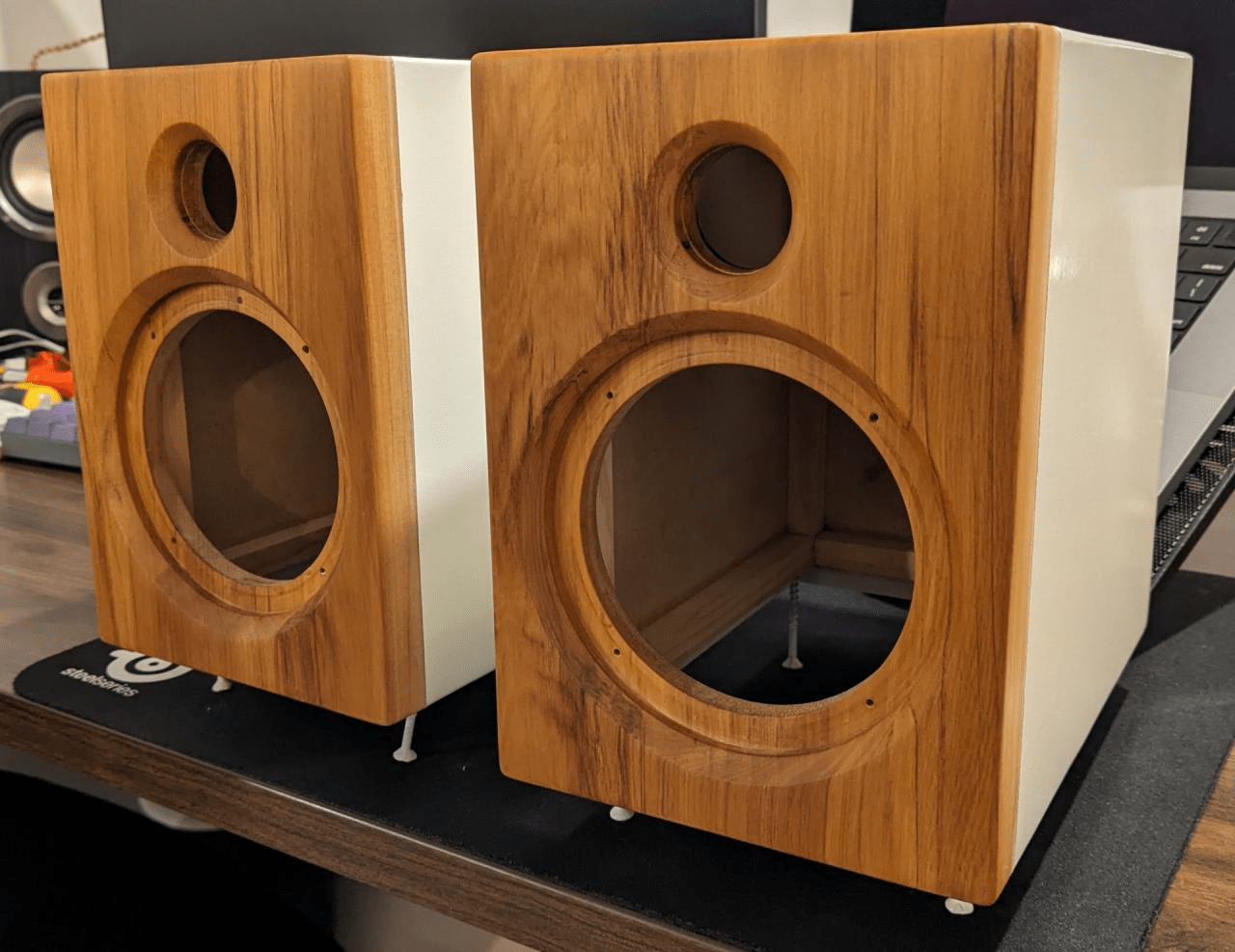

The faces were routed out using some temporary jigs with the rimu double-sided taped down to some old mdf

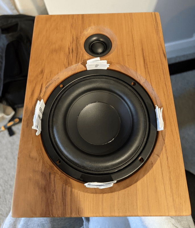

The body's were primered and then spray painted with Honda champ white (I had it in stock 😉 ), and the front faces were waxed
Here's the tweeters and woofers going in:
Ports and posts installed:

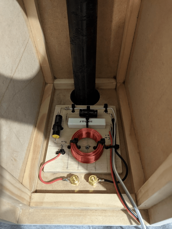

Crossover in place:
Crossover in place:

Awesome, How'd you get that paint job to look so good on the MDF?
Thanks. They are not perfect - the camera is just forgiving 😀.
I filled in any defects with a thin amount of body filler and sanded (probably 240 grit), then primed, then lightly sanded the primer to flatten it, before giving it a couple of top coats with some 1k / arcrlyic paint I had in a rattle can for my car. I didn't bother with a clear coat because I wanted a more matte finish, but if you wanted a glossy finish then ~3 coats of clear followed by a wet sand with ~800grit to flatten any orange peel, then a cut/polish would make them super shiny.
Awesome work timondrius. They look great. NZ home reno = infinite salvageable and beautiful heart rimu. Put in a new kitchen subfloor in my bungalow last year and have a near lifetime supply for speakers.
