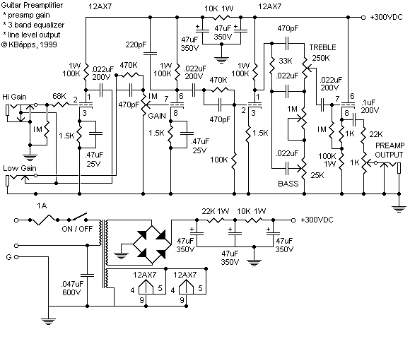

So, look at proposal for tube preamp. This preamp you can connect directly to lm3875. I think it's exactly what your son need.
Oly

I understand what you are saying about the tube pre-amp, but I'm just not up to it yet. My current DIY resume consists of a pair of cross-overs for 2-way speakers!
