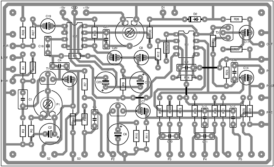

I drew the printed preamplifier for bass guitar Albert Kreuzer I will fulfill my system because I do not put across his.
Now I think the amplifier! 🙄
Please post some sound clips of that preamp once it is done. I am just finishing up my most recent bass preamp build and am always keen to hear other designs.
Ok, no problem!

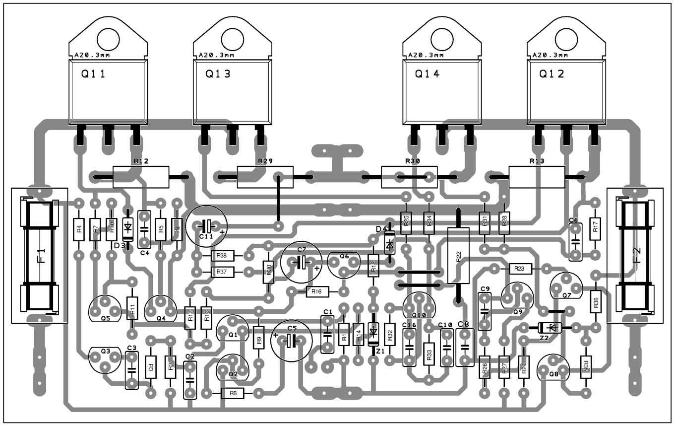

It will probably work, and in fact each half looks very much like one of my standard power amps (so called Lin type amp) , but:
1) 200W/8 ohms? NO WAY
Max peak voltage on the speaker would be 52V , and that with a regulated PSU .
With the one shown, considering at least 20% loss, it would be 52x.8=41.6V Pk .
You will have extra 10% loss into the emitter resistors, so this leaves you with 41.6x.9=37.5V Pk=26.5V RMS=87W RMS.
Which is also confirmed by the power transformer rating:
40VAC @ 4A= 160VA rating, good for a 100W amp, tops.
2) it does not have short circuit protection, which can be forgiven in a Home Hi Fi amplifier or even in a "fixed" installation PA (think a Church or a Theater) but never in a Musical Instrument amp which travels a lot and gets plugged/unplugged many times.
3) for that kind of power, search for the ApexAudio schematics around here, but the ones with short protection.
Rodd Elliott also has suitable amps.
EDIT: to be more precise, *one* of them has short protection, the other one does not 😱 , the Author makes tha unwarranted assumption that "if one current limits, the other is protected too" which is very dubious.
No need to bridge when you can easily get 200/8 with conventional circuits.
Hint: you'll need around 65/70V rails for that.

My choice is made and I opted for the latter scheme. I drew my circuit and it remains only controlling me if the design is ok. For information the output will be darlingtons TIP142 - TIP147 and small signal transistors BC546 and BC556.
In a short time I started directing the preamplifier and amplifier. If all goes well I'll post the drawings of PCBs, of course I will make a report on the sound.
Regards!
