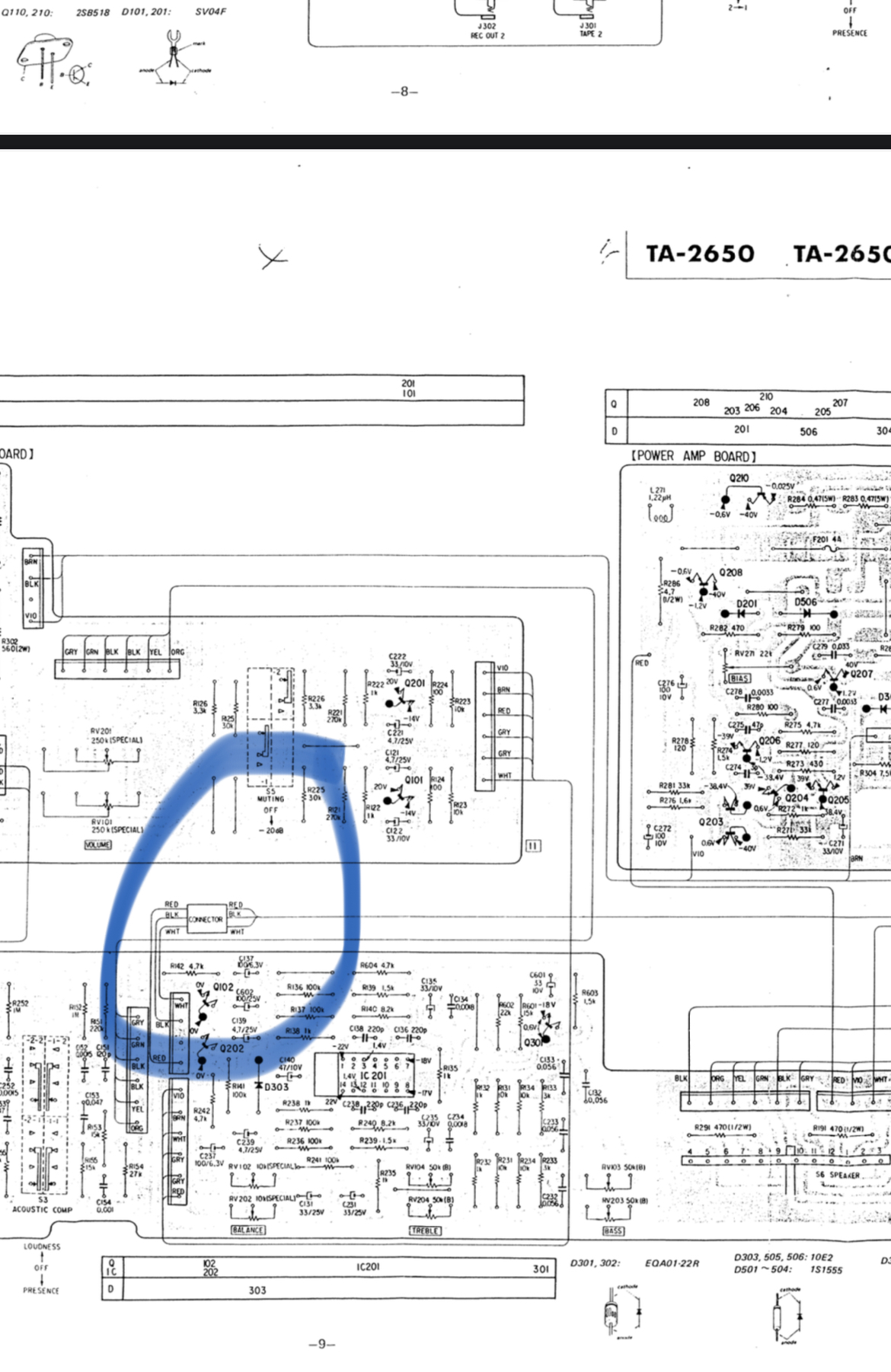

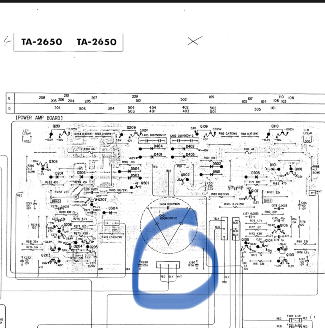

They go from control board to power amp board. I’m guessing there is very little output from the white wire so that’s why so low and I was thinking the balance pot. Although I did clean it and it’s free with no static.
I checked for open caps but can’t find any.
Looks like at some point the white wire signal is being dropped.
May have to take it in as beyond my abilities.
Is there a way I can bypass the balance pot just to check??

Another experiment: tie the two wipers of the balance pot together through a 1k resistor. (The resistor is a current-limiting precaution.) Audio may or may not appear in both speakers. The result should tell you if the defect is before or after the balance control.
