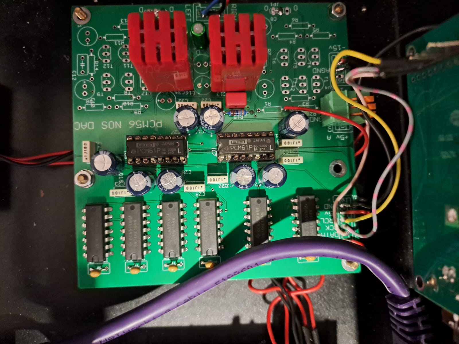

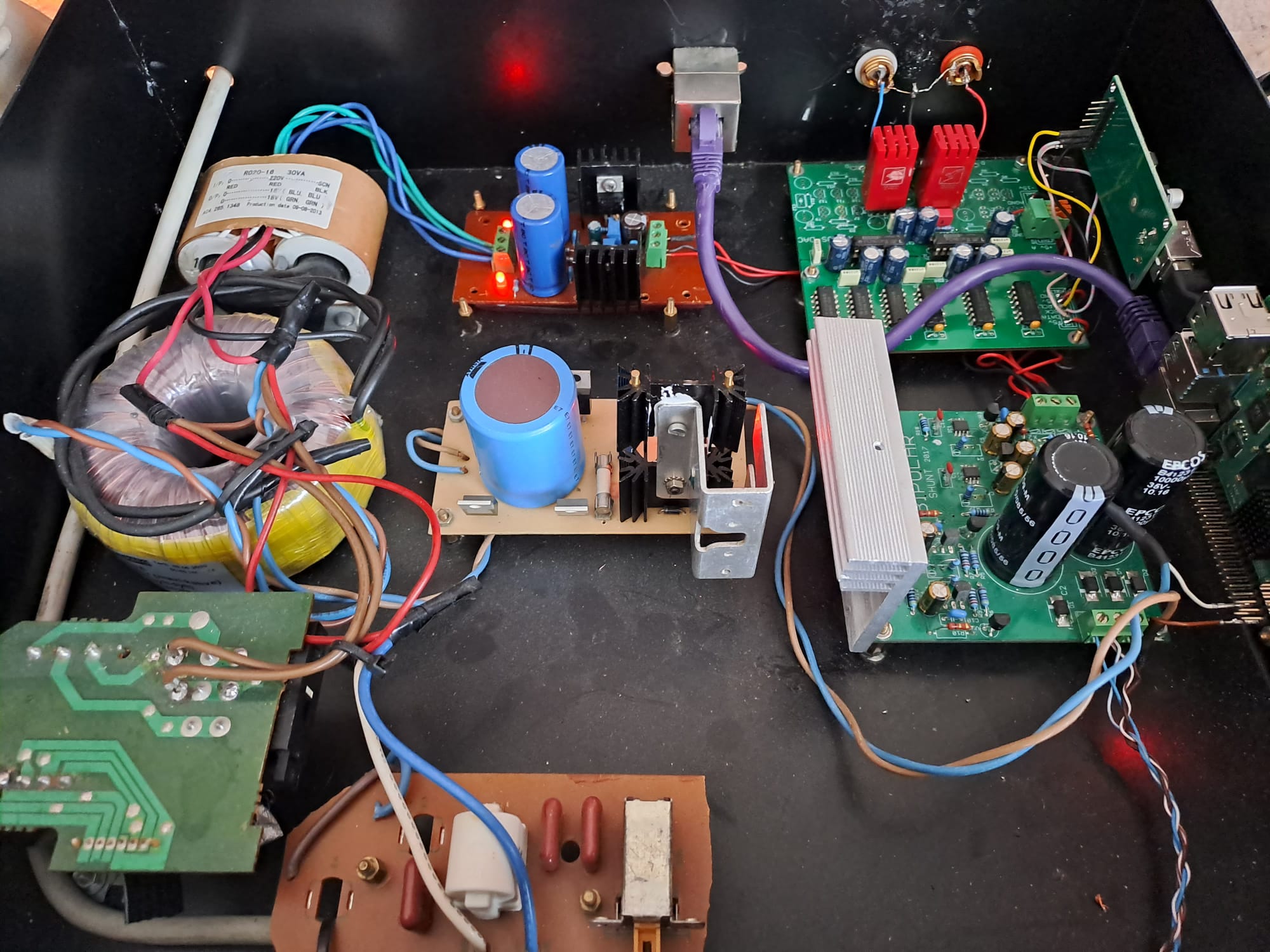

I built a R2R dac years ago, based on PCM61. I tried Vivid6 Singles, alongside with AD711,AD825,AD844,NE5534,LME49990.
Dac is pretty simple. Digital and analog ground is separated. PCB have discrete IV selectable with jumpers.
Dac power supply is based on Placid shunt psu.
Raspberry Pi and USB Xmos supplied with homebrew L-Adapter.
IV stage power supply is simple 317/337 regulators.
IV resistors are 3.3K, Lpf cap is Wima 470pf.
Player is Moodeaudio.
No oversampling.
IV stage psu voltage is 14.5V
First I tried Burson Vivid 6 Singles. Listened songs that I listened thousand times. First impression was mostly good.
After sometime when I power off dac, there was a nasty pop at the speakers.
I never had that before. This PCB was working with other opamps without any thump or pop.
I measured dc offset at the output of opamps. To my surprise there was a huge dc offset, around 50-100mV, both channels.
I never used any capacitors at the output of IV stage. Other than AD844 opamp has only few mv at the output, for AD844 I'm nulling DC with trimpot.
So I have to fix this problem with the Bursons. I simply put 10uf muse es capacitors at the output for both opamps.
So no pop or thump at power off.

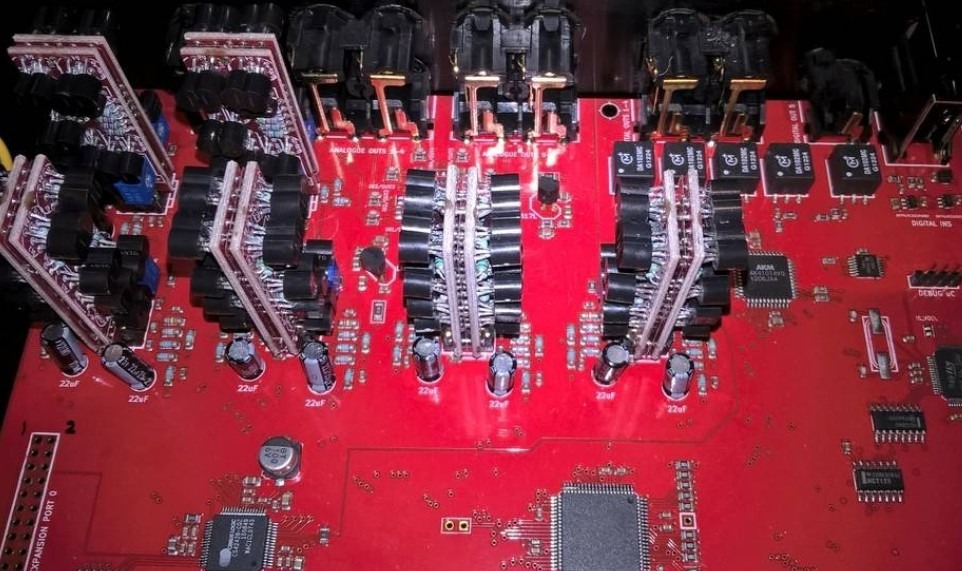

I replaced the stock LM833N opamps in my WAF Najda DSP X/O DAC to Burson years ago and was pleased with the result.
The sound was, how shall I put it -a bit more 'vivid'🙂
Many have done this change too.
No pops or cracks on power off ever. Not heard of any other Najda user having that either.
Yours are off course the newer more compact ones.
It's been 8 years + now, and they have been good as gold.
This is them mounted on the first Najda version. I'm now on a later dark green V1.3 (I think it is) board with the same result.

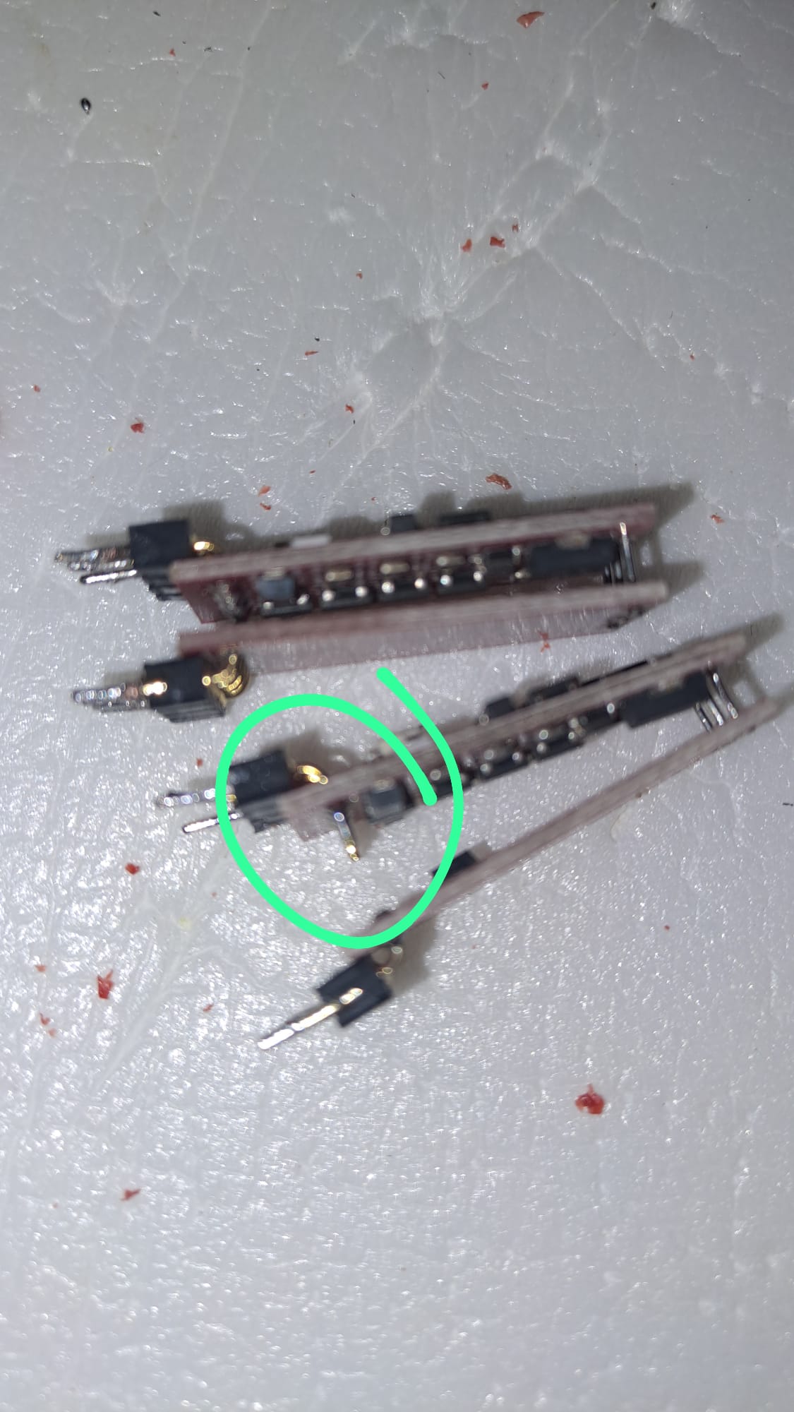

There was a increased distortion and some kind of buzzing noise at one channel. It was random.
So I decided to remove the red cases;
Opamp pins at one side is not cutted from inside and these pins were touching each other. Other opamp pins was ok.
As I said it is intermittent and random. Before I removed the red cases when I tap top of the opamp this buzz and distortion vanishes or resurface.
I cut these inner pins. But buzzing sound does not go away anymore. I think opamp has damaged by this manufacturing error.
