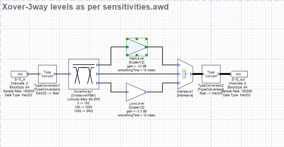

Question relating to Audioweaver design in Ultimate Preamp on-board memory
I've had my Ultimate Preamp running unchanged for 18 months.
When I first received it I customised the preconfigured 3-way crossover script from the download page and saved it to the on-board flash memory.
Now I want to temporarily try some HF amps that require the HF level to be reduced.
I made the level change and ran the script on the Ultimate Preamp on-board memory. CPU shows as 0.41%. All good.
When I attempt to play something with JRiver I get
Playback could not be started on the output 'ASIO' using the format '44.1kHz 2ch'.
If I now close Audio Weaver so I can play something, does the script continue to run on the Ultimate Preamp on-board memory?
Thanks.

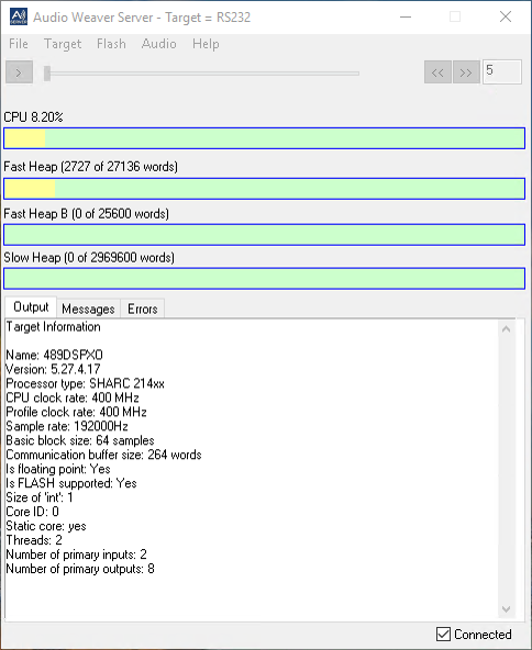

When I run the script in the on-board memory that appears to work because it shows CPU activity as depicted in the instructions.
I was hoping not to load the script into on-board flash because it's only temporary and I don't want to disturb the normal operation.
In that document it says "This script will run on the Ultimate-Preamp on-board memory so long as the Ultimate-Preamp is not switched off. "
My plan was to let the script to run in the on-board memory until my testing is finished.
Presumably, both AudioWeaver and JRiver can't use the interface at the same time.
But when I close AudioWeaver it appears that the script running in the on-board memory is no longer running. At least, if I restart AudioWeaver it shows 0% CPU activity in the Ultimate Preamp so I assume it's no longer running.
If it's not connecting then make sure you have a USB cable connected to the service port on the back of the Preamp. If you don't have an extra USB cable you can just temporarily swap the cable from the Amanero USB port to the service port and then swap back once everything has been configured and you are ready to play some music.
If it's still not connecting check this in the Windows device manager. Then you may have to reinstall the FTDI driver again. ie go Start -> Ultimate Preamplifier -> USB Driver -> Win-7 USB Driver
PS If you want to configure Audio Weaver and play music at the same time then you will need both USB ports connected 😉

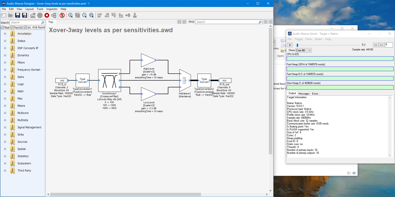

Thanks very much Dave. With a second USB cable connected to the service port I was able to connect using RS232 and COM4. I can see the scripts I loaded into the on-board flash memory 18 months ago running.
With the 3-way xover I’m using the bass, mid-bass and mid outputs on the Ultimate Preamp.
I loaded the 3-way xover and reduced the high level from -1.8dB to -12dB.
I click Run and the upload process appears to have been successful.
However, I’m not hearing any difference.
If I click “Halt” all activity in the Server stops and there’s no playback so I assume the modified script is running in the on-board memory.
Any suggestions please?

Thanks again for your help David. Bit embarrassing really. I misunderstood how the xover component worked in Audio Weaver. Expecting to have HF at the top and LF at the bottom but it's the other way around.
All good now.
