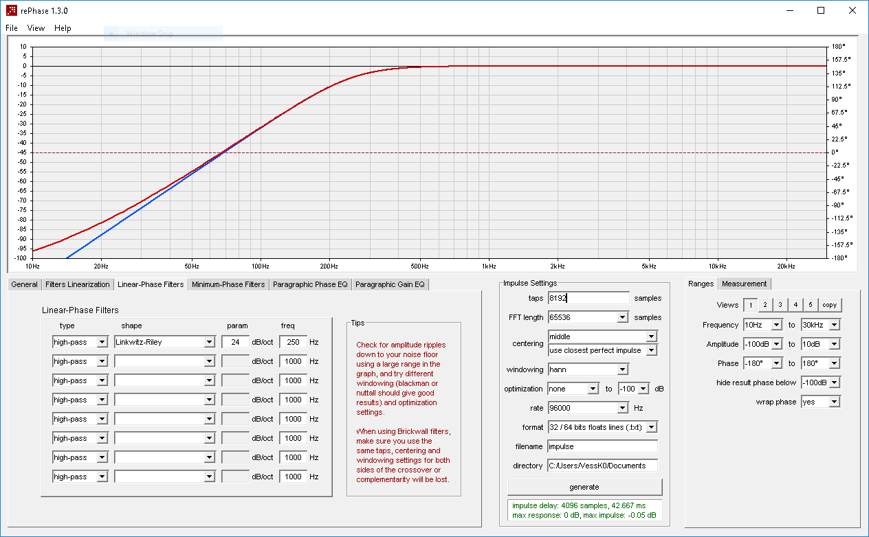

Thank you very much, I will wait for the information. I really like the product and once the final revision is ready I will probably buy it if has enough taps.
For example here is the amount of error for a high-pass LR4 @ 250Hz and 8192 taps.
