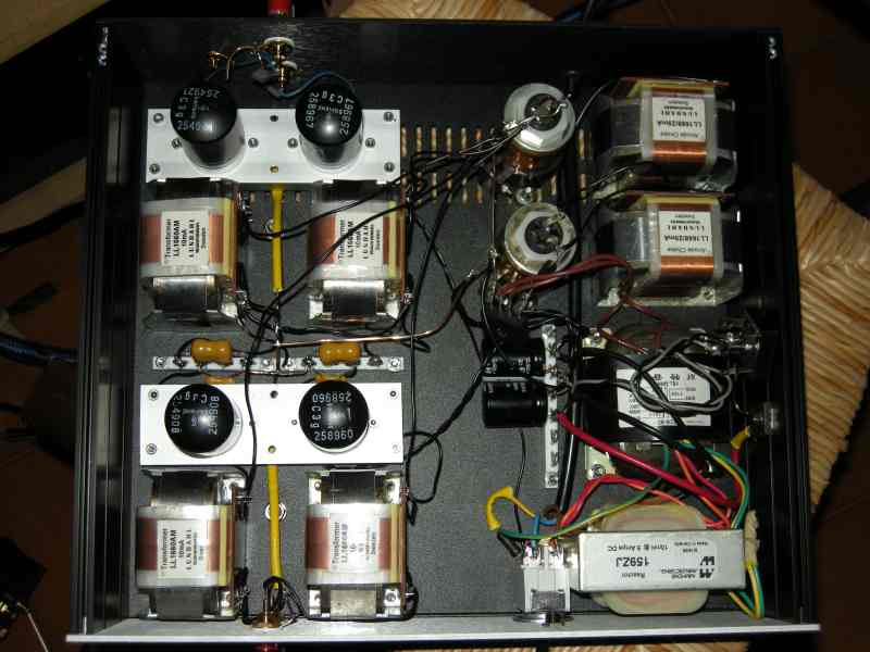

Can you bring the reservoir capacitors closer to the consumers? That way there's better HF decoupling and less LF stray pick up.
Have you tested the unit for RIAA accuracy yet?
Just wondering if you have compared your B+ power supply with other designs, such as those with shunt regulators or various sandy devices? How quiet is it? I like the simplicity of just chokes and capacitors.

No, in my previous phono stage I have used a virtual battery but here I was searching a simple passive way to get no noiseagent.5 said:Just wondering if you have compared your B+ power supply with other designs, such as those with shunt regulators or various sandy devices? How quiet is it? I like the simplicity of just chokes and capacitors.
I don't like preampl. so I use amplifier with enougth gain and passive attenuatormp9 said:- i like the simplicity. i couldn't have designed it but could build a copy only i don't know what you consider to be a "very good amp" or if my humble Fi 2a3's would qualify?
Yes, top single ended amplifier
- is the intent to use a passive preamp between it and the power amp for attenuation? [/B]
disco said:Can you bring the reservoir capacitors closer to the consumers? That way there's better HF decoupling and less LF stray pick up.
yes see the RIAA red plot compared to the feq. response of this circuit
The RIAA plot is very near to the ideal

I consider the transformers more neutral than any capacitors and any resistors so for me it is a no compromise solution.
The total cost should be about 1000-1100 euro but the sonic performance should be better than any other phono stage near to 10000 euro like the Audionote top serie.

transformers from Tango and horrendously expensive NOS tubes off ebay.
I have also built it completely from parts out of some boxes, but I do not consider those parts as junk, i.e. unwanted residues from other projects.
But honestly, something with two plain cathode followers in the signal path doesn't excite me, and I would never bother to build it - having done
almost exactly that back around 1978. I'm sure it sounds very pleasant, but for me at least, things have moved on.
You have every right to your own taste or opinion, but in this case the cathode followers are three, because you should count in the line stage as well.
While I do not doubt that you built something with cathode followers back in 1978, I am quite sure the implementation was different, because at that time
the approach to cathode followers was different, and I have no reason to believe (without proof, just because you say so) in your design creativity and
innovative thinking.
Maybe you like transformers better, and that is also a prerogative of a free person. On the other hand, I do not like transformers better. I believe that
tubes work at their best without transformers, and that is particularly true for small signals where transformers can be avoided. In the large signal
game, or driving intrinsically low impedance loudspeakers, you just need transformers to keep things simple, otherwise you will have a very complicated
OTL amplifier with lots of part and reliability issues.
Transformers are there, to my belief, to simplify things, because you just need a transformer, a tube, and a cathode resistor... instead of an elaborate
circuit (yes, a CCDGC gain block is an elaborate circuit in comparison). I would gladly do without coupling caps wherever possible, but that would induce
reliability problems, and obvious problems for the DIYers (or for a manufacturer, for that matter, either in production and assembly or in post-sales
assistance).
Therefore, I do not think that Andrea's design is NO COMPROMISE. It is a compromise definitely, and a costly one. But he, or whoever else, can call it a
reference project provided it sounds real good. When it comes to the RPA, I can assure you that the sound is quite far from "pleasant" which is a nice
patronizing term in this case. And it is a compromise, like everything in life - or in electronics and physics. The perpetuum mobile has not been
invented, and never will be.
