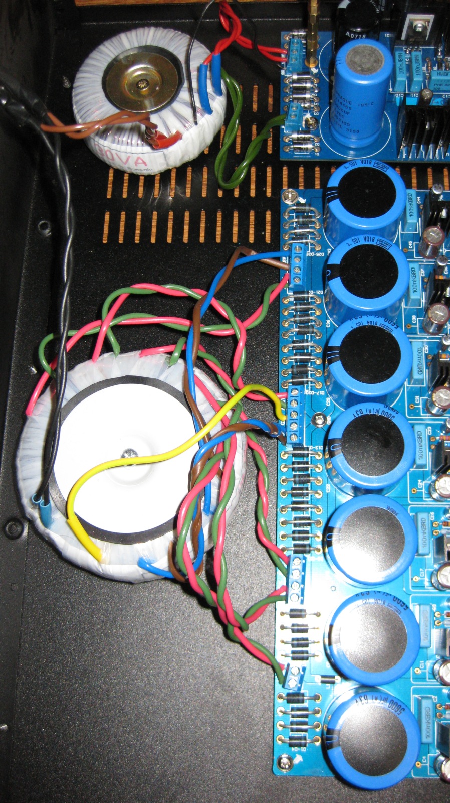

Mine was noisy at first, turned out to be the transformer wiring and grounding....

I see what you mean. Inside chassis there is no hum and less hiss. Still I cannot explain the "artifacts". I intend to buy a new chip TDA1541A and try to see if converters is the problem. After that, receiver and buffers.

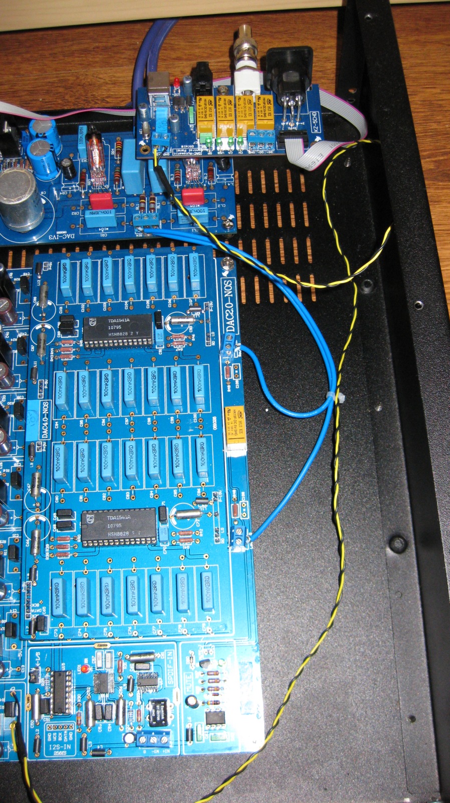

I saw on your picture that the resistors (R41,R42 & R46,R47) are still there.
Try to short them all!

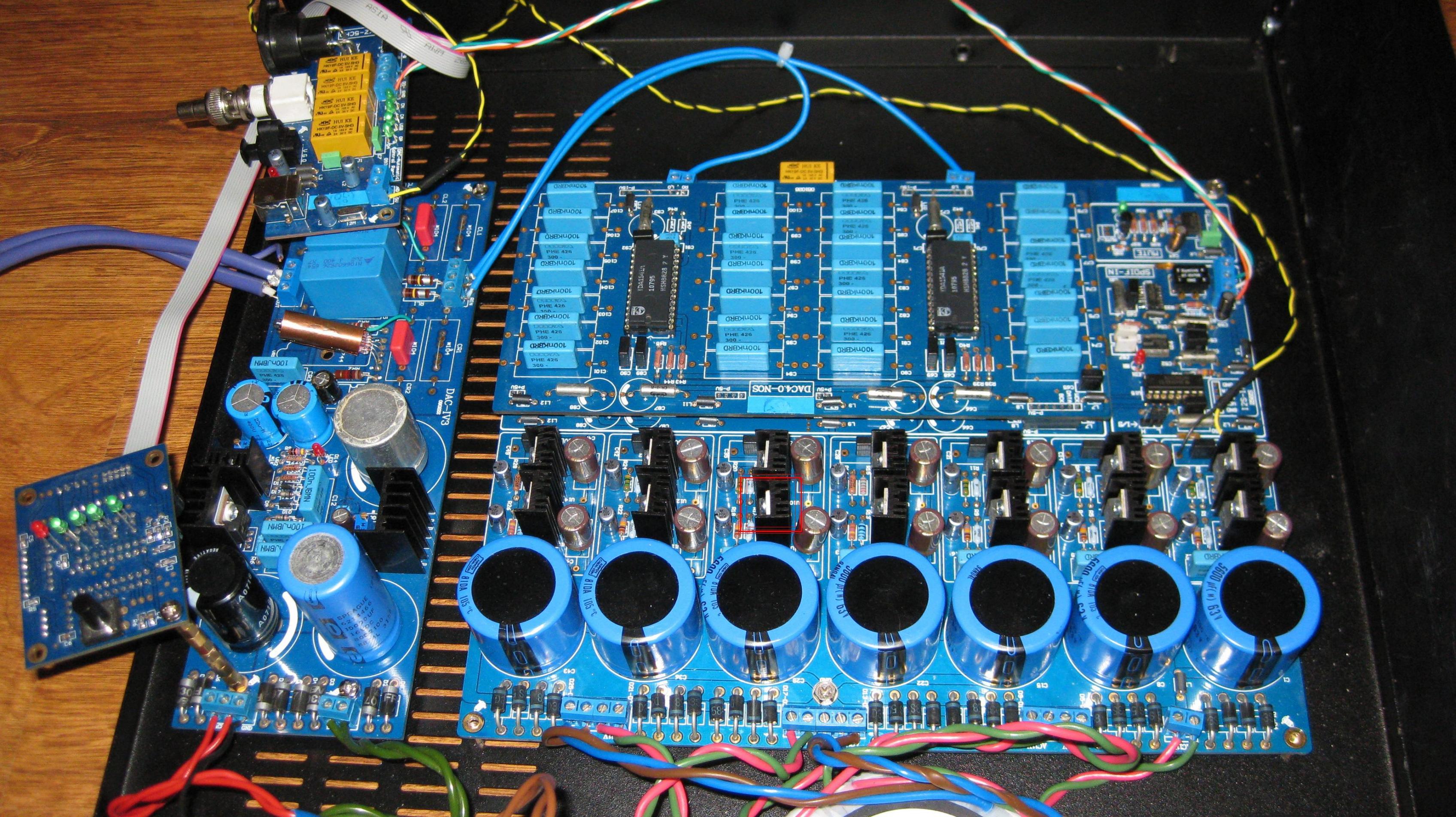

Hi dvb,
After many hours of testing (changing TDA's, dir9001, DS chips), finally I've found the problem, it was one of the voltage regulator LT1084 (shown in the pictures) that didn't work properly, although the voltage measurement was correct(-5V, +5V and -15V) at the TDAs. What I did, I've replaced temporary the LT1084 with LM317. No more "artifacts".
Shorted (R41,R42 & R46,R47).
Secondly the input coupling cap C1 is not required for a Current output Dac like the tda1541. Short that cap.
I am also thinking of removing C2.
Last put a film bypass across C4 also.
Metal film resistors will help clean up the sound too...
Removed C1, raised C5 to 2,2u but kept C2.
Much better
Thank you everybody for support.
