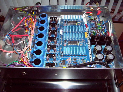

I have just completed a build of this TDA1541 x 4 DAC and the HDAM stage.
It is the most detailed and dimensional CD replay that I have ever heard. I am hearing macro detail that I was never aware of previously but what is more important it hangs the whole performance together with a beguiling mid-range and also majors on the low frequencies. In my book you would have to pay $1000's to come close.
I used three seperate toriodal transformers for the power supplies.
BNC connection for the SPDIF.
I have to say that I am persuaded by NOS applications but that may not be your bag.
John
John

Looks very good and I have every reason to beleive it sounds awesome.
In relation to Hi-end, I would like to add my opinion.
I have a TDA1541 based player and I'd most definately say it was high end! It's miles and miles in front of a musical fidelity A5.5 and only just behind my firends audioaero ($8000) player.
It looks to me as though several key principles have been considered in the design of this kit.
The many seperate regulators will ensure that little noise is transfered between key stages. High quility components appear to have been used (large smoothers clearly visible). Multiple transformer inputs ensure complete seperation of the PSU's. VCXO is way better than the std xtal in almost all cdps. Fully discrete output stage as compared to cheap opamps.
The 1541 chips are capable of an unbelieveable sound when they are presented with clean signal, clean rails with good decoupling and a good clock.
Most manufactuers claiming Hi-end performance are clearly falling way short of what this device will be capable of.
How much do you need to spend to get quad DAC's, 10+ supply rails and a discrete output stage from a mainstream manufacturer?? I would estimate that with handfull of transformers this kit (inc HDAM) would cost less than £400 to build.
I've never heard quad TDA's IMHO the theory says it all.
I'd certainly not hesitate to compare with a £2-3k player.
Just my opinion

Hi, for the balance output for this DAC, the only way is re-design the circuit as this is the difference application. I am appreicate if anybody can give the advice.🙂
Single-ended to Balanced output
Two commons solutions are a pair of Jensen or Cinemag line output transformers with 600 ohms split secondaries. The primary impedance should be properly matched to the HDAM output impedance.
Jensen and Cinemag will respond to technical queries if you tell them teh HDAM output impedance, maximum output voltage and load seen by the secondary. Expect to pay about U$ 160 for the pair of transformers.
A less expensive option is to make your own balanced line drivers using a couple of Burr Browns DRV135 chips. These are specified to drive cleanly long cables and tough 600 ohm studio loads. The schematic is in the datasheet.
Good luck
Good luck
Also have a look at THAT Corp line drivers and line receivers 😉 line receiver That1200 (searching this reference will directly lead you to the right website).
