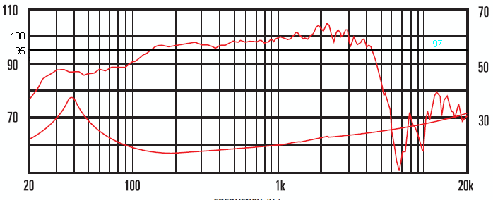

audiodesign said:
Hi Andrea ,
keep in consideration that those Celestion Graphic frequency response
is a 2pistr condition.
Thus I suggest to apply "the Edge" software and see how much BSL you have to subtract.
To my eyes approximatively you can obtain a net (maybe) 93-94 dB ( 4 pi str) it depands of the "shape" you decide.
Paolo

From all the careful work you have done with finding a woofer and making comparisons(on some specs), I really dont understand your choise
Sure, its on sale on Ebay, and obviously an expired model
But you have been aiming fore the best woofer
I think its really very little to save, considering all the work you have ahead of you still
You said you wanted very low mms, yet still good bass
I dont doubt it a good PA woofer, but considering that you will use it up in the midrange it wouldnt be my choise, not even close
