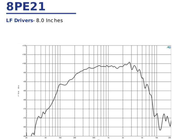

I think the problem with the B&C 8PE21 for the OP's task is the very low Qts that causes early rolloff on the low-end, it already have about -8dB at 150Hz, at least according to the factory datasheet. But it was not mentioned that only the filter is 1st order at 160Hz or the driver's acoustical response with the filter.
As i will use a first order xo, i dont think i could get away with a xo pointmmuch higher then 250hz if the woofers are placed on the side walls to avoid coloration. Correct?
so i need a mid about 95 db with smooth top end roll off, very fast response to match the dual woofers and planar tweeter xo at 1300hz
B&C 8PE21 does what you need…..and it’s a fantastic sounding driver to boot. I’ve run them up to 3khz with a simple EQ notch…..best midrange I’ve experienced other than a few very expensive dome mids.
The B&C 8PE21 response looks really good.

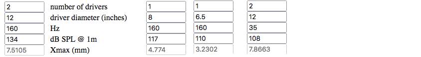

The B&C 8NDL64 and 8MDN51 are slightly less sensitive in the 200-2kHz range, but have more Xmax.
In the 160-1300Hz range, the choice between the 8PE21 and either the 8NDL64 or 8MDN51 might come down to how hard one wants the low mids to hit.
I'm using a pair of the 8NDL64 for subwoofers from 23 to 100 Hz presently, they sound fine up to (and a bit past..) +/-5mm excursion-even when used to 1500Hz.
I would not go higher than 160Hz crossing to side mounted woofers.

No frequency response charts to compare (not a good sign..), but the 1426 listing an Xmax of 4mm and Xdamage of 6mm is a bad sign, ~3dB dynamic change might put the driver onto the casualty list.
The 1752 has less excursion (3mm), but a higher Xdamage (9mm), you should hear it distort before it makes nasty sounds.
The 6.5" drivers can't come close to the peak output of the Beyma 12br70's at 160Hz, but should be within a few dB of what they can do at 35Hz, ~108 dB.
At any rate, youknowyou ('re) music and where it's dynamics lie.
