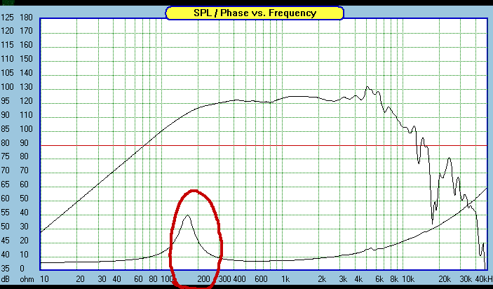

Directivity is a goal yes. Ill be using a 80 degree horn, so it will be crossed around 1900 hz.
That B&C seems interesting! Good sensitivity and smooth rolloff.
Re: Re: Hi efficiency 8 inch midrange - recommendations?
Inductor said:
That's not good because of Fs (is) too close, (that) you don't want.
Could you elaborate a bit? I thought the only problem with running a driver below fs is that its gonna have a hard time getting any output.

The peak at 5khz is negligable, and a fair tradeoff for what you get otherwise. Given an LR4 at 2.5khz you'd never be able to isolate it during listening.

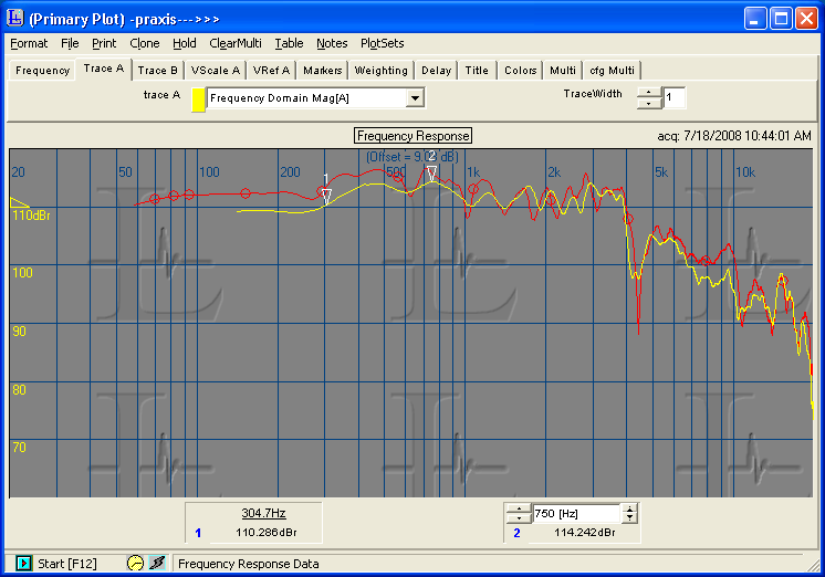

I've measured my 21" Beyma, its actually better than the Seas W22 when it comes to THD at the same SPL at 300 Hz.

You must not have heard any good 15" drivers. Our TD15M is flat to 4KHz where it then rolls off nicely without any harsh breakup. By 10KHz it is only about 12dB down. We actually do a variant and EQ it flat to 10KHz to play in bass guitar cabinets.
In the midrange and vocal region, the large drivers will sound much better as they have to only move a fraction as far as a smaller driver to get the same SPL. Much lower input power means much lower thermal distortion issues. It also means less flux modulation and less inductance variation with excursion.
The only thing you need to worry about is your required dispersion pattern. Due to the nature of the larger drivers you will have a more narrow pattern, but at 2KHz you are still fairly good to 30 degrees off axis in any given direction. At 1KHz you can go to 45degrees giving you a 90 degree coverage pattern that will mate nicely with many waveguides there.
