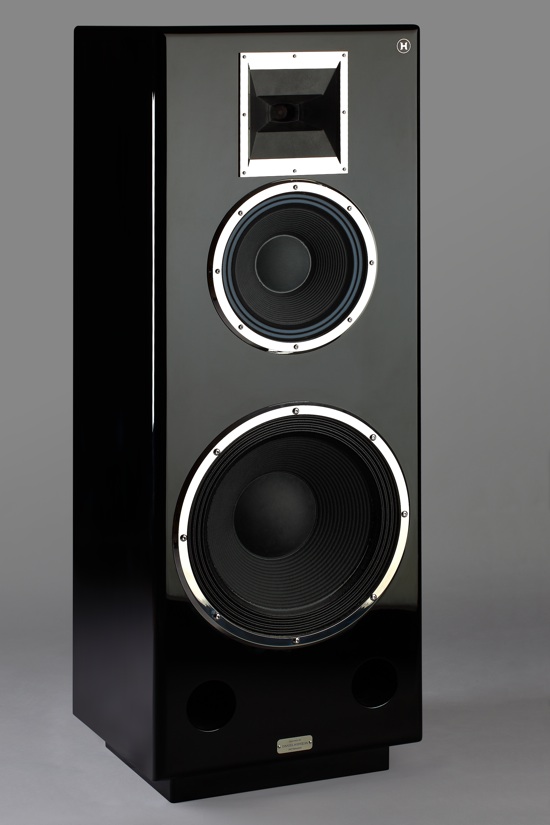

1) Mark Levinson commercial Daniel Hertz $100,000

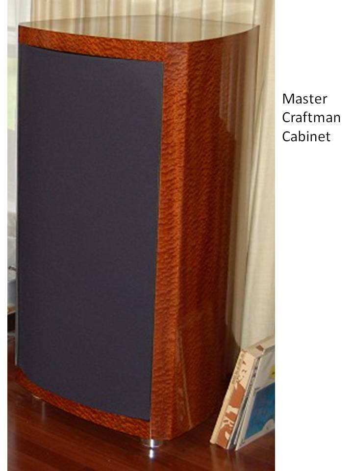

4) Super Craftman woodworker with curved sides

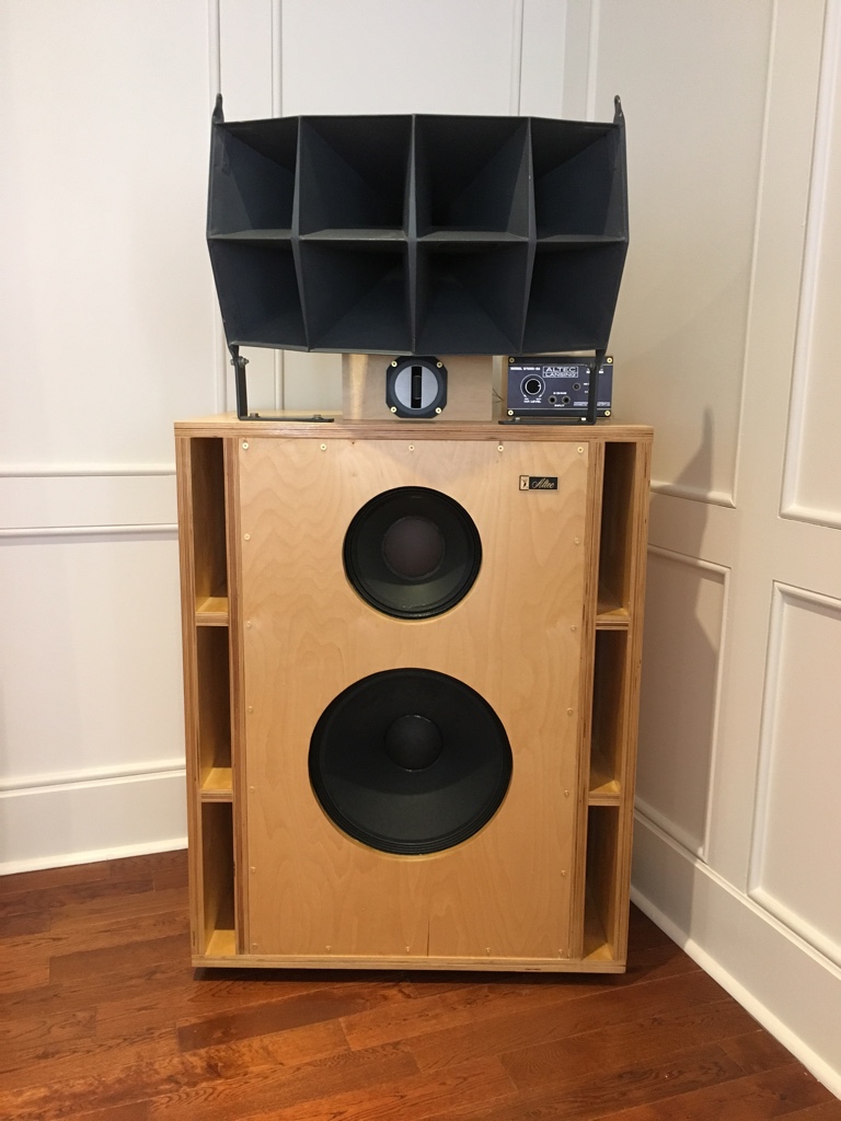

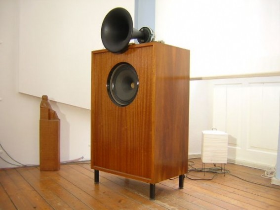

5) Single cabinet with Onken vented woofer plus sealed volume midbass

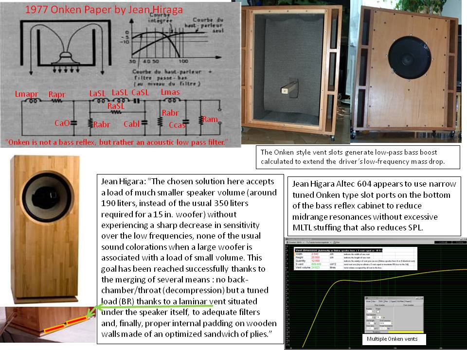

6) Jean Hiraga 604 design: Bottom Onken vents used with MLTL alignment
---If you still "favor" Onken Cabinets.
In 1977 Jean Higara published a paper on Onken Cabinet construction which pulled together ideas started in 1965. For his recent Altec 604 coaxial, Jean Higara combined the low pass filter functionality provided by Onken tuned vents with bottom-ported Mass Loaded Transmission Line (MLTL) efficient bass extension plus cabinet resonance reduction.

I didn't exclude Onken and Jean Higara looking promising - narrow tuned smaller cabinet.
I will study if I can calculate this type of Onken for 18FH500...
