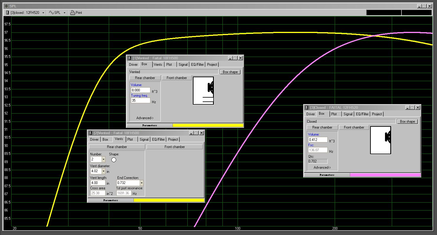

A quick sim of Faital 18FH500 in 8cuft ported box tuned to 35Hz, along with 12FH520 in sealed 0.42cuft volume illustrates the close match of SPL sensitivity, and also suitability for a crossover near the typical 150-200Hz baffle step frequency(just one SPL bump to solve instead of two). Tuning the woofer bass-reflex port length can provide some room integration help...wall placement etc...

I did similar simulations 🙂
12FH520 F3 122Hz in optimal 13 dm3 (plus driver 2.4 dm3) - about 0.55 cuft
I think that for 12FH520 will be no need to HPF - only LPF
1 cuft = 28.32 dm3
18FH500 in optimal cabinet 235 dm3 (8.3 cuft) shows excellence f3 36 Hz
18FH500 in smaller 150 dm3 (5.3 cuft) is f3 44 Hz not bad but...

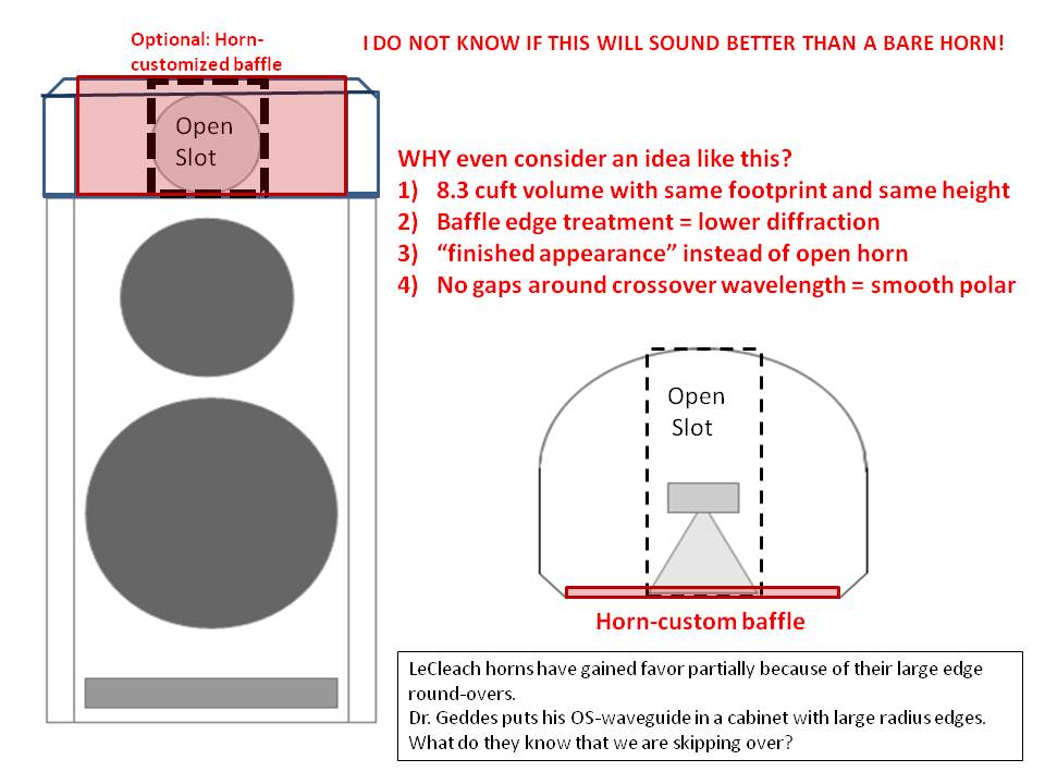

Great progress! Spring is coming with extra daylight hours. Vivaldi
Because you will get excellent transient response from your sealed box 12" midbass, I am sure that you have made the best choice with this bass reflex woofer cabinet. The Onken design is optimized for a smooth room interface when one woofer is required to cover an extra-wide bandwidth range.
Your current design makes it easy to change horns in the future.
I DO NOT KNOW IF THIS WILL SOUND BETTER THAN A BARE HORN!
LeCleach horns have gained favor partially because of their large edge round-overs.
Dr. Geddes puts his OS-waveguide in a cabinet with large radius edges.
What do they know that we are skipping over?
You could get 8.3cuft for the 35Hz F3 woofer if you "artistically" increase your cabinet height in a manner that loosely surrounds your tweeter horn -- like a square slot with open top drop-in. Maybe a top with beveled edges like your side detail? 1200Hz =11" wavelength. No physical gaps around the crossover frequency "should" produce smoother midrange-to-tweeter SPL curves.
NEED MORE diyAudio DISCUSSION... NAKED vs. BOXED HORN.

Well 🙂
I think that I leave horn on top without baffle - I want to make them a jewel 🙂
I'm scared of dimension required for this 8 cuft.
My Klipsch Tangent 400 are 100cm/38cm/36cm ( 40"/15"/14") and there was a little fight with my women when they arrived. To be honest I did 12cm (4,7") stand and still tweeter is a bit too low.
When I'm sitting on couch my ears are about 100-102cm (40-41") above floor.
To hide "fat" dimensions maybe I make the cabinet a bit taller (110cm or 43-44").
Other problem is time alignment.
When I make frot baffle angled that give me two positive - good time alignment and slimmer look, but less inside volume too.
I'm going use flexi playwood for rounded parts.
I choose BR over Onken because I read some negative opinions about them and there is hard to calculate for me (I founded some calc but not trust them 100%). Onken make the cabinet even wider. Classic BR with big vent area (min 25% od sd) is good enough I hope.
Need to find soft for modeling 3d cabinets 🙂
