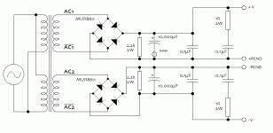

Also national semiconductor's approach to PSU
Yes, that was referred to towards the end of the original thread. It shows certain signs of being inspired by Carlos's approach but without really understanding it. Also the PCB grounding isn't something I'd suggest anybody copies.
So no, its not optimum yet because you haven't adopted a star ground.
I'm going to take back what I said about star grounding in power supplies. I've just simulated with LTSpice two different layout styles, and really it makes no difference to the output noise, so please ignore me.😀
What I found does make a significant difference is the ESR of the two 10,000uF caps. So there is definitely mileage in paralleling smaller values here rather than using just two big ones. Oh, the splitting of the 1R into two 0.5R makes a few dB of improvement too, depending on the ESR of these caps.
Engineering, like life, isn't so black and white as 'right' and 'wrong'. Its more a question of optimising within certain constraints. So no, its not optimum yet because you haven't adopted a star ground. So even though you're filtering the noise on the + and - rails, you're at the same time introducing noise on your ground by bussing it along various caps. To get a really nice quiet supply, the grounds to the 10,000uF caps need to have their own unique path back to a central star point. Then the output ground is another lead out from the star. Make the area between the 2k2 resistors into your star and all the other ground connections then lead out direct from this.
Apart from this, it looks fine as regards placement😀
HI abraxalito,🙂 thanks for the tip on star ground. Will post it after correction you said.😉
thanks

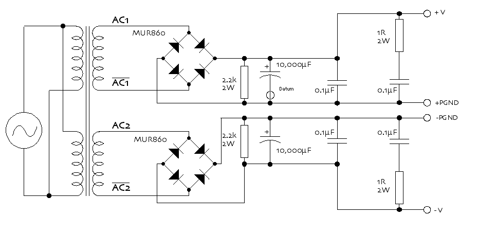

post 3 shows rev3.The schematic in Post #3 is wrong. I'll leave it to the OP to figure
out the mistake. Attaching the right one -
Which revision are you showing?
