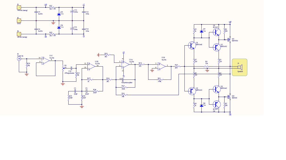

hi can anyone help me with this circuit
i got this circuit from this forums but i do not understand how it is work and where is the mosfet driver and why it use to different mosfets

MOSFET driver is Q4,5,6,7.

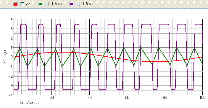

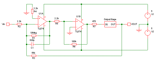

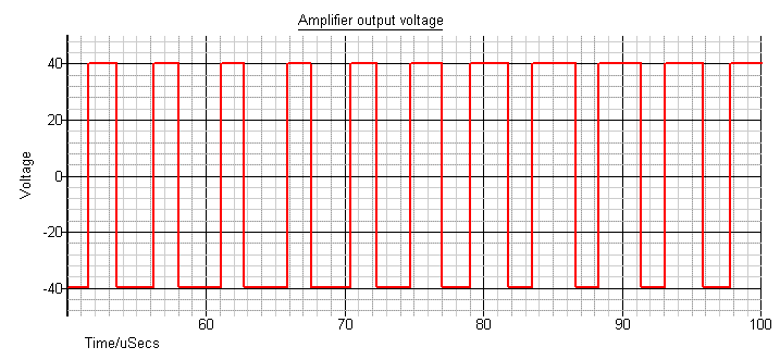

U1A: integrator, U1B: histeretic comparator. Basically it works like an NE555. C9 is charged until the comparator reaches the threshold, it changes the output polarity, and the capacitor starts to discharge (because of the current from R16). Input voltage makes discharging faster and charging slower (for positive input ploarity), so modifies duty cycle.
Feedback and integrator works as the usual 1st order feedback loop also, keep distortion low.
I quess you mean "two different".
Different MOSFETs are used because positive rail is different polarity from negative rail. N-channel MOSFET for negative, p-channel for positive. N-channel for positive is more complicated.
When the output of U1B goes positive, Q1 switches on, pulling it's collector voltage down. This switches Q5 and M1 on, pulling the output voltage up.
At the same time, Q2 is switched off and current through R6 switches Q4 on. Q4 pulls the voltage on the gate of M2 down to switch it off fast.
Similarly, when the output of U1B goes negative M2 is switched on, M1 is switched off, and the output voltage goes down.
oh ok .. so Q3 and Q6 do not have function
Yes they do! I only explained one half of the operation in detail, and hoped you would understand that the other half is similar. Here is the other half of the explanation in detail:
When the output of U1B goes negative, Q2 switches on, pulling it's collector voltage up. This switches Q6 and M2 on, pulling the output voltage down.
At the same time, Q1 is switched off and current through R5 switches Q3 on. Q3 pulls the voltage on the gate of M1 up to switch it off fast.
i do not understand how TL074 behave
TL074 is a quad opamp. That means it is one integrated circuit containing four opamps. In your circuit, U1A is an opamp, U1B is an opamp, U1C is an opamp, and U1D is an opamp. Each one is just a normal opamp, but they are used in different ways.

is the function of UD is a differentiation op amp or what
C1, C2, R18, R23 and R24 are all marked "DNP". Does that mean "Do Not Place", or something else?
If those parts are left out then U1D is a unity gain buffer. If those parts are included then U1D has some gain and the frequency response will be changed.
