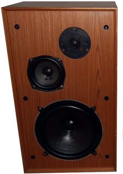

Any suggestions for Celestion HF2001 replacement?
I read lots of threads and most close one looks like a Seas 19TFF1.
AFAIK there is no data for HF2001 except voice coil diameter. So, how we know seas replacement is close or match for HF2001?
Anyone succesfully integrate 19TFF1 in place of HF2001?
What about crossover mods? Do I have to modify crossover for seas replacement?
Speakers are ditton 332.

Replaced hf2001s with seas 19TFF1.
Sound is not the same anymore. High frequencies sounds shrilled and thin, lost their depth. Sometimes sound becomes disturbing and speakers becomes hard to listen.
I didn't do anything to crossover. Should I?

Steve I'm from istanbul. Sadly options are limited in my country, I have to outsource what I need.
Check the attached crossover pdf file recieved from KEF.
I replaced old original elcap capacitors with alcap caps except tweeter network. I used polypropylene caps at tweeter network.
C1 =60uf
C2=16uf
C3=6uf
C4=12uf
C5=3.3uf
C6=8uf
C7=1.5uf
R1&R2 is around 8.2ohm
Working HF2001 tweeter measures 7.4ohm.
Tonally old hf2001 had warm and not disturbing high frequencies. But seas high frequencies are IMO lower in dB and higher in fq. Result is hardly natural hf response with too crisp tone.

Good work there. What we seem to have is this sort of thing on the tweeter:
Probably works like this around 4kHz:
Good three ways work like this in theory:
But the second capacitor is 8uF. Coil must be about 0.20mH. No 2.2R level adjust resistor fitted, so I'd expect it to sound loud. What Celestion have done there is add a 1.5uH/ 8.2R Zobel to tame the lively top end of the tweeter. That is probably too much high frequency rolloff for the flattish SEAS 19TFF1. Try removing the 1.5uF capacitor or take out the 8.2R. Might restore the top end a little. But hard to say.

In the meantime I wrote to falcon acoustics and they're suggesting lpad network at the crossover for -2dB decrease! (1.6ohm&33ohm)
I'm really confused, should I aim for lowering the HF response with Lpad or increase the output of the tweeter by removing cap or resistor.

I would try Steve's suggestion of removing (breaking the path of) the Zobel network first - just to gauge the audible effect.
Attenuation can be done with a single resistor if necessary. Look how Steve has positioned a 2.2 ohm resistor in his example tweeter circuits.
