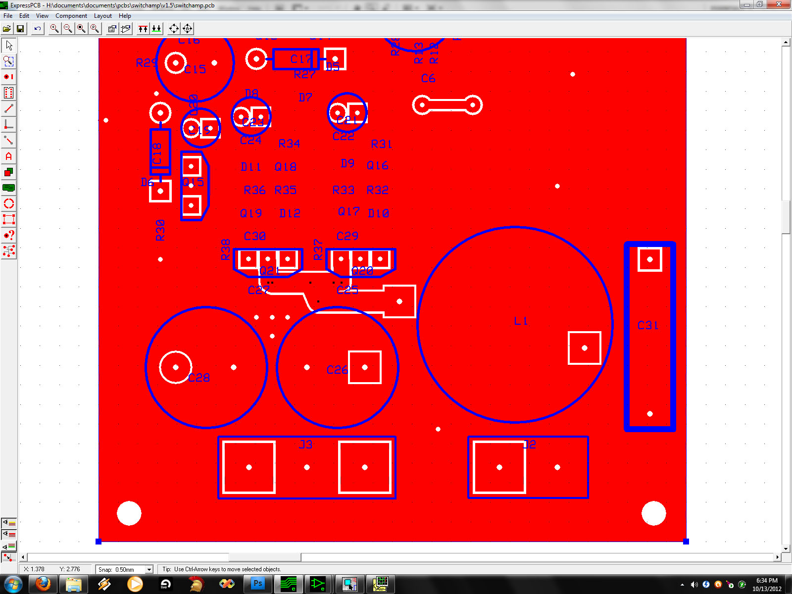

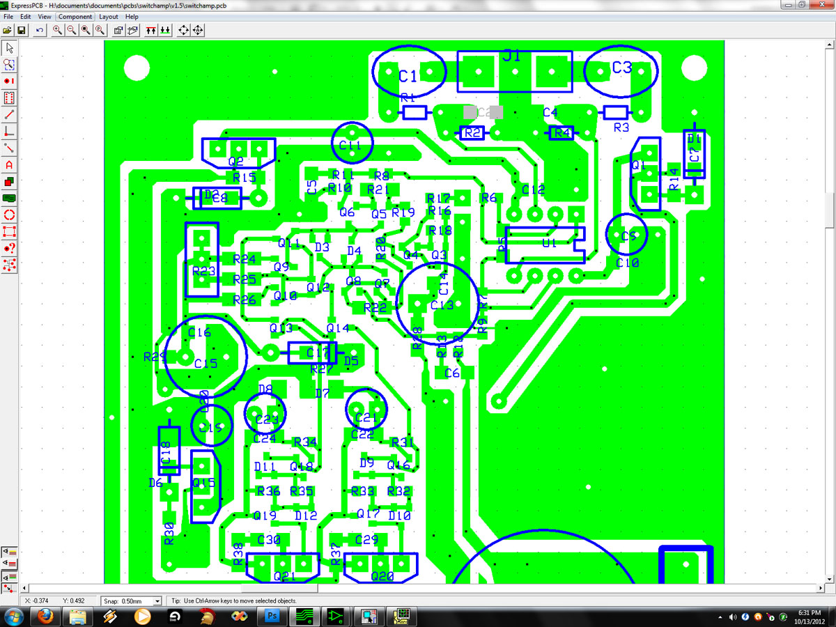

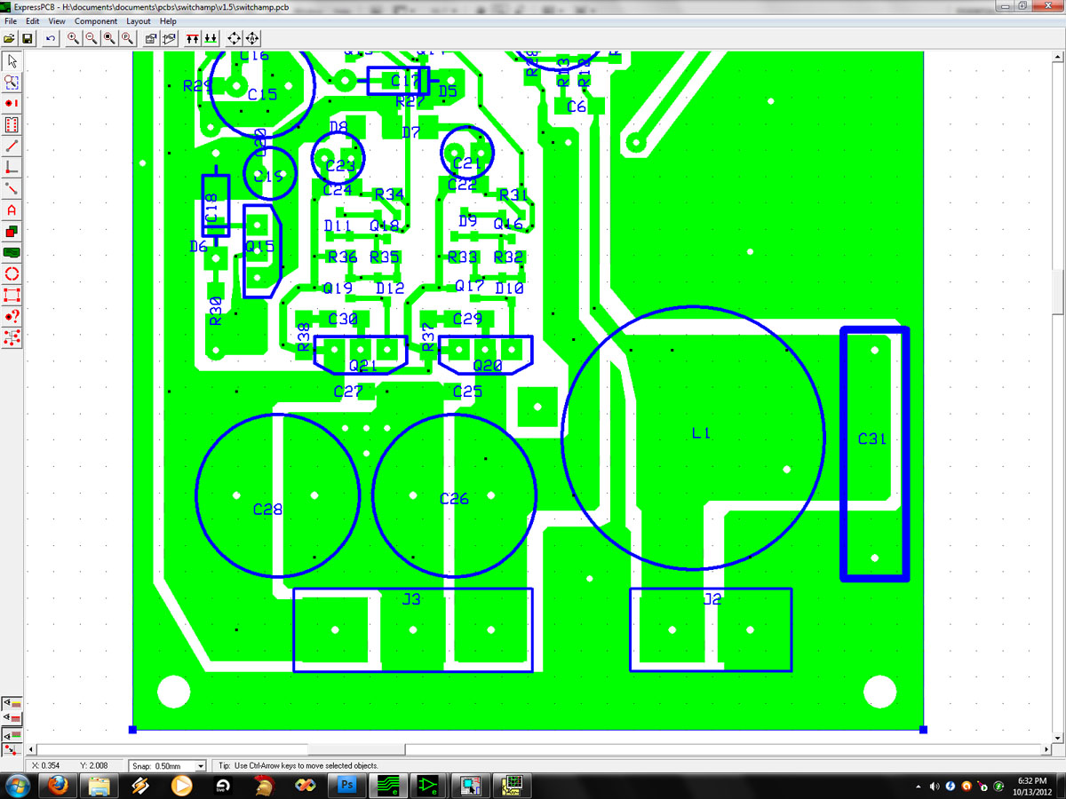

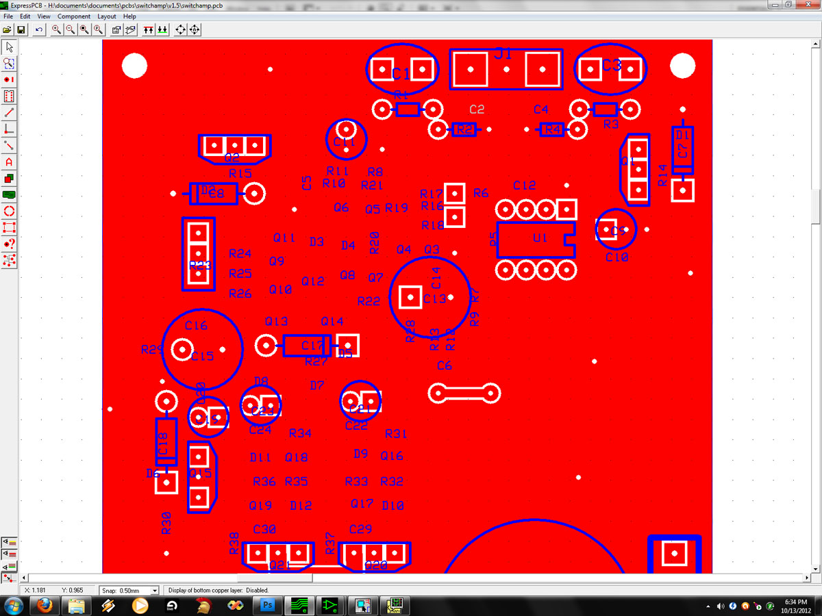

If you post decent pics of your layout (both sides) it'll help with figuring out actual current paths - current flows in loop; minimise them. and that nasty "ground" symbol on a schematic does a beautiful job of hiding the current return path. draw the actual current paths on your layout (eg in CAD, using a non-copper layer), remembering that the current starts and ends with the DC bus filter caps - out the cap, thru the FET, the filter inductor and then the filter cap, along the "ground" plane and back into the DC bus cap.
Once you've drawn the physical loop(s), the solution will probably leap out at you.

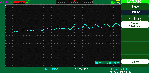

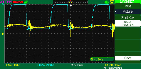

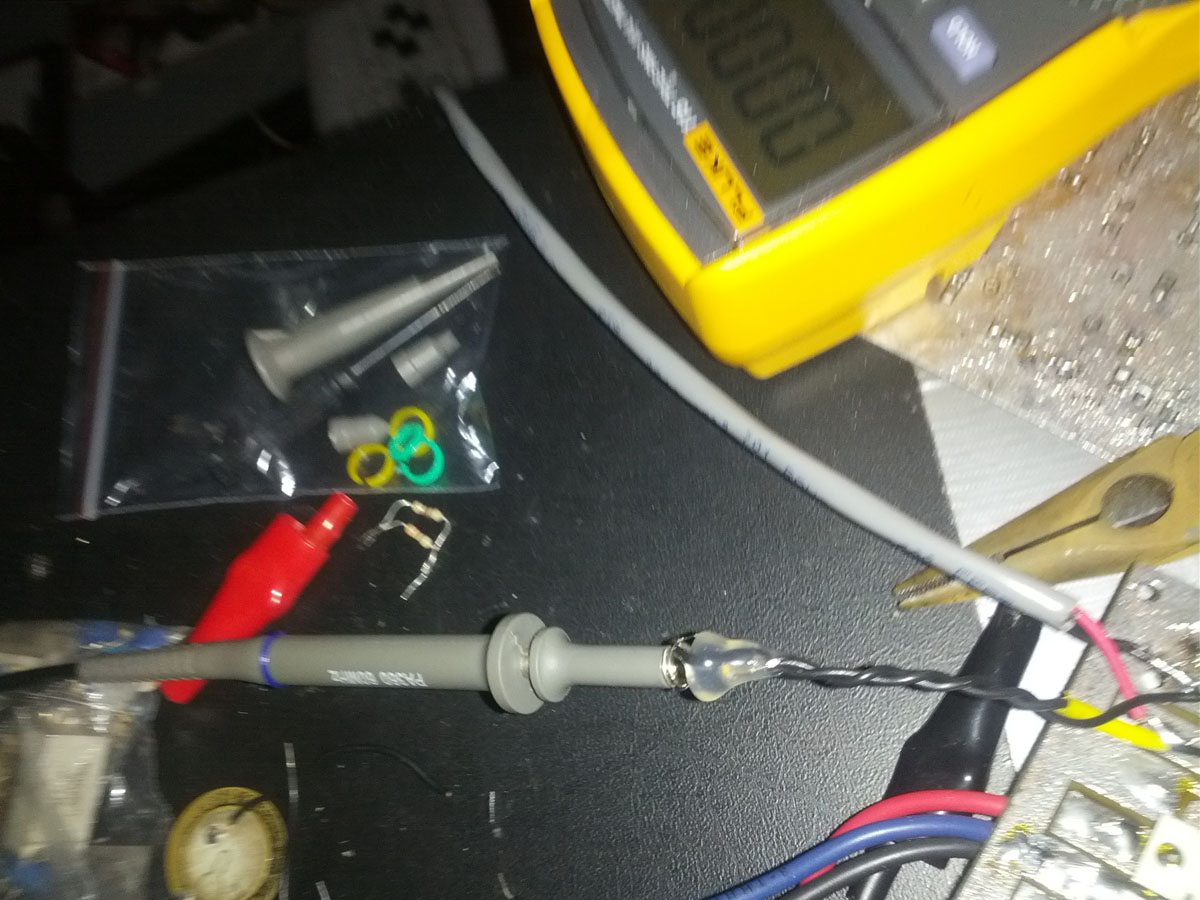

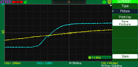

I tried my best to make my probe less inductive (image 1). I would be willing to hack it apart but after i find a supplier that sells probes that will work with my ATTEN.
I couldn't find any info on the probe it self but the scope manual claims the input of the unit is 1M 17pf +-3pf. (60mhz unit).
I tried switching btw 1x and 10x but it did not see a noticeable difference.

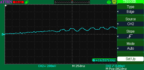

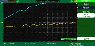

Then i started placing a 1nf ceramic cap across: (image 2 is without)

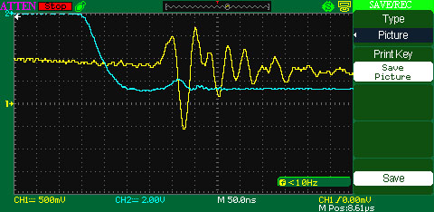

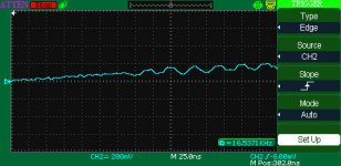

-Lower Fet drain source, no change. (image 3 change in amplitude is due to different output volume)

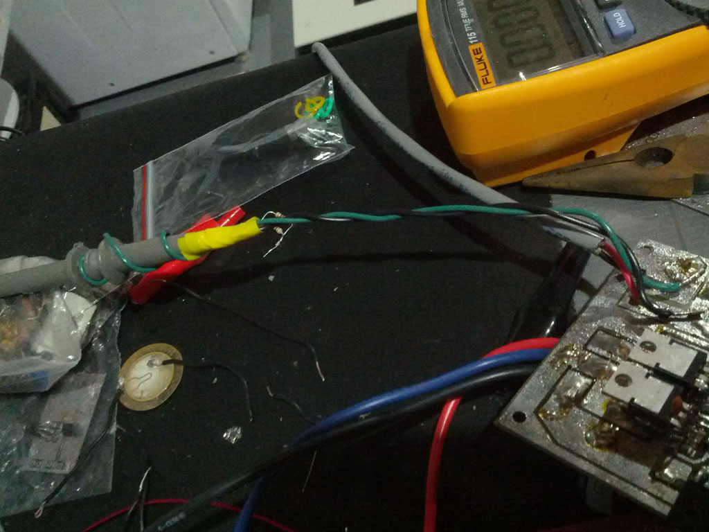

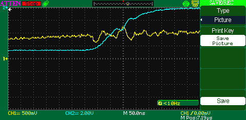

-Output filter Cap, little change. (image 4)

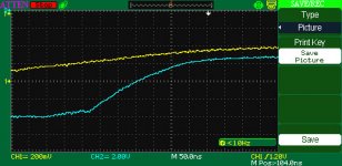

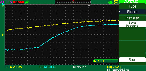

-Output filter Inductor, massive resonances at multiple frequencies (image 5,6,7)
I'm going to guess the ringing is, in part, the OFF-state transistor's junction capacitance and lead inductance forming a resonant stub. Only thing you can do is dampen it (not really room to install ferrite beads that'll cook anyway) or slow down the gate drive.

When I place a 1nf ceramic across the lower fet shouldn't I expect a change in frequency? I didn't measure any change.
I tried my best to make my probe less inductive (image 1)...
Why is it soooooo long? Why don't you use the GND ring next to the tip? Why didn't you try measuring the reference point?
BTW: probe (GND) inductance causes less problem, if you can filter the common mode current.
Square and trapesoid signals both have unlimited spectrum (the slower the transition, the less the HF content). Something resonates to it, or picks up higher freq content. This can be the probe+scope, and/or the parasitic elements of LC filter (and PCB). If you can exclude one, the rest is to be blamed.
I was trying get around soldering directly to the tip of the probe so I have to use the clip (the clip covers the gnd ring) but I think I'm going to suck it up and try it. Does anyone know a good source to buy scope probes? Its an atten ads1062cal.
