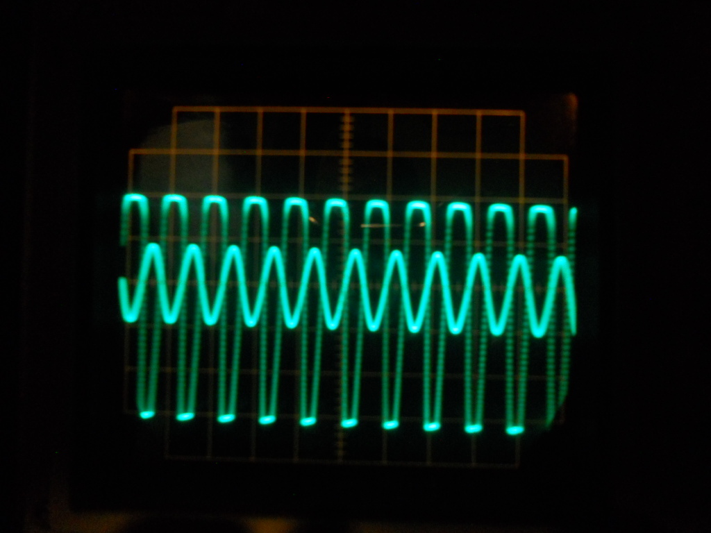

I want do check my amp to determine if I'm getting HF oscillations in the power amp section. I have a BK 20 mhz scope but also could pull out a 60 mhz Tek if need be.
I've noticed what appears to be dashed lines on the lower sweep rates. By dashed lines that is to say, the trace of the 1 khz input signal is faintly broken up into dashed lines, perhaps 20 dash per cycle... This is not affecting (effecting?) the tone but I'd rather not have it. Perhaps due to the grid stoppers on the power tubes having full length leads to the grid connection; but I want to understand the diagnostic process also for future reference.
Any suggestions on the settings and what I'd be looking for? I do know the traces would be higher frequencies but don't know what sort of range or the best sweep settings.

The small signal is the input and the large signal the output? If so then you have a drive issue, either over-driven or lack of power. Hard to tell without more information.
It may just be that the scope is in "chop" mode. Do the dashes disappear if you only display one channel? Can you see things better if you speed up the horizontal sweep rate?
Scope is in Chop Mode
Yes the scope was in Alt A+B. That makes sense. As for the power supply limitations, I believe the driver stage is being over driven by the input. It appears as the amp approaches Full Metal Racket!

If you had high frequency oscillations it would be obvious with noise on the sine wave output.

Sine wave peaks, and square wave "corners" are the most common places to see bursts of high frequency oscillation.
