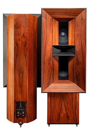

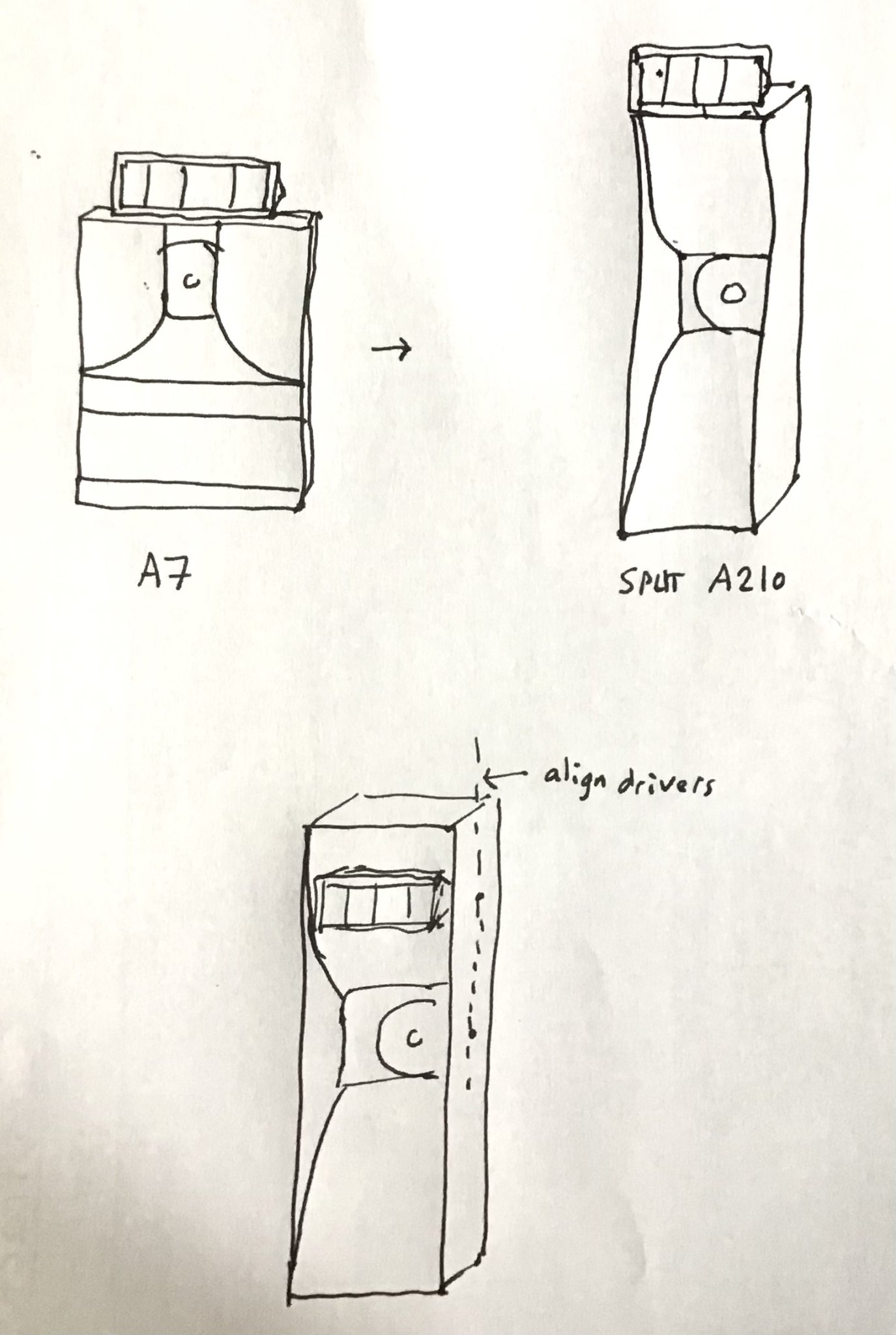

Was looking at all the interest in A7 VOTT and saw some work on ‘split‘ 210 cabs. I think the taller vertical horn (split 210) might be more home-friendly as well as having a lower cutt-off. But it pushes the hf horn far away from the mid-bass driver which must be bad for anything other than a huge room in terms of integrating the sounds at the listening position. So why not embed the hf horn into the curved wall of the mid bass to narrow the gap?
Yes, a good option if centered in front of the woofer (rear of CD can be quite close to 'taste' to act as a crude phase plug) and rotated vertically to match polar responses (wide horizontal/narrow vertical) now that DSP can time/phase align them and experiment with XO point from 800 - 1600 Hz and of course 'stick a sock' over the CD to quell reflections back to the woofer and at least a damping strip on one parallel side opposite the woofer (personally covered all of one side with my dual driver ones) 😉.
If wanting to vent the woofer, then vertical slit vents down each side in the bottom flare ala' Synergy concept if small, otherwise horizontally across the bottom front or both ends as these folks do.

The horn acts as a crude plase plug, so need to damp the CD to quell any reflections back to the woofer, but otherwise the XO is going to be well below this BW, so moot WRT altering it's upper mids response.
It depends. However, at this stage there's little rhyme or reason to your horn choices and knowing what you find most important about horns would help you make those choices. It takes time, and compromises need to be identified and balanced. For example just one of those compromises that springs to mind is you're talking about getting them close, where the sectoral horn has a short vertical dimension and this raises the crossover frequency and shortens wavelengths.in terms of integrating
Yeah, as I previously noted, the 811 needs to be vertical to ~ polar match them, i.e. narrow vertically, wide horizontally.
