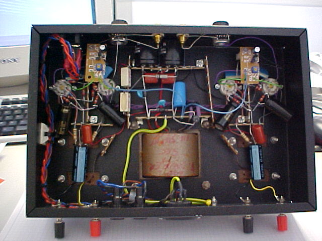

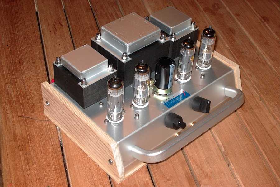

Knocked it up last weekend with mods as below:
1) My power supply was a bit high so I cathode biased the output - individual 390R cathode resistors bypassed by 470uF/50V Blackgate standards.
2) 20% Ultralinear Taps connected via 150R screen resistors
3) 1K balance pot between the input triodes cathodes with wiper fed by a 1.2mA ring of 2 BC547B current source
4) No global feedback (Zout = 3.2 Ohms)
5) Did'nt have the separate 13V winding so just rectified the heater winding to give approx -7V for the current source supply.
Note: I could have (but did'nt) voltage doubled the heater supply and then used fixed bias on the outputs (about -11V required with V+ = 310V for 28mA idle) using NOS Philips 6GW8 (ECL86).
Sound is quite lovely. <10Hz to 35kHz -3dB points at 1Watt which given the quality of the trannies I had was amazing. (Ex an old Heatkit, originally driven by 6BM8s with 250V rails). The shunt feedback is doing a great job. Output a clipping 10.5 Watts.
A good "newbies" project.

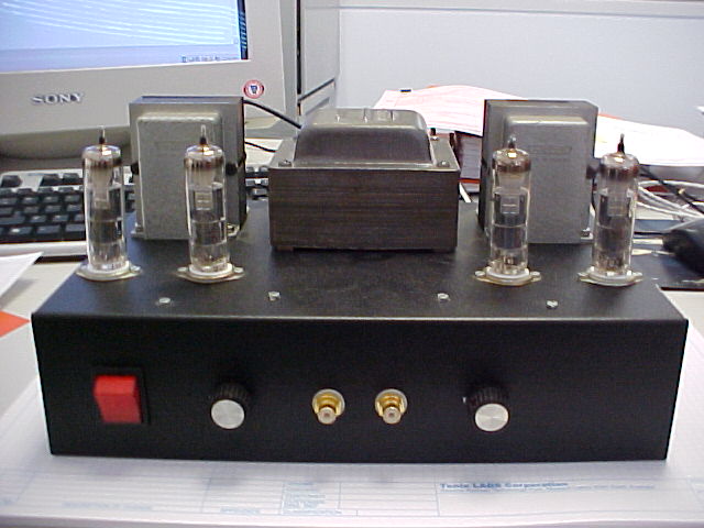

Mine looks like that :

Tekko said:
That thing looks like it will induce loads of crosstalk btween channels.
Never thot of that, in a set of PP OPTs how serious would this actually be?
All the Nordmende OPTs come like that... it is convienient for mounting... i'm also going to be using paired sets to do some SE parafeed amps. They are very well made.
dave
Not very serious Dave.
1) As you say DC flux is null in a PP and the AC is not that great either.
2) Distance between the cores is not that different than what Yves 's got.
3) Engineers at nordmende know a thing or two about electronics.
Easy enough to test by putting an AC voltage in one of the trafo coil and see what you get on the other transformer.
You can play with level and frquency to your satisfaction. Remember to use proper loads in the proper place so that you get some flux going.

I've been running this little amp for about 2 weeks now and am simply amazed by the sound quality - especially the bass strength. The amp is lightening fast and very open. The balanced shunt feedback scheme is (I'm convinced) doing something special. The 2 x 47K plus the 12K is adding some self balancing (AC balance) as well as lowering the rp of the output tubes which no doubt helps to better drive the modest primary inductance of the "cheap" output tannies. I also think the 20% Ultralinear I use is probably worthwhile compared to the straight pentode arrangement of the original circuit.
I'm so impressed I'm going to try scaling this up to EL34/6550/KT88. I've put aside my 845SET while listening to it and believe it or not it suffers very little in comparison - in fact its a lot more open and less "covered" than the 845. Considering that I could build 10 of these for what the 845SET cost thats saying something.
Anyone considering building a 6BM8/6GW8 or even EL84 based amp then I cannot recommend this design highly enough. I recommend you include the front end balance circuit and the Ultralinear connection discussed in the original post.
To reiterate something I said in an earlier post - This is a great amp for a first project for "newbies" to tube audio - the only trouble is that where most of us build 3 or 4 amps before we approach this sound quality you'll have it from day 1.
Its also a great project for the more experienced of you - like me, you'll wonder where the sound quality is coming from.
Ian

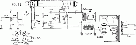

Here is a schematic for an SE 6GW8/ECL86 with tone control. I plan to eventually give this one a try.

ECL86 diagrams
Thanks Guys:
I will study those two diagrams. I am interested in a pretty simple amp that has had the RH mods done to it. As I am a very junior amp guy I guess I need a bit of close on supervision. I will keep in touch with my progress.
I guess I need to come out of planning mode and try to make an amp to match up with my fleet of Fostex speakers.
Boy this is fun
Scott i have a diagram of a fairly simple one that i was going to simplify further and add RH too... that is what you likely want to execute.
I just read the peter Wednt article i posted the URL of -- it is interesting that he was using the plate to grid feedback (ala RH) in that one. The grid leak boas on the triode is not best, but all the stuff in the CSS on the cathode of the pentode is interesting if you can't get reasonably well matched tubes (you'd want to get a working amp before you added that guilding thou)
