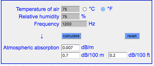

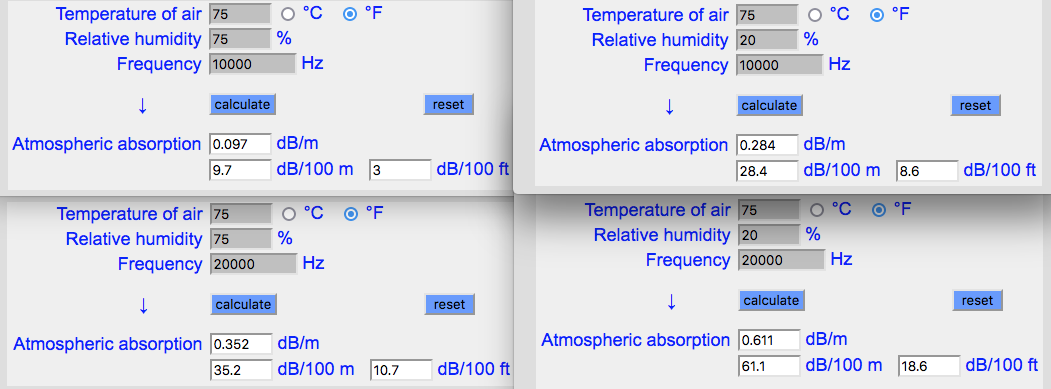

The VHF is always a limiting factor at distance due to atmospheric losses in addition to inverse distance losses. At a football field distance, the SPL delivered above 10kHz may drop between 10 and 60dB compared to frequencies below 1200Hz, the typical lower range of a high frequency driver in a line array.i guess it depends on how you define "high" frequencies.
and according to that write up ( which i believe ) line arrays start to run into issues above 5 khz or so ...
you can EQ the HF if the system isn't at the limit.
Obviously, the high frequency system transducers can't handle several orders of magnitude more power, so we live with the losses.
https://sengpielaudio.com/calculator-air.htm
As evident in the above calculations, humidity and temperature make huge variations in losses.
When I first moved to the high, dry desert conditions of New Mexico from the humid summers in Minnesota, thought I'd lost my hearing when I started mixing again, the VHF was literally less than half as loud at 100 feet than I was used to.
