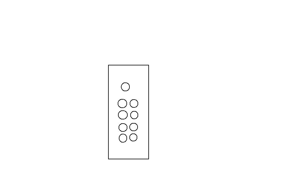

OK so what I've decided to do is use 4 of the Silver flute 5" per side ( I have 14 laying around) and wire them in 2 pairs paralleled and those pairs in series to get me about 91.5dB +/- and with the FF85K being slightly less efficient I wont have the urge to want to pad the FF85K. I've also opted to run them at 200Hz crossed 6db on the FF85K and second order on the midbasses. I should be good down to the 40's with the four 5" midbasses and in room well below that.
Now my main concern is getting an acceptable baffle width that will support 200hz and below without suck out from the FF85K and still be somewhat W.A.F effective. So I guess what I should be asking is what’s my minimum baffle width allowable for the FF85K OB. I'd love to stay 8 inches wide or less but having little experiences with OB arrangements I'd like some input her if at all possible.
I guess I could do a MMfullrangeMM configuration and leave the back of the FF85K section open at the back, but I worry about reflections off the cabinet, I guess I can guess as much as I want but I have to get down to some serious thinking here, Peace and happy listening.
Speaks
Speaks
