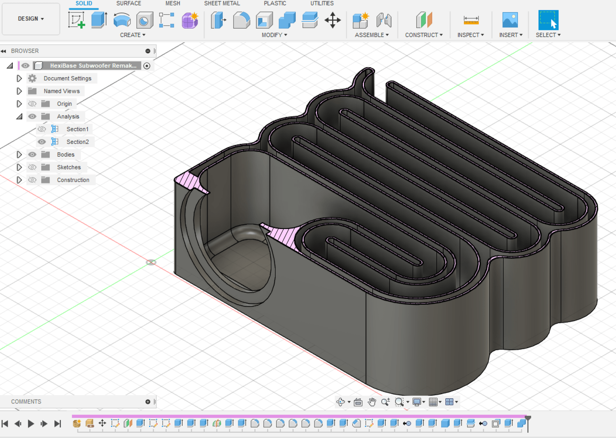

I ordered the Tang Band driver, finished my HexiBase redux design:

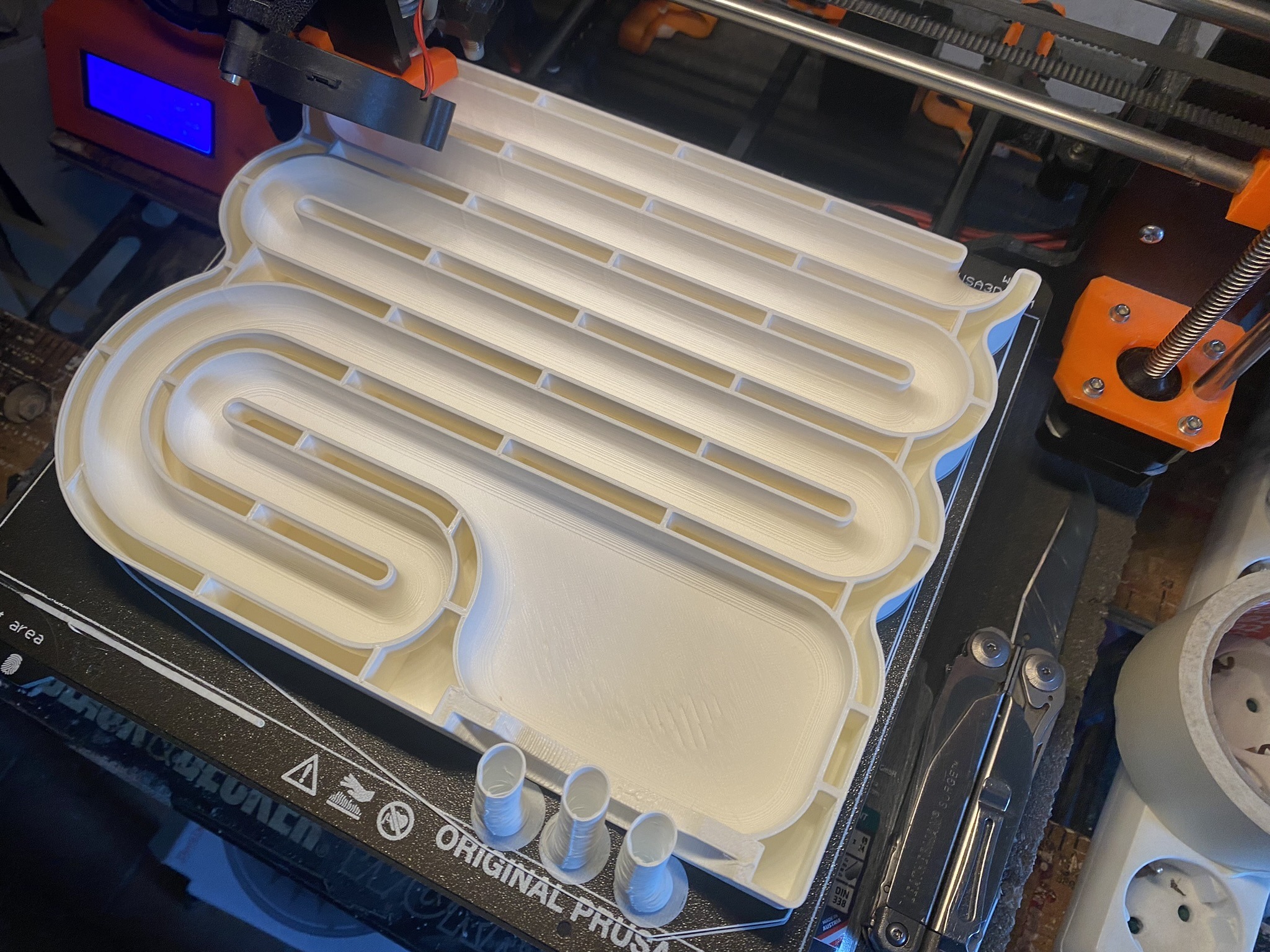

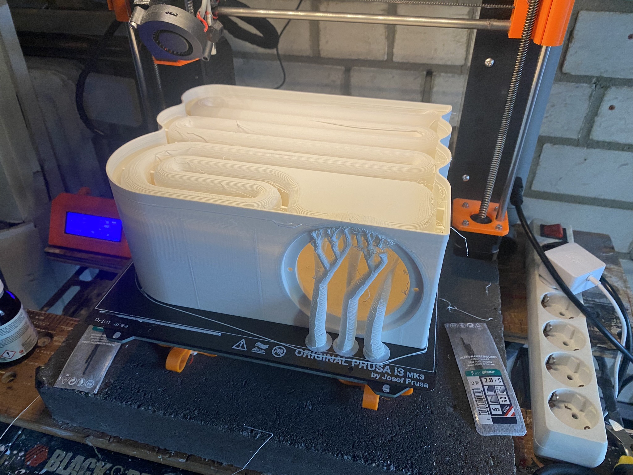

And kicked off the 3D print:
It took quite a while (39 hours), and it's far from the cleanest 3D print I ever did, but eventually it was finished:

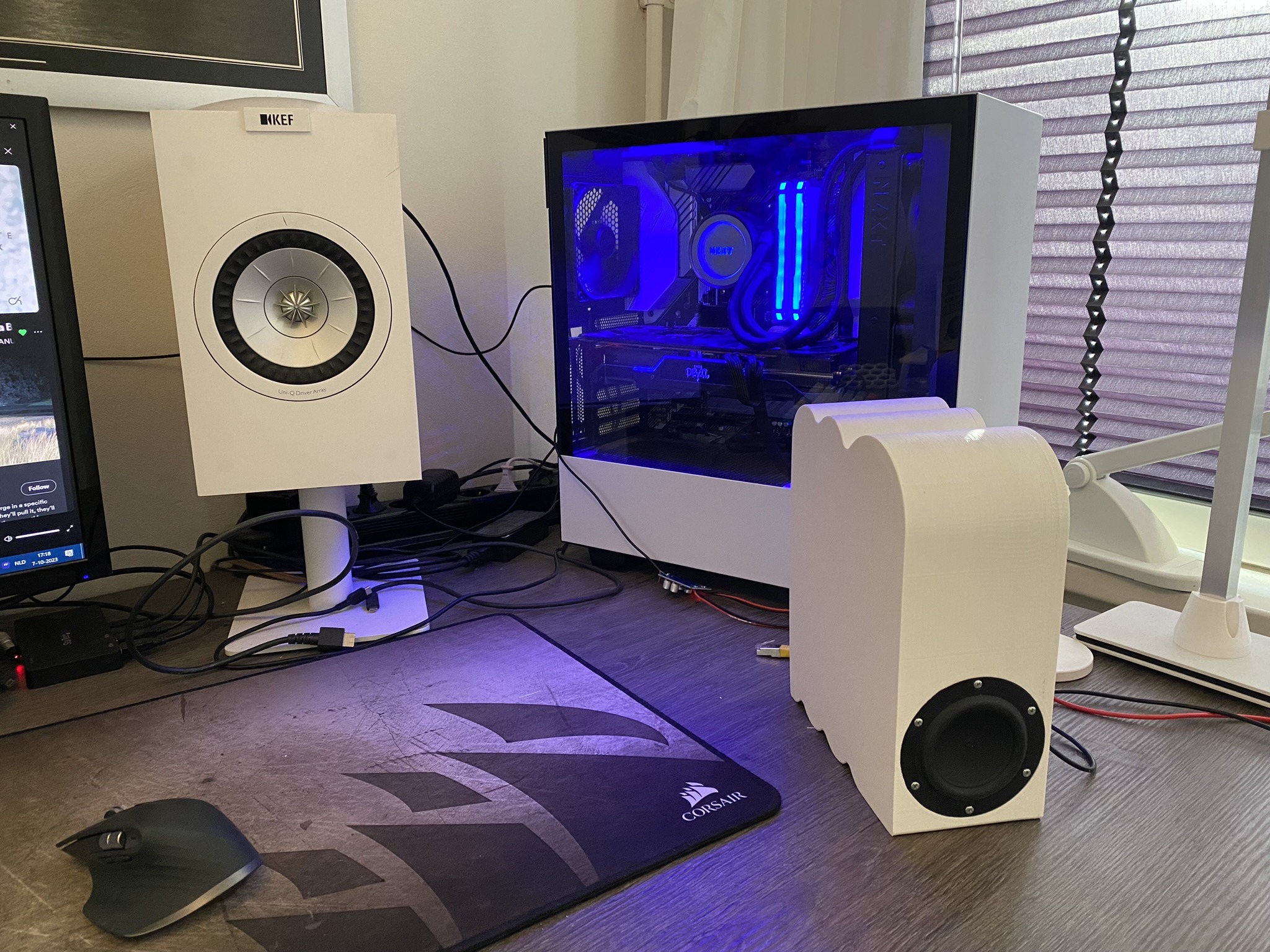

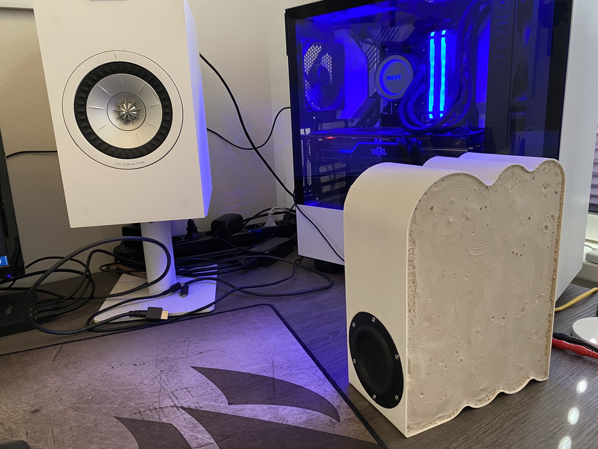

After a test-fit to see if the driver actually fit it was time to fill the enclosure it with modelling plaster. I used the orbital sander in the background to vibrate the enclosure while pouring to convince any air-bubbles to move to the top:
And here's the sub after curing in its natural habitat:
And this is what the plaster-side looks like:
This is a temporary setup, since I don't have a 2.1 amplifier, or something similar. Not entirely sure what I'll do yet, but right now I'm investigating a Teensy-based DSP + I2S DAC. I don't have any measurements or anything, but even with this temporary setup I subjectively get a much better bass sound than with just the KEF Q150's I have.

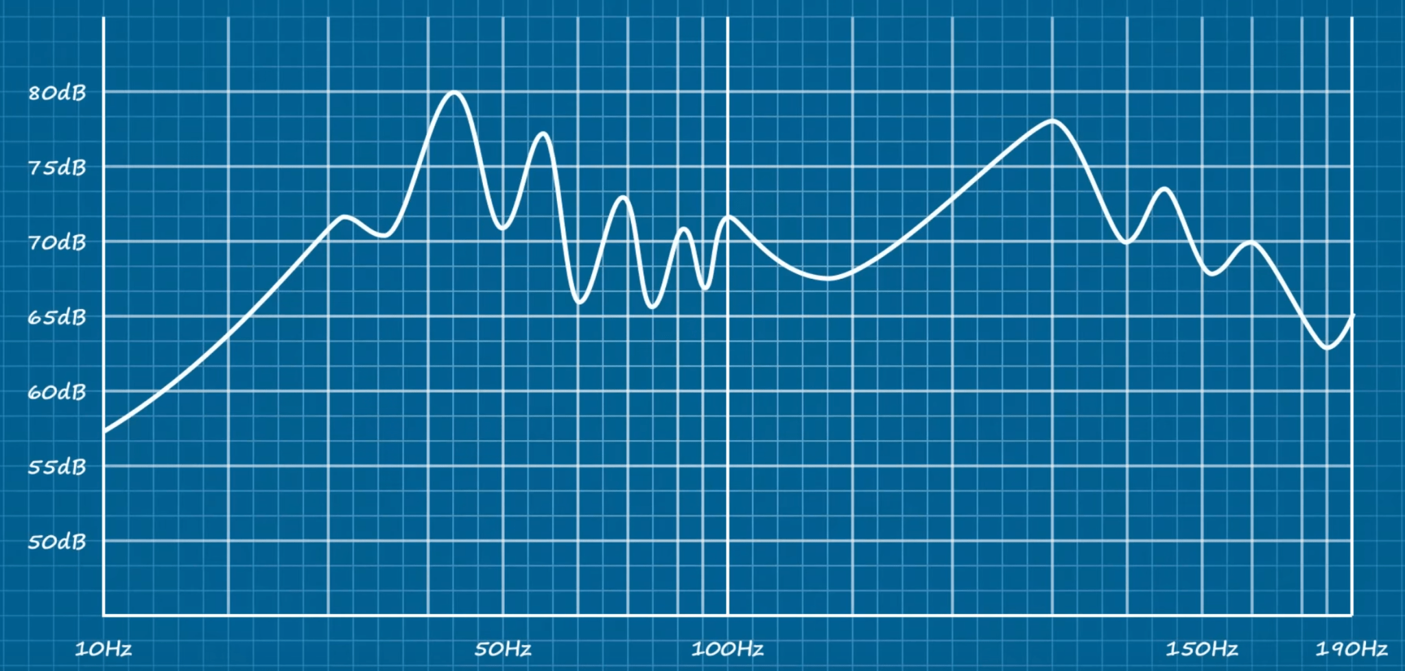

What’s the freq response (simulation) look like for that transmissionline?
I didn't do the simulation myself, but in his original video HexiBase showed the below graph, produced (I presume) by BassBox Pro. Note that this was made based on the driver parameters he measured himself, since the specs provided by TangBand didn't validate:
See HexiBase's video for more details:
