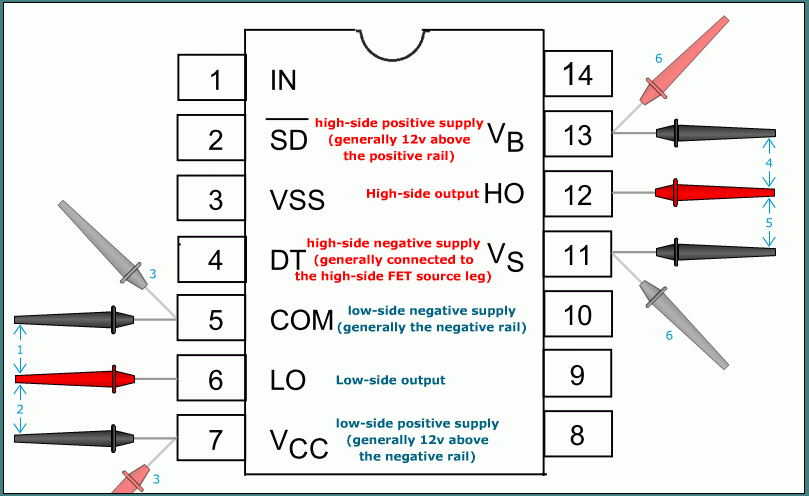

The layout for the IC below is different than yours (IRS20957) but the pins are labeled the same. Check each of the two output sections to confirm that neither has any leakage or shorts between the pins.
Even though this is a new IC, it's possible that it was damaged when installed. All should read in the M-ohm range. If you read anything significantly lower, compare the readings to that of a new (uninstalled) IC.
