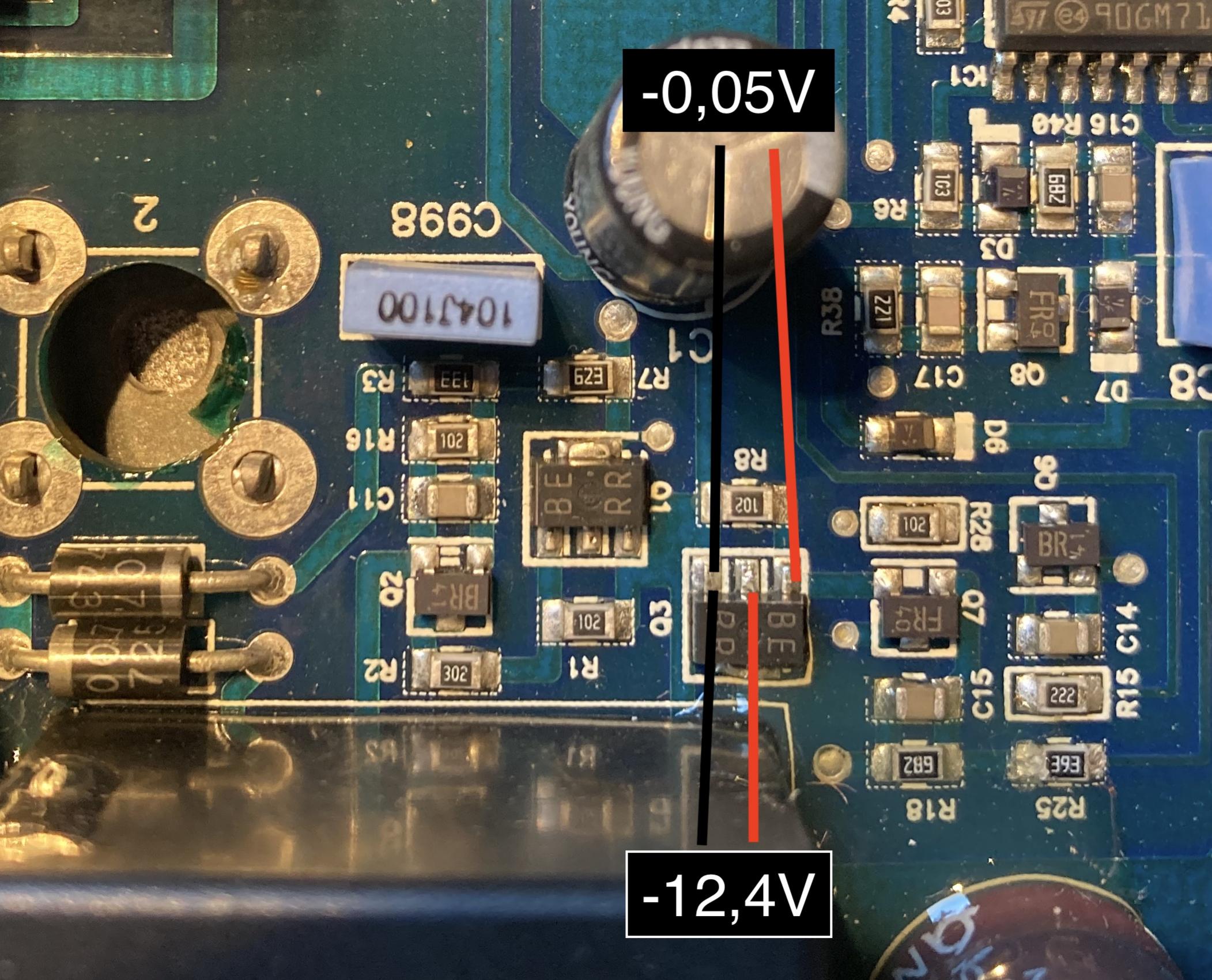

Haven't been working with amps for years but a friend asked me to look at his Hertz EP1D.
Amp's relay does not engage, DC protection kicks in, that means that protection light is not on but the relay is not engaging. Relay is in working order. I checked by applying 12V to its appropriate terminals. Tried to measure voltage on the transistor supplying 12V to the relay while amp was running, when measuring the relay engages, DC on speaker terminals on that moment was 0,5V. Tried playing music through speaker while holding relay open, plays fine, no excessive heating. While relay is not engaged before the relay there is good audio signal, it is just not getting through the relay.
Anyone got a clue what could be causing this problem?
I think I got it right, little illustration:
