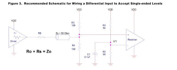

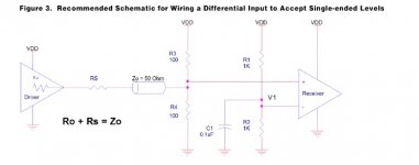

But, there’s a little problem concerning CS. It’s not enabled in Dam1121, as far as I know.
Another problem is the CLK in of the dam 1121, this is a LVDS not hcmos.
So, I’m thinking of using Cronus’ MCKL out.
Are the new buffered MCKL out of the Cronus in CMOS?
If so, could I use the connection scheme from diagram below or should I even drive a translator?
Thank you very much!

I guess you need to use Hermes-BBB + Cronus (with clocks) + Dam1121. You cannot use clocks from dam, because you are not able to control its frequency, and also its manual states it is very sensitive.
If you do not need 44.1k rates, then you could omit Cronus and use just internal 48k clock on the BBB (snd_soc_botic.ext_masterclk=0).

I know it’s a Hermes thread here but,
In a Setup where Cronus is a clock master, dam and BBB are slaves,
do you know what type of output the MCKL of the Cronus as Clock master (with two clocks) is? Because the Dam wants LVDS signal, that’s why I’m asking if the above posted scheme for a simple CMOS to LVDS translation is possible or if I should get a translator/buffer like this one : https://www.idt.com/document/dst/8p34s2102-datasheet
Thank you Miero, you’re a big help here!!!
