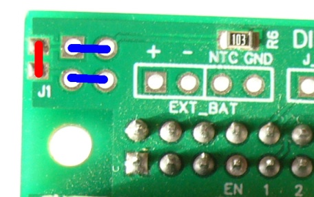

I haven't used battery with Hermes-BBB so far and going to use it. I've ordered 062535 battery and waiting for delivery. Unfortunately I am not sure how to arrange Hermes jumpers to allow automatically battery charging. Please advise me.
Will it be OK If I connect 3 jumpers as I marked in enclosed photo?
bern,
only J1 in the picture gets shorted - the four pads to the right are for the header which connects to the corresponding test points on the BBB. The 2x2 headers were supplied with the kit.
That's all you need.
bern,

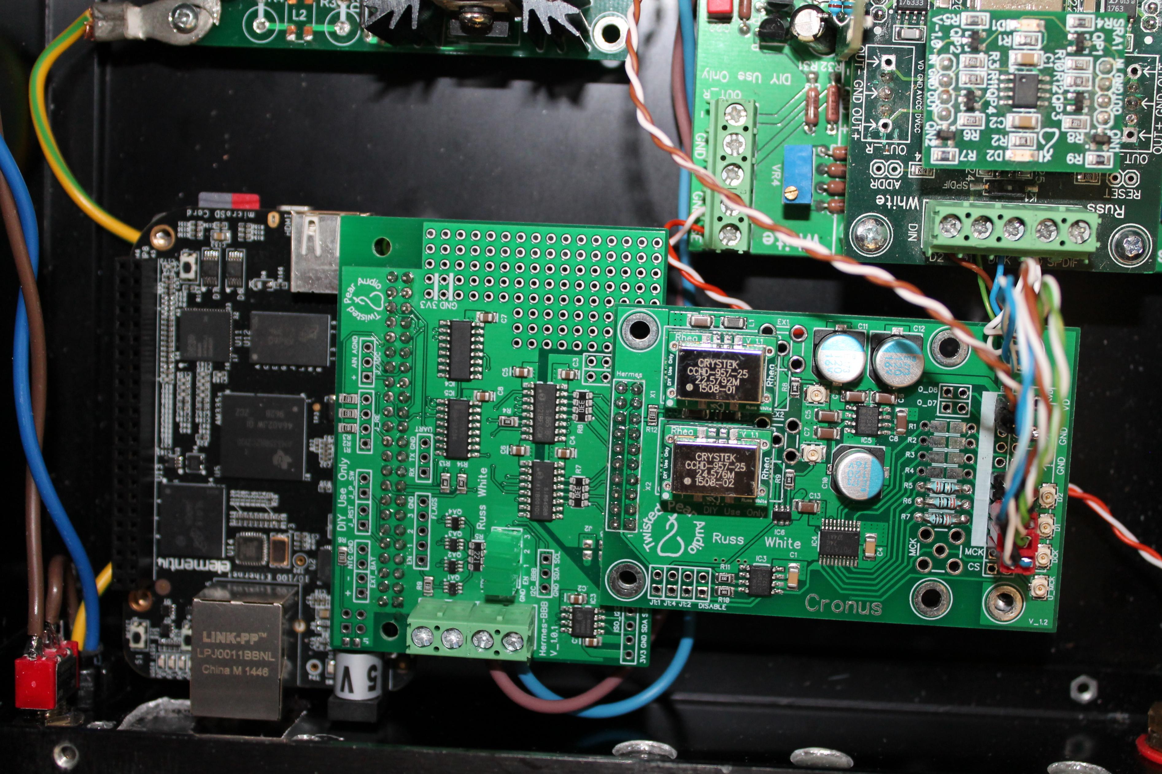

Problems attaching to Bufalo II
Trying to get BBB/Hermes/Chronus working with a Baffalo II and having problems.
The "lock" LED remains off and the "Mute" LED on while I try to play music via Squeezelite. All normal LEDs light and everything looks OK but not locking.
I have tried a USB to I2S converter with the BII and that sets the Lock LED on and produces music so it seems the issues is with the BBB/Hermes/Chronus side.
Using the latest V4 Botic SW making no changes to default options. I have a couple of other BBBs with external oscillators running the Botic SW so fairly conversant with how to run the SW.
Have checked everything I can think of, all wiring double checked (not that that means I haven't made a mistake), checked oscillators are getting 3.3v.
Any help or suggestions greatly appreciated.
Pic if thats any help.
The I2S wires are 10cm at the moment to facilitate testing, have tried shorted ones to no avail.
