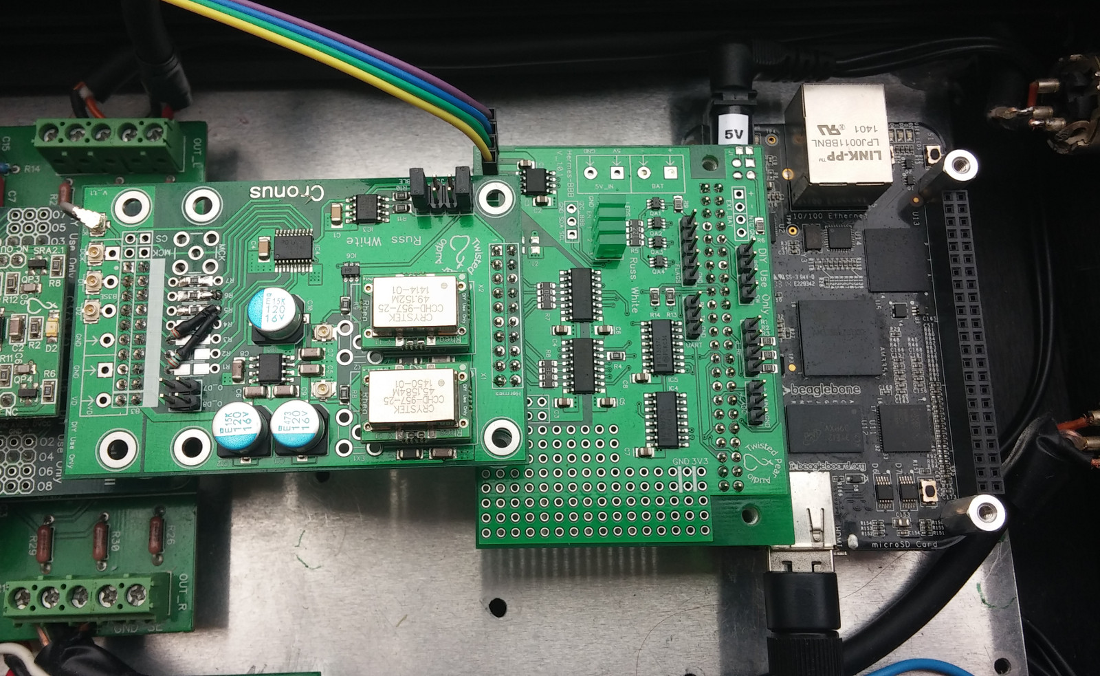

My build with Buffalo 3:
- DAC in synchronous mode
- stereo with "smart wiring" done on the Cronus; there is 3rd resistor on the other side
- BBB as I2C controller for ES9018
- BBB powered by LCDPS with shorted R3 to increase provided current
- installed headers for connecting peripherals (these were not part of my kit)
- (temporarily) disabled clock divider and BBB configured to 45/49MHz clocks
- USB WiFi adapter for network access
What are the 2 extra resistors you installed for?
Good picture, I love good pictures.
He is doing the remapping of D1/D2 that you can already do right at the B3 - he just decided to do it at the Cronus instead. Note - if you are going to use the B3 in stereo remapped (with jumpers on the B3 joining data channels) only place resistors R5 - R7 on the cronus so that you don't short anything. Then you can play stereo PCM/DSD as normal on the B3 in remapped mode.

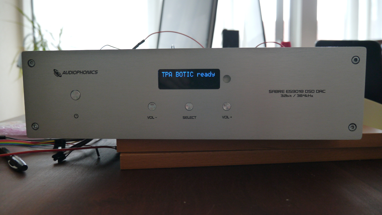

I found a suitable 16x2 OLED which fits my off-the-shelf case and works nicely with the BBB.
Now I can let the BBB report progress on booting and show song info 🙂
Nicely done. 🙂
