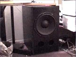

Im using 2 jbl 12gg01 subs
here are the specs on the sub...
jbl 12" 12gg01 subwoofer
neoprene surround
2" kapton 4 layer voice coil
40 oz ceramic magnet
price $40 CDN ea.
Power: 150 watts RMS
Re(ohms)5.30
Z(ohms): 8
Fs(hz)24.80
Le(mh) 3.44
Mms(g)97.81
Qm 8.14
Cms(mm/n)418.47
Qe 0.331
Rms(Ns/m)1.88
QT 0.318
Vas(L)164.30
Xmax(mm)4.20
Sd(cm^2)0.053
BL(Tm) 15.18
EBP 75.00
EFF(%) 1.92
SPL(db) 91.00
Each sub in a 3 cu. ft vented enclosure dual ported @ 32 hz..
Currently, i have 120 watts rms power running to each box with the boxes located on the left and right side of my desk with me less than 2 feet away.
