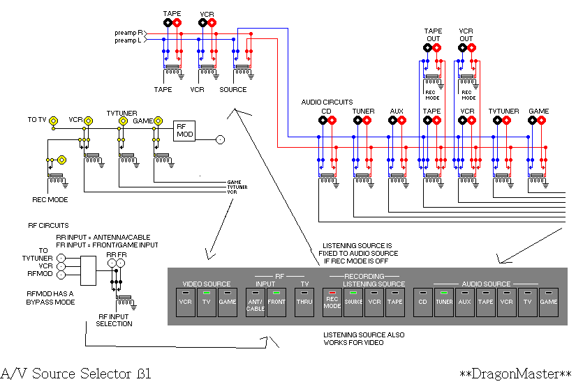

Here's a source selector
The attached file is the beta version of my source selector.
I'd like to know if you have any suggestions for future-proofing or to reduce the number of components. If there are corrections to bring too.
An important thing to add would be a DVD-player or HTPC input.(The scheme is built for my current setup)
The only future-proofing features that I have right now are :
-Stereo VCR inputs and outputs ( My VCR is mono :down: )
-TV tuner inputs that will be used for the Magnavox TV tuner from alltronics.com (To get stereo TV)
