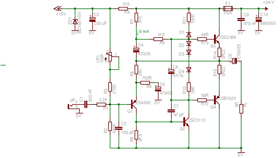

But look what you can do with two of them:
VR2 controls the current in Q3, which controls the current in Q1 and Q2, which control the voltage drop across R5 and R18 (bias).
It might be better to make R26 variable instead, I'm still thinking about it.
Here's my variant, with an additional PNP input transistor (topology derived from JLH).
Q1 can be just about any small signal PNP, like BC558/559/560 etc. The VAS transistor is fairly critical - selected BC550c with beta > 500 should be ok, but I prefer the 2sc3112 with hand-selected beta > 1500. Q3/Q4 can be just about any power-darlington pair - choices include Sanken 2SB1620/2SD2488 (hard to find, but about the best), TIP142/147, BDX33C/34C, 2N6052/6059 (rugged and sonically open). D1,D2, D3, D4 are 1N4148.
For higher power, it's possible to increase the supply voltage to about 50V, with appropriate changes to R2, R3, VR1, R7, R9 to set the output bias point to about half the supply voltage. Gain is set by (1+R6/R8). Maximum slew rate is set by the VAS current divided by Cdom - here, it's 5 mA / 47 pF ~= 100V / usec (in practice, it will be lower because of the O/P stage base(s) loading the VAS bootstrap source).

linuxguru said:
Probably worth increasing the bootstrap cap to 100-220 uF, 50v - should improve the bass response below 30 Hz. Also a small bypass cap - say 1-22 uF, around the diode/resistor Vbe bias chain should improve the highs.
A small miller capacitance of around 33-100pF between the base and collector of Q1 should help suppress AC instability.
I've built something similar to this, but with a Vbe multiplier for crossover biasing, bias stabilization resistors of 0.2R in the emitters of Q2 & Q3, and 2N6054/59 TO-3 output darlingtons.

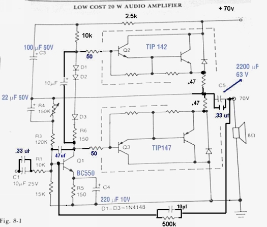

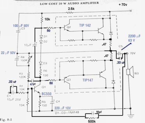

Hi
I did some mod to the Fairchild amp for more power, is it ok ?
Where can I place a phase lead capacitor in that circuit ?
Thanx

gee, add a diff amp before Q1,and run it off a split supply, and you basically have the same amp denon, yamaha, and pioneer use in their recent surround receivers. i think harmon kardon does that too, using darlingtons for the output devices, eliminating separate driver transistors.
Sony does that too, with Sanken Darlington outputs and a proprietary analog IC input stage which has everything except the Vbe multiplier, which is a discrete Sziklai.
I'd second the recommendation of either an LTP or single PNP before the VAS - it provides a significant amount of open-loop gain which can be traded off for lower distortion.
Apart from that, the mods look benign, but I'd advise simulating them to see what their impact is.
