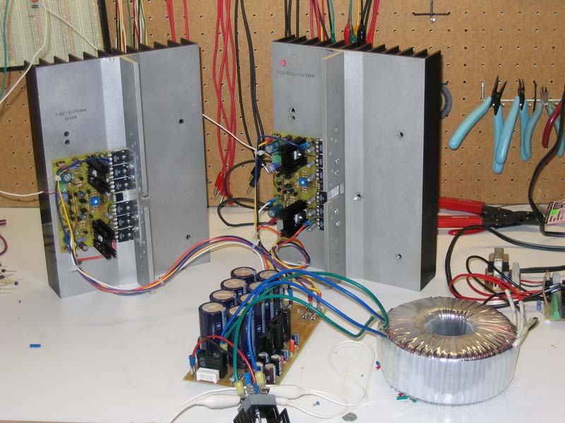

I'm using a Antek 500VA 2x30V transformer at 1A DC current operating point at the output transistor for each channel.
Full output into 10 ohms is more than 60Vp-p, so at 8 ohm this give 56W rms. The rise time and fall time is 2 us using a squre wave, 60Vp-p into the same load.
I'm very happy with these amps, the only bad thing is that my heatsink aren't big enough the dissipate all the power generated with a 2A dc operating point. So that's why I'm using it at 1A for now.
Here is a picture of my current setup.

Q5 and Q19 are the drivers. They run at about 3mA with the values shown. In this configuration you can happily run them with a current of up to at least 50mA. This will give you much cleaner drive of the outputs. R40 should also be paralelled with up to 1uF of PP cap. I was referring to D1 and D4, not the LTP zeners.
Regards
Roar

AndrewT said:
That's why I asked these questions, but he is intent on ignoring the message I am trying to impart.
I'm not ignoring it, but I don't like to answer questions when the answer is under your nose. Well, since you are all trying to help me, I will try to answer your questions.
- what bias are you running the Input LTP at?
Not sure what the LTP is, but the JFET are biased at 1mA each.
- what bias are you running the VAS at?
Not sure what the VAS is, but there is 20mA flowing thru Q22 and Q2
- what bias are you running the drivers at?
The drivers bias is dependent of the output stage current, and it's a function of the gain of the output transistors. So if I'm running output bias at 333mA for each output device, the drivers bias is 3mA + 3*0.333A/45. That gives about 25mA.
- what bias are you running the output stage at?
Because of heatsink limitation, the output stage bias is 0.333A for each output transistors.
About the Zobel network, what are the main advantages of it? Is it false to think that if the amp is stable enough, fast enough and is having a low output equivalent resistance, the Zobel can be eliminated?
Thanks all.
