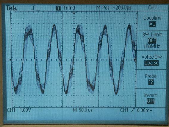

-Takashi, Your signals look bad so it should sound bad. Unless this is how a non os dac should look something must be wrong.

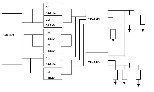

hi all,
here is the circuit diagram of the dac, supply voltage is 5V
the resistor of TDA1543 will be no problem, because i use the CRO and fine tune those resistor, the coupling cap is 100uF
and i am building a active lowpass filter and test can it improve the high frequency sine wave.

The signals look typical for a NOS DAC, except the HF noise. The noisy garbage in the signals may be related to the power supply. I hope you can show us the schematic to tackle the problem.

may not be the power supply problem
i have use 3 different LM1085-5 for ad1892, 3X74ahct74 and 2Xtda1543 seperately.
and each regulator, i have a inductor and capacitor to do filtering
and for each IC, i have E.cap and SMD cap for decoupling.
do any one have test of hf sine output from tda1543?

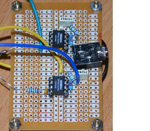

I have downloaded the filter pro program from TI and help to cal. a low pass filter, the program will show the curve of the filter, but it will not show the curve below 1Khz!
so any recommended program to cal. low pass filter?
i have follow the circuit and make a 3 pole filter, 40k cut off, but the bass have very bad sound after i add the filter. and cannot hear the high freq improvement.

I have tested my NOS DACs extensively with custom made test signals on a self-made test CD with Goldwave and a CD-recordeble. Using the apropiate frequency (997Hz?) I get a perfect square wave without ringing or HF noise on my cheap 20MHz analog Osciloscope. The TDA1543 is noisy, so a -90dB signal is allmost totally lost in wideband noise.
If it's not your supply, try elliminating some components and see what happend. For instance only one TDA1543, no reclocking, or both.

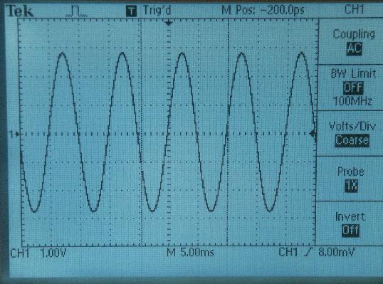

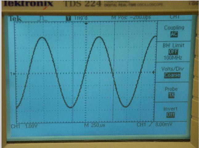

and finally, i find out what is the fault~
the 3 resistor of pin 6, 7, 8 of TDA1543 need fine tune~
and the signal is now output from the tda1543 is about 2.5Vp-p
so the singal is fine now(without any filter)
and after add the active filter, the signal is very good~

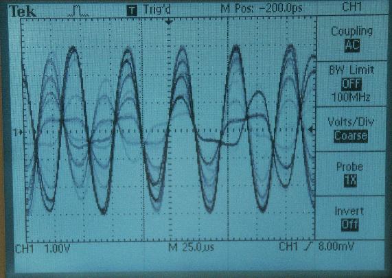

so i have done a phototype of cs8414+tda1543
i compare the i2s with AD1892, i find that AD1892 and DIR1703 have a more accurate Bclk, LRclk!
i think it is because of the oscillator that AD1892 and DIR1703 used.
