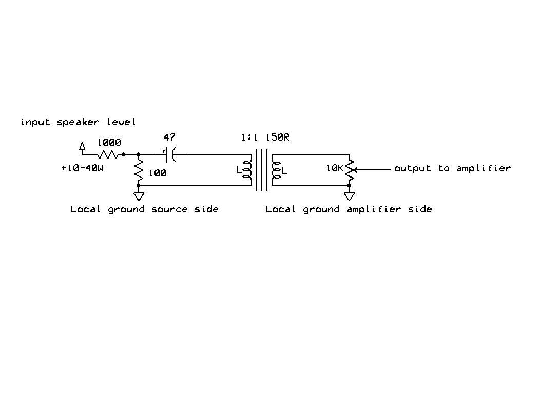

well the job is already done the only reason i placed the post is to see if other people will think alike .
As you all very well know Greece is under economical crises so there is plenty of these type of jobs which actually was carnival style street party and yes you get plenty of Mayor people or city hall bureaucrats that will release the specs with 1600 euro +vat budget take it or leave it .
So as a specialist it was a good challenge to make profit out of a job that other people didnt know how to or want to take

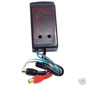

The additional cost in parts was 162 euros totally and the job was done in 2 days while in the first on of my personnel installed one cable and the second where 5 people installed about 40 speakers starting 6.30 in the morning and get the job done by 9.30 .
1000m of the most inexpensive telephone cable was about 100 euros and then 12 of the devices shown down under provided the signal . the packs cost 62 euros totally grand total 162 euro including VAT
The device originates from car stereo and its a : SPEAKER TO LINE LEVEL ISOLATED ADAPTER
it has a couple of resistors wired as a divider to attenuate speaker level signal to something lower , +one 47mfd capacitor to eliminate any DC ,+one isolation transformer 1:1 at 150Ohms , and on the other side in the output of the transformer a trimmer to match teh output to a desired level according to the needs of the various amplifiers or active speakers used .
Obviously the transformer eliminated any possibility of ground loop or noise ....
I could as well used classic DI boxes but those was working in an other gig the same day
Now the all line was driven by a hifi amplifier rated 2X60W while some 2X20W was more than enough to drive the packs and the 1klm line .
Sound was superb ,absolutely noise free and dead quiet
For your pleasure here is pictures of the speaker to line adapter plus a schematic of the internals so we all get the picture better
Happy profitable regards
Sakis

Forgot to mention that in the output of these devices we installed one amplifier and 4 speakers on it covering a distance with speaker cables then of about 100 m
When we run out of speakers in the output of the device we drive 4 active speakers and after we went with balanced cables in to out and so on
Mixing the system resolved the cable issue since part of the system was done with speakon while the rest was made with balanced so my company didnt run out of cables ( other gigs was going on at the same time )

Or someting between a line-driver and a 100V amp:
Use an ordinary small stereo amp and drive on echannel inverted. That way you will be able to drive a long cheap speaker cable which you use to feed your active speakers (maybe using resistive voltage dividers). Small series resistors at the output help keeping the amp stable with the capacitive loading of the long line. Maybe soem termination at the end would be good as well.
If there is any chance that you get this job several time I would also build a smal IC amp as line driver.
Regards
Charles
P.S: This job would be quite a bit of work for the amount of money you will get !
Regards
Charles
