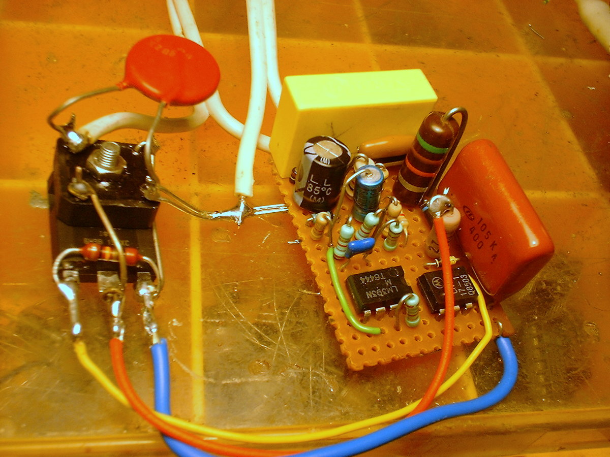

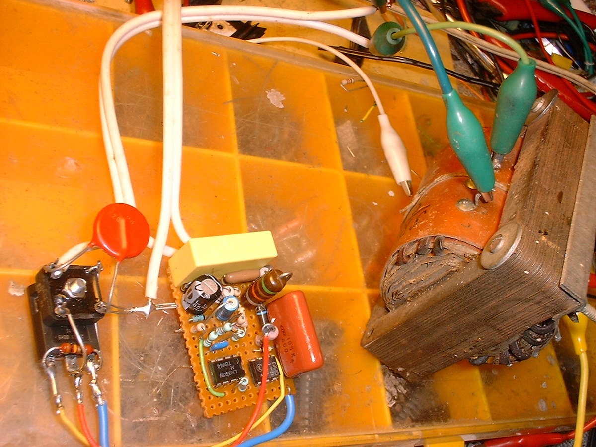

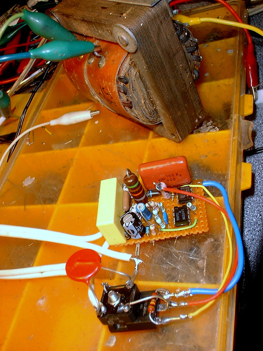

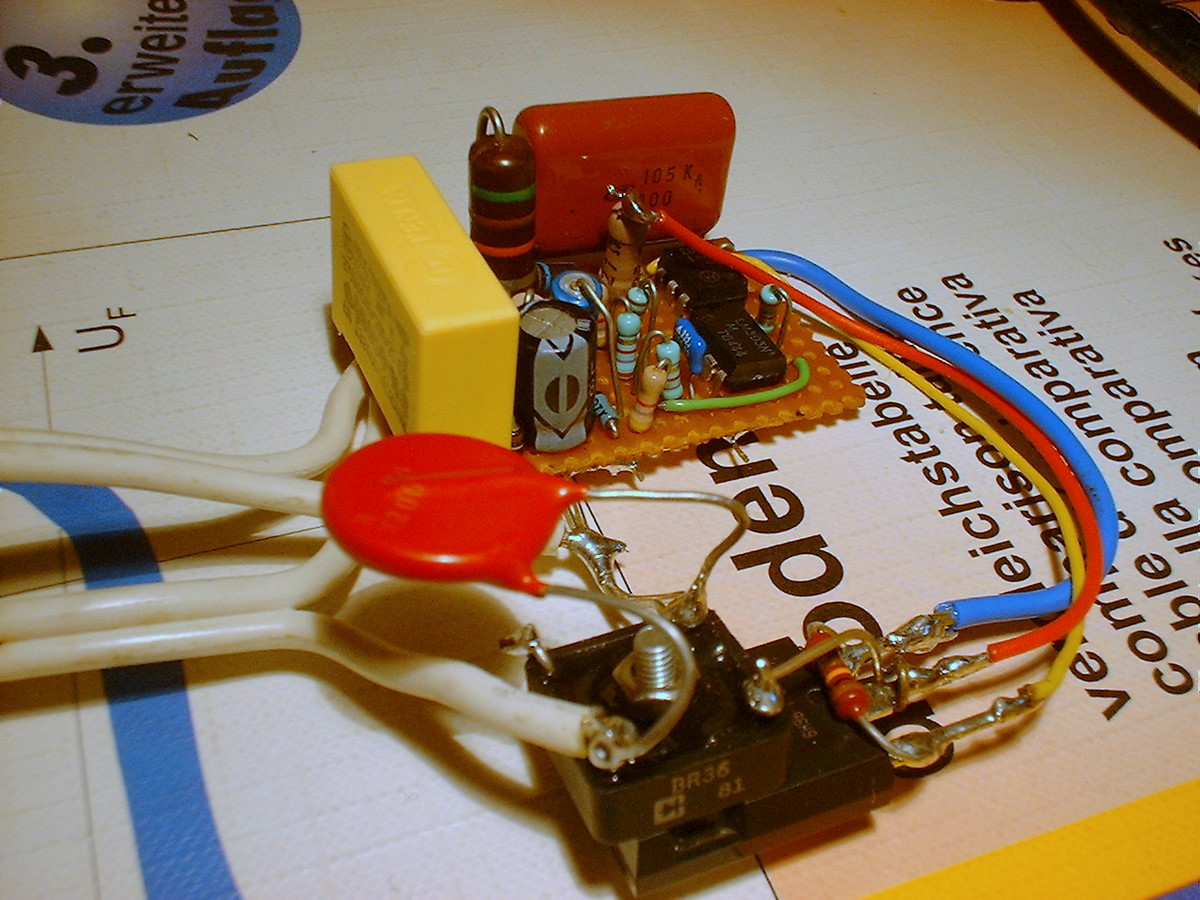

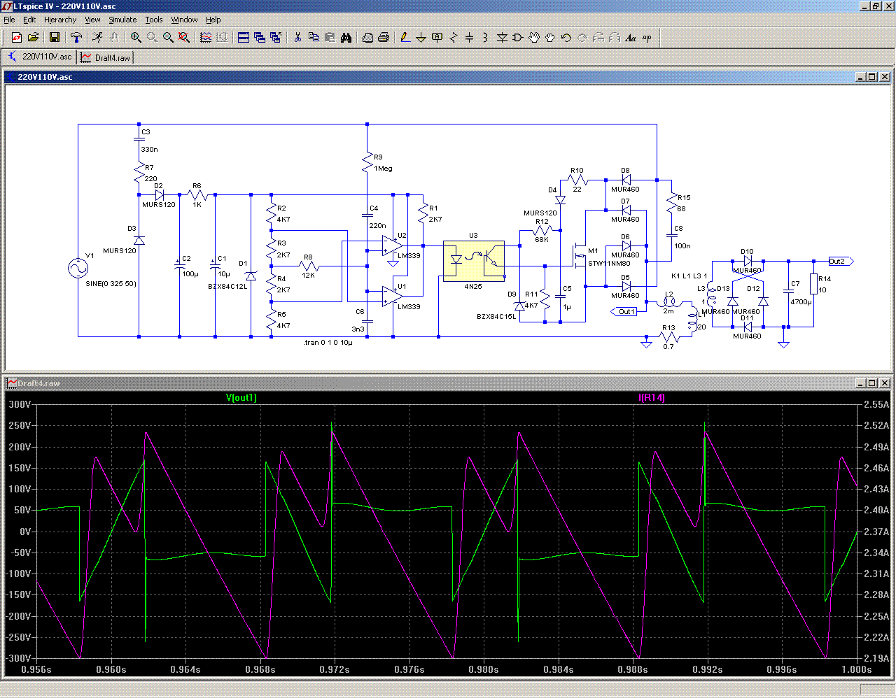

Here is an elegant (insane?) way of converting 220V to 110V

In fact, that's precisely the reason why I opted for a MOS, as it allows for a complete freedom of the control (thus frequency doubling).
In theory, forced switching with a triac would be possible, but I have never seen it implemented anywhere, which is understandable given the peculiarities of triacs.
Anyway, this circuit has no ambition of improving amplifiers, just voltage halving with some side benefits.

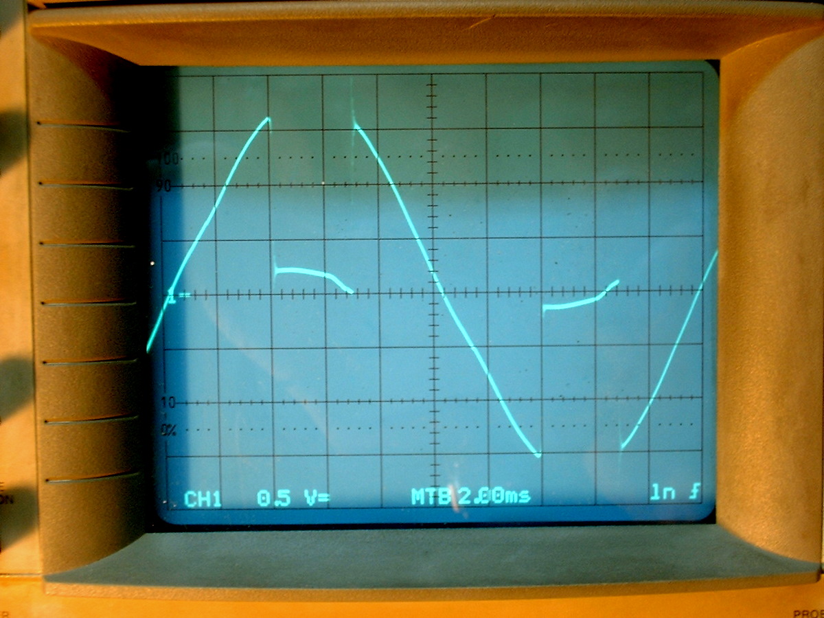

The triac is fired at the peak of the AC cycle, as the current is then available for 1/2 the time this has the same result as if the input frequency were doubled!

If you care to read the whole thread, you'll see that these issues have been adressed:
The notion of conduction angle is misleading: it is true that the raw conduction angle (the MOS conduction time) is less than 360° for a period, but in fact this says nothing about the actual conduction angle, imposed by the rectifier and the filter cap.
This angle will always be much less than 360°.
In a conventional bridge + capacitor configuration, the average output current to the load is transported through two current pulses/cycle. The actual angle and pulse height will depend on the specifics of the circuit, capacitor, transformer, etc.
If the same average current is transported with 4 pulses/cycle, everything else remaining equal, the height of each pulse will be ~halved.
The actual factor will be somewhat different, again depending on the circuit specifics, and for optimum operation the 4 pulses should be spaced equally, which won't be the case because this would impose an output voltage which will not be the target, but there will be some gain.
Regarding the energy stored in the leakage inductance, the problem has been acknowledged, and the wasted energy is partially recycled in the gate drive supply. Depending on the actual configuration, it might be prohibitive, but this also depends on the circuit's specifics.
Since there are some gains (lower transformer induction for example), it can be advantageous -or not-, but the main purposes of this circuit are:
a) to have some fun (I don't advise building it, and I haven't actually used it)
b) to change a transformer's voltage without adding too much impedance or losses

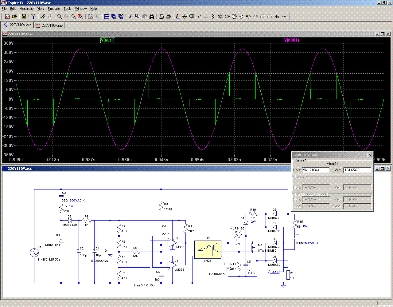

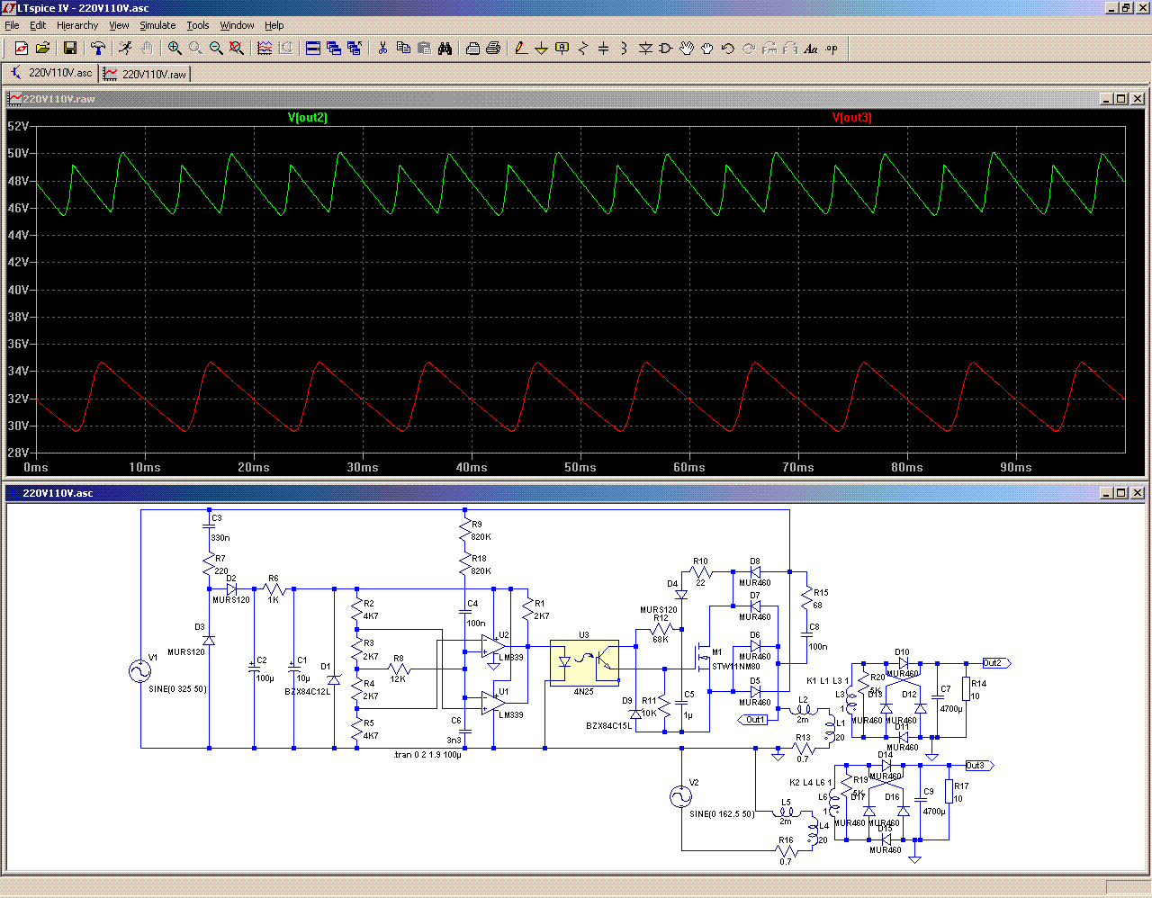

I estimated wrong. It's not 100 %. But 145...160 %. I made your homework:
Probably you are right, it will never be as low as 100 %. OK, at half load maybe
But it could have been 10% if L was placed between graetz and capacitor. With a bigger L and feedback from output a nearly perfect solution could have been made.
You sabotaged yourself when didn't want to measure any relevant things. Such as load regulation, efficiency, switching loss, EMC, real transformator parameters...

Answering is probably a waste of time, since you hate the concept so much, and won't relent until you have utterly and completely crushed and annihilated it, but I will make single and final attempt, and let the forum members judge for themselves.
First a clarification: when I talk about efficiency, I mean the ratio of useful output power to the input power, and I acknowledged that there would be increased losses compared to an ideal, passive solution:
I am also perfectly aware that moving the circuit (or at least the power part) to the secondary of the transformer would eliminate the flyback losses issue, but the current topic is about a general-purpose voltage changer, a black-box placed in front of an equipment without any other connection or modification.
The sim you carried out is punitive (unsurprisingly), and results in higher losses than in my circuit. One of the main reasons is probably the way the snubber is connected in your sim.
I will compare the power efficiency for the two situations: an ideal voltage step-down device against the complete dropper circuit.
In most respects, it will be more realistic and even harsher than your own sim, because it includes all of the losses, including the conduction losses of the MOS and diodes, the control power, the auxiliary snubber, etc. Nothing will be left out.
I will also post the simulation file, to allow others to try for themselves and challenge it.
The first pic shows both output voltages: V2 has been adjusted to exactly equalize them.
The second pic shows the resulting output power: 226.16W.
The third pic shows the average output power supplied by the reference source: 245.3W. The efficiency is thus 92.2% for this case.
Fourth pic shows the power supplied to the voltage changer: 266.21W, efficiency 84.9%, a degradation of 7.3 points.
Is it excessive? It depends on the context and one's appreciation. For something that would be operated 24h/7d at the maximum power, it certainly is.
For a power amp that will draw a very small average power with an occasional peak, it is probably acceptable, and is certainly preferable than using dropping impedances or ballasts.
...Which doesn't mean that a PA will accept such a harsh waveform, but that is another debate (the title of the thread says it all).
What about the load regulation? The fifth pic shows the situation at half-load: there is a moderate degradation compared to the reference, but not what you would call catastrophic.
What about the line regulation? Sixth pic shows the situation for a 10% drop of the input voltage. Unsurprisingly, the reference does clearly worse than the voltage changer, which in fact overcompensates slightly.
Thus, is it all dark, bad and hopeless? I let everyone form his own opinion and I also post the .asc file.
It is also worth noting that the comparison has been made with an ideal step-down device, and an actual transformer would in reality not be perfect either.
